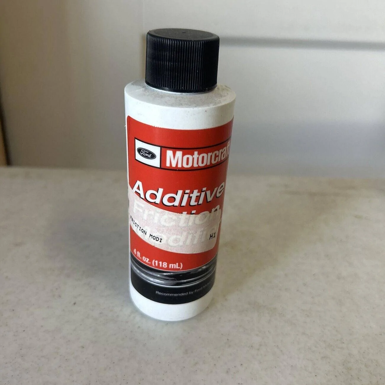

I use the Valvoline 75W90 squeeze pouches. The modifier included seems perfect for the trak lok because it feels the same in operation as it did with the stock fluid.
I also used the Valvoline synthetic AND the Ford modifier even though the Valvolaine says "with modifier " .

Why does the Torsen application use a friction modifier when there are no clutch plates to chatter/grab?
I read somewhere that they can make noise without the modifier. I've put regular gear oil in multiple torsen diffs and never experienced more noise...
https://torsen.com/tbr-lube-friction-modifier/
This begs the question of whether or not friction modifier is actually necessary in a Torsen. Like I said earlier, the modifier is beneficial in smoothing out the operations of friction devices. However, because our friction properties are different than that of a clutch plate differential, you might not see the same symptoms of stick-slip behavior that those would. As noted, clutch plate differentials have a distinct tendency to chatter without friction modifier in the oil, and that chattering can become very objectionable. So, the modifier is essentially a requirement.
In a helical gear diff, however, the stick-slip tends to show up as an audible noise, described by some as a “rusty screw” noise, or as a squeak or moan. You tend to hear it in very low-speed turns, when the steering is at or near full-lock. So, you might hear it while maneuvering in a parking lot, or turning the car around in your driveway. This noise is, as I said, just a characteristic of the friction properties, and is normal. But, if you hear it a lot and it annoys you, adding a few ounces of friction modifier to the axle lubricant will almost always eliminate it. So, the bottom line is it’s up to you.

auto parts stores carry it. It s such a tiny amount (4oz).
