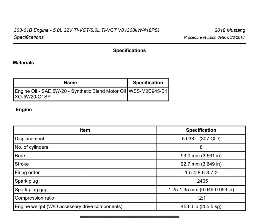

So far from what I know is that the after market oils do not have the new ford WSS- M2C945-B1 specification required for the 2018 and 2019 mustangs stated in the user manual.
My owners manual downloaded from Ford in July, 2018 for my 2018 GT states WSS-M2C945-A.
That's what I showed the guy I spoke with from Ford Performances, he came back to me with a PDF file with the upgraded oil grade. I can send you the PDF file if you want.
Thank you. No its all good I believe it. I did re-check the online manual and it still states the old spec.
