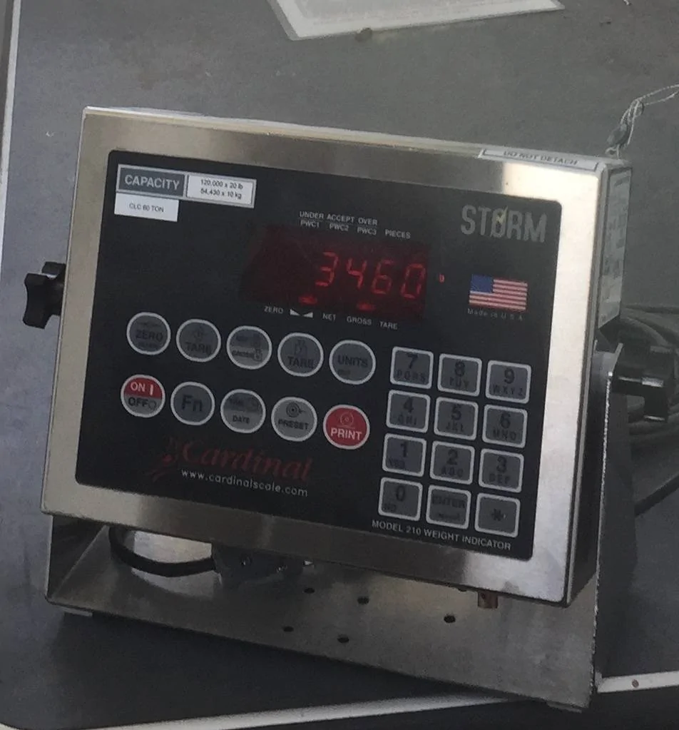

Soon as I get a chance to weigh mine I'll post weight & what I removed to get it there.

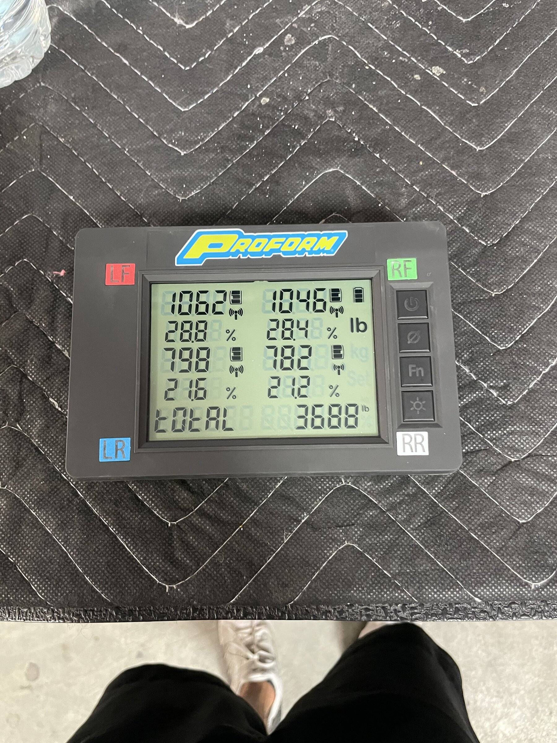

I’m down to 3688 with a half tank. Weight reduction mods are Corbeau FX1 pro seats, Cm components rear seat delete, Billet Specialties Drag Pack, Bear front brakes, and exhaust is dumped after corsa double x. Since weighing it I have also removed the front sway bar and have my Steeda drag k member ready to install. The TT system seemed to have made the car a bit front heavy so I’m hoping the k member evens the car out a bit. 301A pp1 car

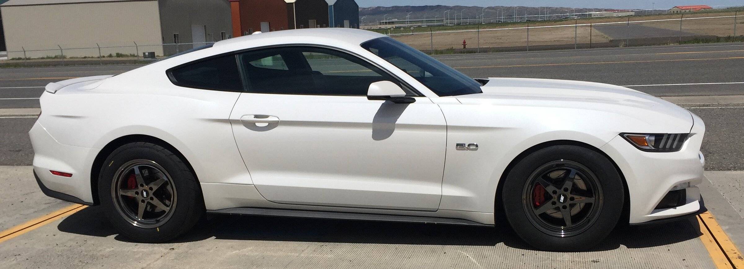

My weight reducers: rear seat delete, tire repair kit & wheel well cover removed, head rests & floor mats removed, JMS drag pack w/drag radials & 4.5 inch skinnies, Baer brakes & rotors all around, front sway bar, windshield wipers & wiper fluid removed, exhaust system removed. Factory coil-overs removed & added Viking coil-overs, Cuthroat cut-outs behind cats, Ford Power Pack3. Thinkin' that's it, possibly could have forgotten something though.
12 June is our first race date so curious as to what it'll do!

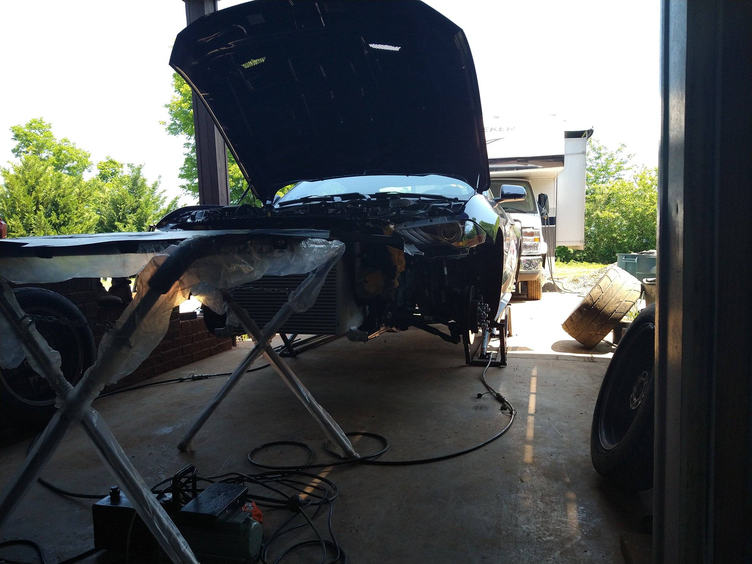

I've removed some weight from the front of my Mustang. Bumper being the most heavy. But I still weigh in at 3865! My required (NMRA) weight is 3600 pounds, so I need to drop 265 lbs, which is equal to 12 to 13 horsepower for my setup.
