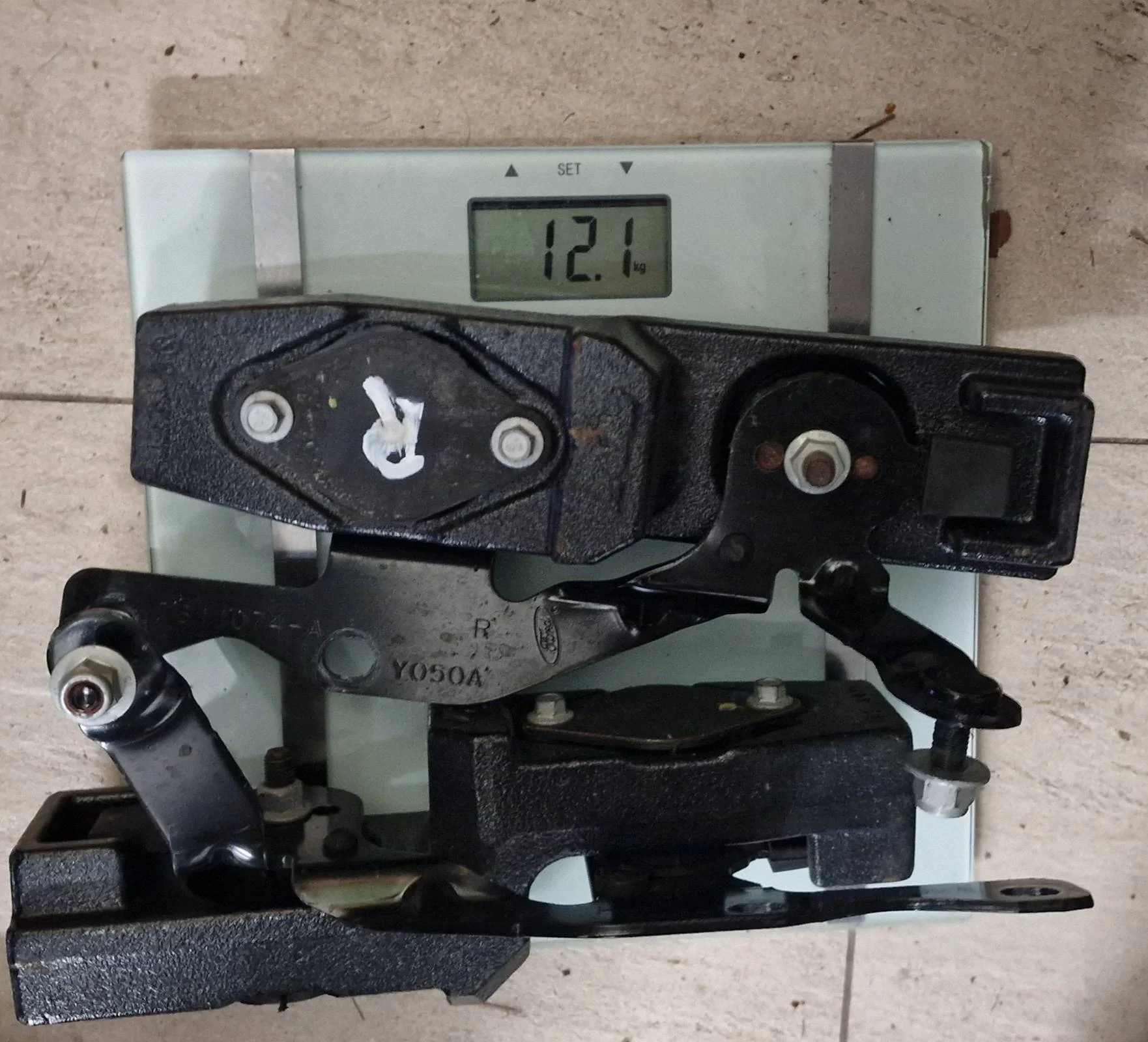

Yes, I have a convertible with automatic. The two weights are under both fenders in front of the A-pillar. And can be removed with three screws

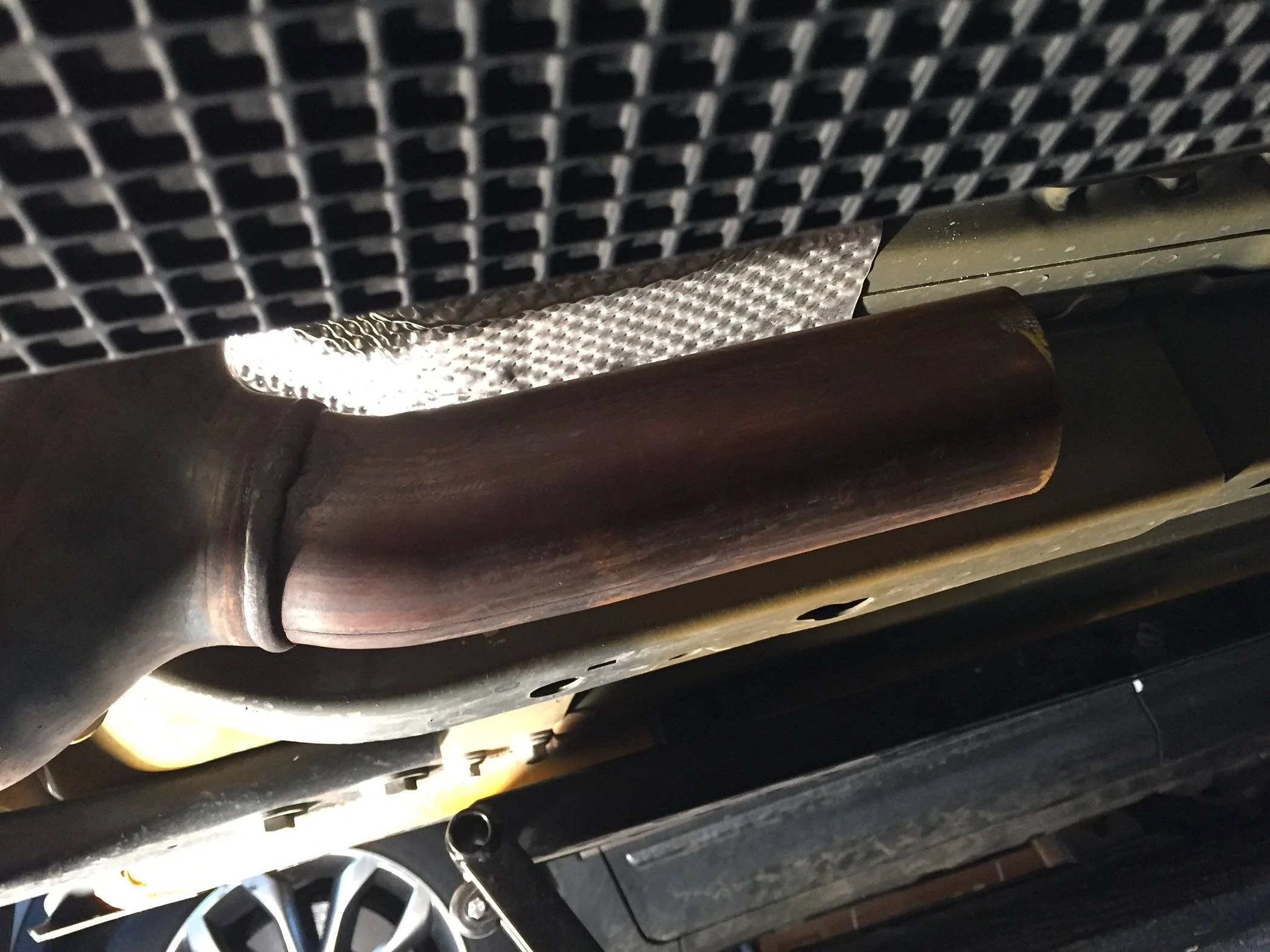

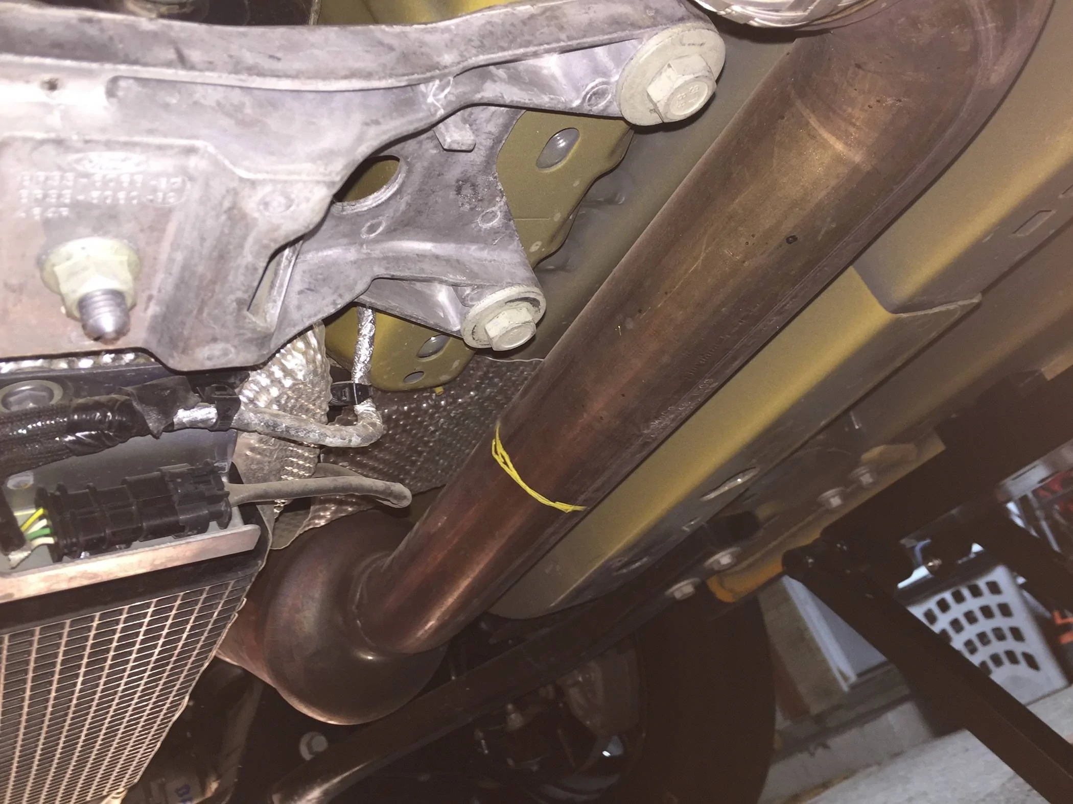

How do you like the cut outs? I’m having long tube headers and high flow cats installed next week and was thinking about getting a set installed at the same time. Just want to know how you like them.
I had those cut outs on my '17, left 'em on when I sold the car. Definitely liked them and it's a great idea but since I rarely drive my car on the street I just cut mine current exhaust system as pictured. Removing the resonator & active exhaust saved about 80-85 lbs. Car runs 11.8s @118-120 mph through the cats in bad air; typical DA is 6000+, on an E85R tune.

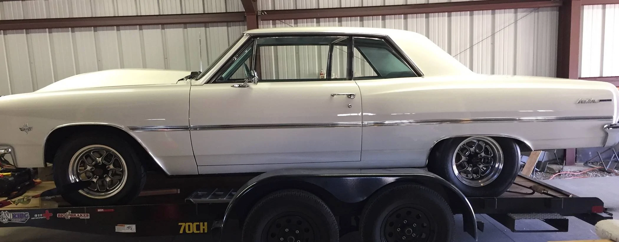

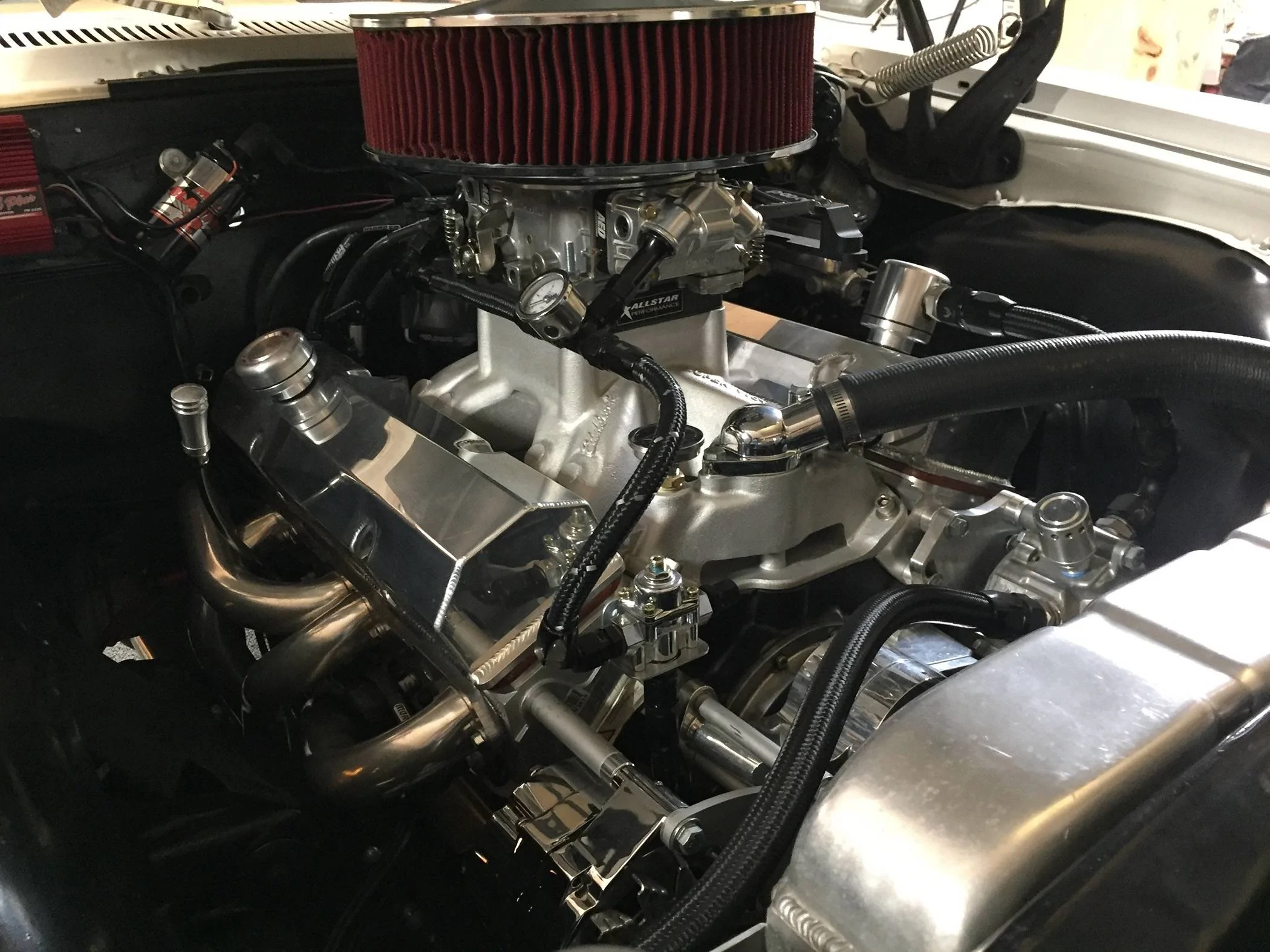

How much power are you making?
Dunno for certain - Juggernaut E85R tune is only real mod. Car weighs 3440 lbs with about 1/3 tank of fuel. Only have 2800 miles on it so just now getting broken in! Ain't makin' as much as this bad jackson:
Whats happen with the weigths under the front fender? 12.1 kg = 25 ibs
Where did you find these weights at? Is your car a convertible?
Those are vibration dampeners. They reduce body NVH generated at certain frequencies. I’d be curious to know/understand the difference in ride quality with them removed.

Tomeck
Jan 31, 2021
42
Germany, Carlsberg
Thomas
Mustang GT
I now drive with my Mustang for a year and a half without these weights. I haven't noticed anything negative yet. Not even at a speed beyond 280 km/h. However, I have installed all possible upgrades from Steeda and BMR as well as the one-piece carbon driveshaft from QA1. The NHV is very high anyway.
