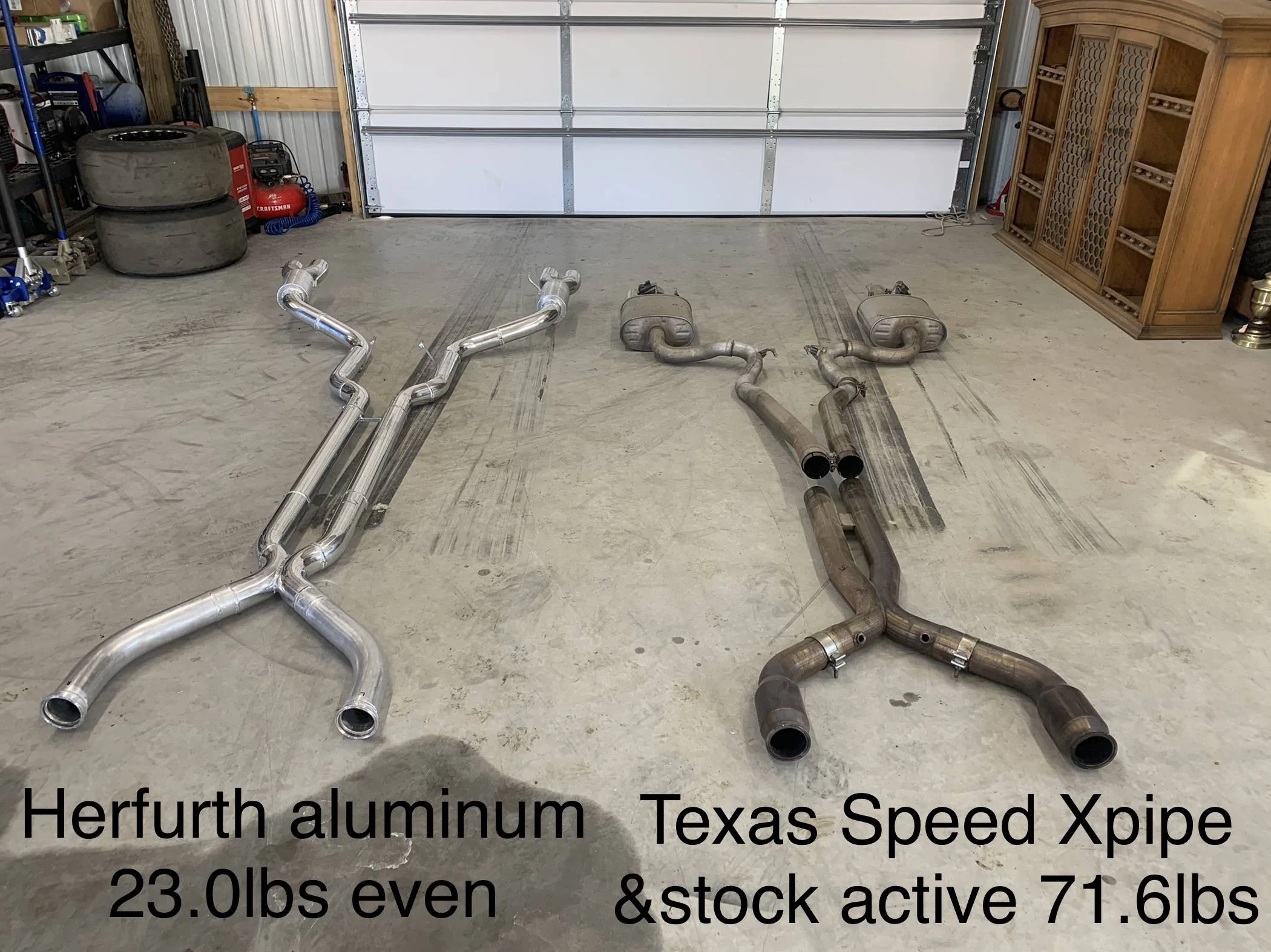

I managed to lose almost 50lbs going to a fully aluminum exhaust, so there's creative ways out there and every pound adds up.
