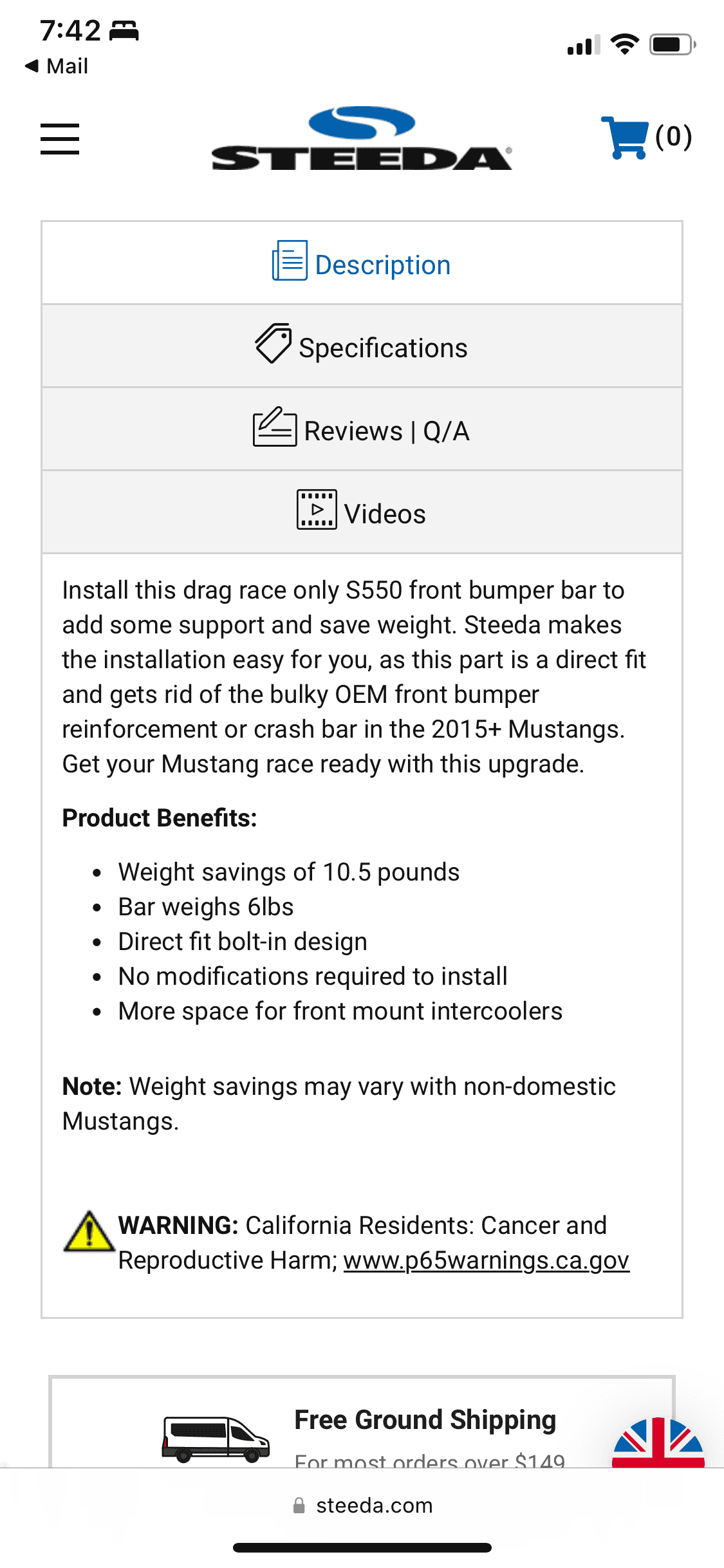

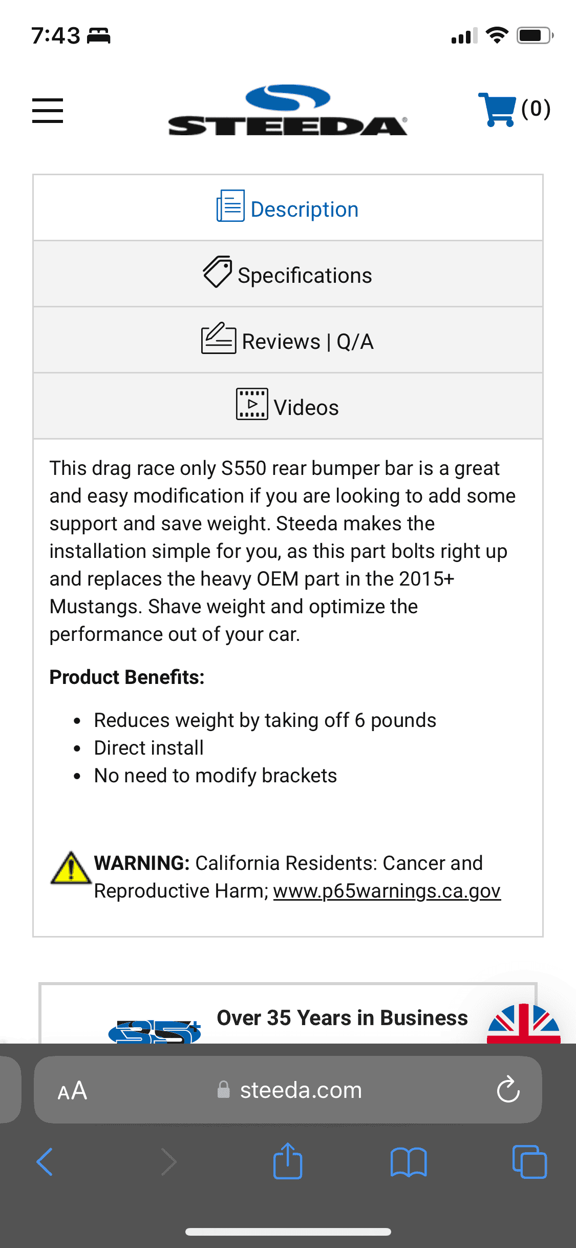

How much lighter is the aftermarket front & rear crash bars over the stockers?
I'm partial to the swiss cheese hole saw or dimple die hole lightning of oem already paid for parts unless to get to the a/m part weight takes more work than cost to buy the a/m part.

16.5 lbs :
I had been think of these parts myself, if for nothing else but to get rid of the OE bars that rust for fun …

16.5 lbs :
WD :like:
Too easy to paint the oem part to stop the rust?
Something told me your initial question would lead to another ... :like:
The OE part (hidden on a pre facelift / visible on a facelift) has an unsealed / unprotected seam on its top face just behind the grill, which catches any dampness coming through the grill quite nicely.
Corrosion starts working outwards from the seam and because of that, I'm not sure it could ever be truly fixed once it's already started.
I guess a good fix would be a flat back, some rust killer deep into the seam, some seam sealer over the top and then some paint - but the cost of that work (and the time the car was off the road with the front cover off) would start to add up.
At that point I figured a replacement lightweight bar is probably a good alternative.
Same story with the back one but I think that one catches run off from the tail lights that then settles on the top face. Get under your car and look upwards directly above the tailpipes - you will likely see a mint body shell and an aging bumper bar ...
When you consider the replacement bars there are a few advantages (for me) - They are an easy shape to obtain a quality finish (so they should be long lasting), they are a quick fit / turnaround solution, they save some weight, the front one adds some space for potential future mods (intercooler), and the front one also offers a clean look behind the grill (the main thing that's pissing me off at the moment).
Don't think I've just been unlucky with mine starting to rust - although it's defo highlighted by light paint colors, I've seen corrosion on plenty of rebuild / modification threads on here and when you know where to look, I've also seen it on brand new cars still on the forecourt (but stored outside) ...
Judging by the front chassis legs, I think the bumper bars are unfitted for the initial shell prep and paint, then they are bolted on before the colour coat, i.e. they only get a minimal coating of paint (at best), on top of 'poor' initial prep ...
