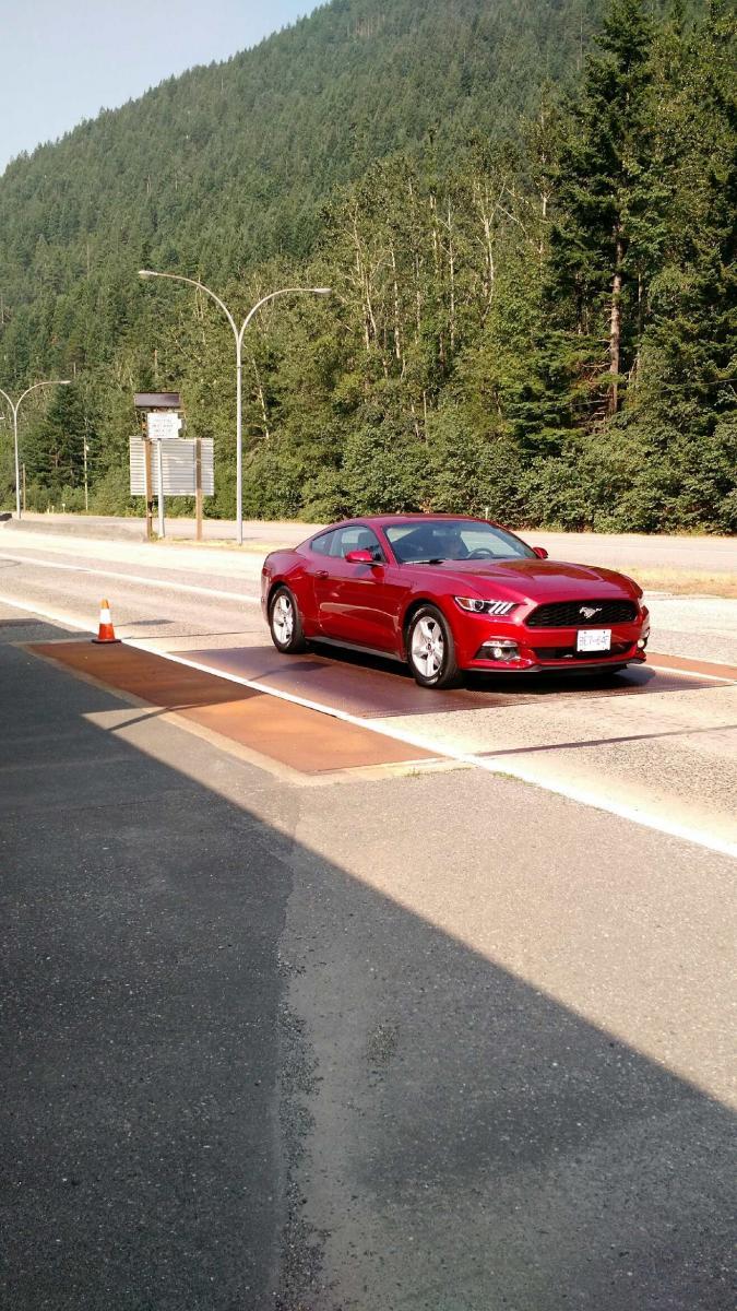

1cobra
Feb 18, 2014
Chilliwack,BC
2015 Ruby Red Mustang automatic
I have the base 17 x 7.5" wheels, the ecoboost is about 80 lbs lighter than the PP eco even according to Fords figures.
Mine weighed 3,482 with 1/2 tank of gas on certified scale.
p
