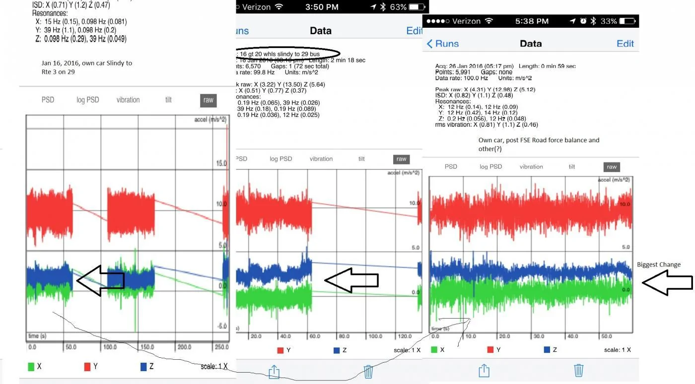

Your reply to this thread is interesting by the use of the app you tried out to record the vibes.
I'm wondering if you have time to repeat that test again, but place the phone in the following locations:
1) Inside center console so that phone is completely flat against bottom of console. Logic: The center console is directly above the trans/driveshaft tunnel. The (2) piece driveshaft has a center bearing or "guibo", thus chances for monitoring vibes may be greater in this location than at dash or steering wheel.
2) Inside trunk - either by placing inside spare tire well (which is directly over rear differential or placed on top of trunk carpet.
3) On L or R rear floor pan.
I would suspect that 1 of the 3 locations above may produce better and more accurate results since those locations are closest to the driveline (driveshaft, rear differential, rear wheels and rear axles).
I will give these a try next -- I took the readings below before I read this.
The FSE came out and found 2 or 3 tires (haven't got the official report yet) needed to be adjusted on the road force balance (3rd time including having replaced two tires). In fairness to the FSE, he put the NVH tester on and even reported that my aftermarket license plate bracket was vibrating. Now that I got "fair" out of the way, he also said that any remaining vibration is within spec of a convertible. Since I just noticed a couple posts about rotating the driveshaft 180, I am going to give that a shot or find someone in Northern VA who can index or balance my driveshaft.
Anyway, below are the updated vibe samples taken from my steering wheel. There is a very significant difference in the raw vibe data from having done the road force balance. It is nearly identical to the GT hardtop now (from the steering wheel), so by using one of the 3 locations suggested above I will try the same thing as I play around with the driveshaft. Please note that with this pic, I adjusted the aspect ratio of the screen shots so the scales lined up.
