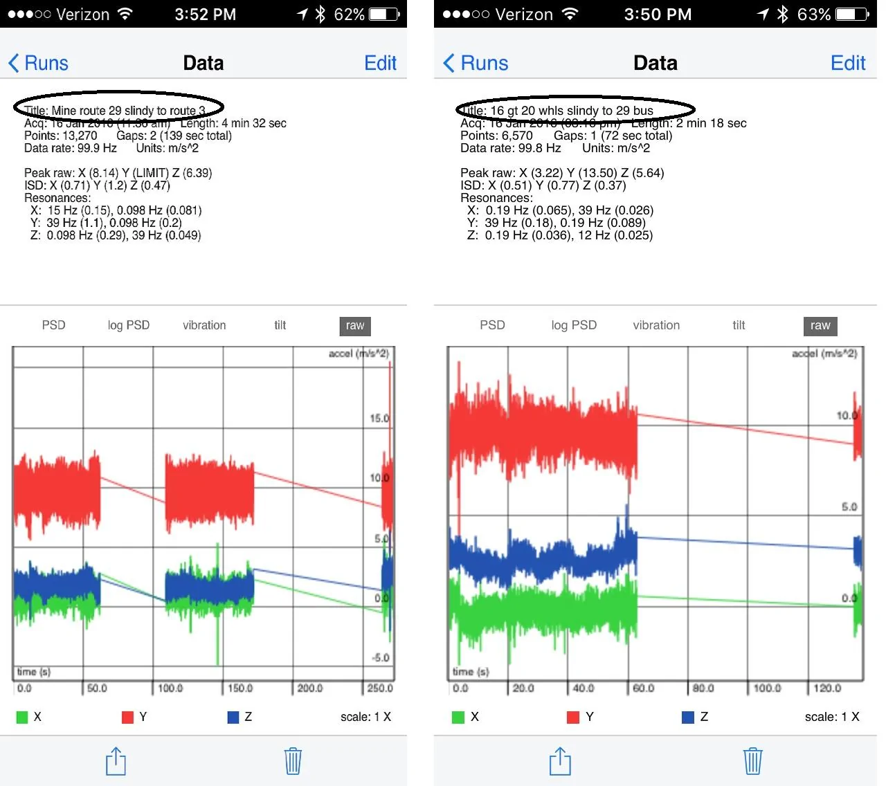

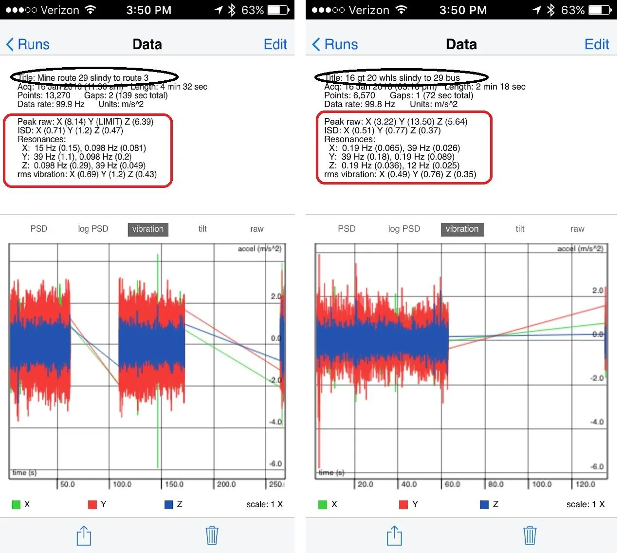

A FSE is on his way to check out mine, so on Jan 26 I should know whether mine is fixable or not. I finally got around to putting a vibe meter on (there's an app for everything!), and compared mine to a different Mustang. The SM at the dealer cautioned me that the road in front of the dealer was usually not good to do the tests on. I tried it and another road. Interestingly, the dealer car (16 GT FB with 20's and A/T) was night and day better than my 15 V6 convertible with 18's. No one has a convertible nearby, but based on the poll/survey in this thread I am willing to bet that another convertible would be equally different. I've posted the output from the vibe meter held to the top of my steering wheel during the drive at 59 mph with cruise control.

Steering wheel vibes do not apply to this thread IMO. There has to be a better location for driveline vibes.
I agree that there are better places to measure the vibration from, and I also feel it through the seat and elsewhere. The steering wheel was simply the best place to hold my iPhone against to take measurements. Obviously, I could spring $300 or so for a vibration measurement kit, but was primarily looking to simply compare two different cars.
