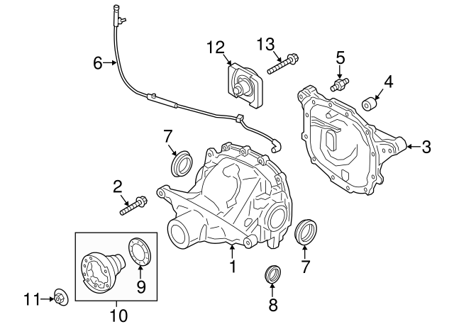

The link below from Post #3469 shows the damper for the 2015-2017 Mustangs. Scroll down to the bottom of the page to see what Mustangs it fits - which shows all models from 2015-2017.
So why is Ford showing this damper fits 2015-2017 Mustangs if not all of them came with this part from the factory? That's why I'm wondering if it's part of some "fix" Ford has come up with along the way.
https://parts.levittownfordparts.com/oem-parts/ford-damper-fr3z4a263a
Number 12 is the damper weight, and number 13 is the longer subframe mounting bolt.
