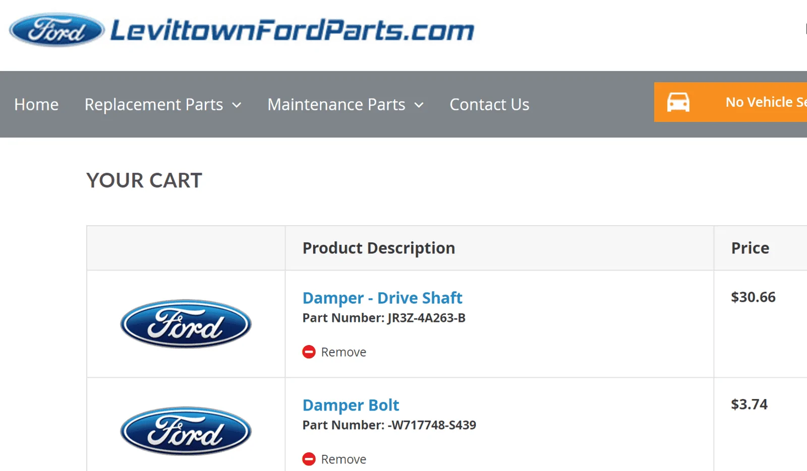

I reached out to Benny at Levittown Ford, and, together with your photo, his research identified the damper and bolt. Seems cheap enough for someone to try this as an experiment on their 15-17.
I notice on Amazon that they have the BR3Z-4A263-B damper and bolt included. I wonder how much different this part is compared to the JR3Z? Where is this installed on the differential? I'll give this a try.
See the photos in post# 3446. It is the right rear bolt that is longer to accommodate the damper.

I went ahead and purchased the JR3Z-4A263-B damper and bolt. I'll give it a try.

I wonder what is the difference between the jr3z-4a263-b used on the 18,s
the the https://parts.levittownfordparts.com/oem-parts/ford-damper-fr3z4a263a
used on 15-17
Yep, those are two different part numbers. The FR3Z is for the 15-17 models - but it would be interesting to see if the JR3Z works better on the 15-17 models. Did the subframe damper even come on all 15-17s? The talk in this post makes it sound like there was no damper piece on @CNCLester's 2017 S550 that he was comparing to his 2018.
https://www.mustang6g.com/forums/threads/vibration-between-50-70-mph.15990/page-173#post-2261173
Update - I just looked under my 2015 GT and it does not have any damper bolted to the subframe. Looks like the big metal damper piece would nest into the inside of the differential's big rubber insert used on the big subframe bolt.

My 17 GT doesn't have the damper either, of course, that's why I ordered one to give it a try.
