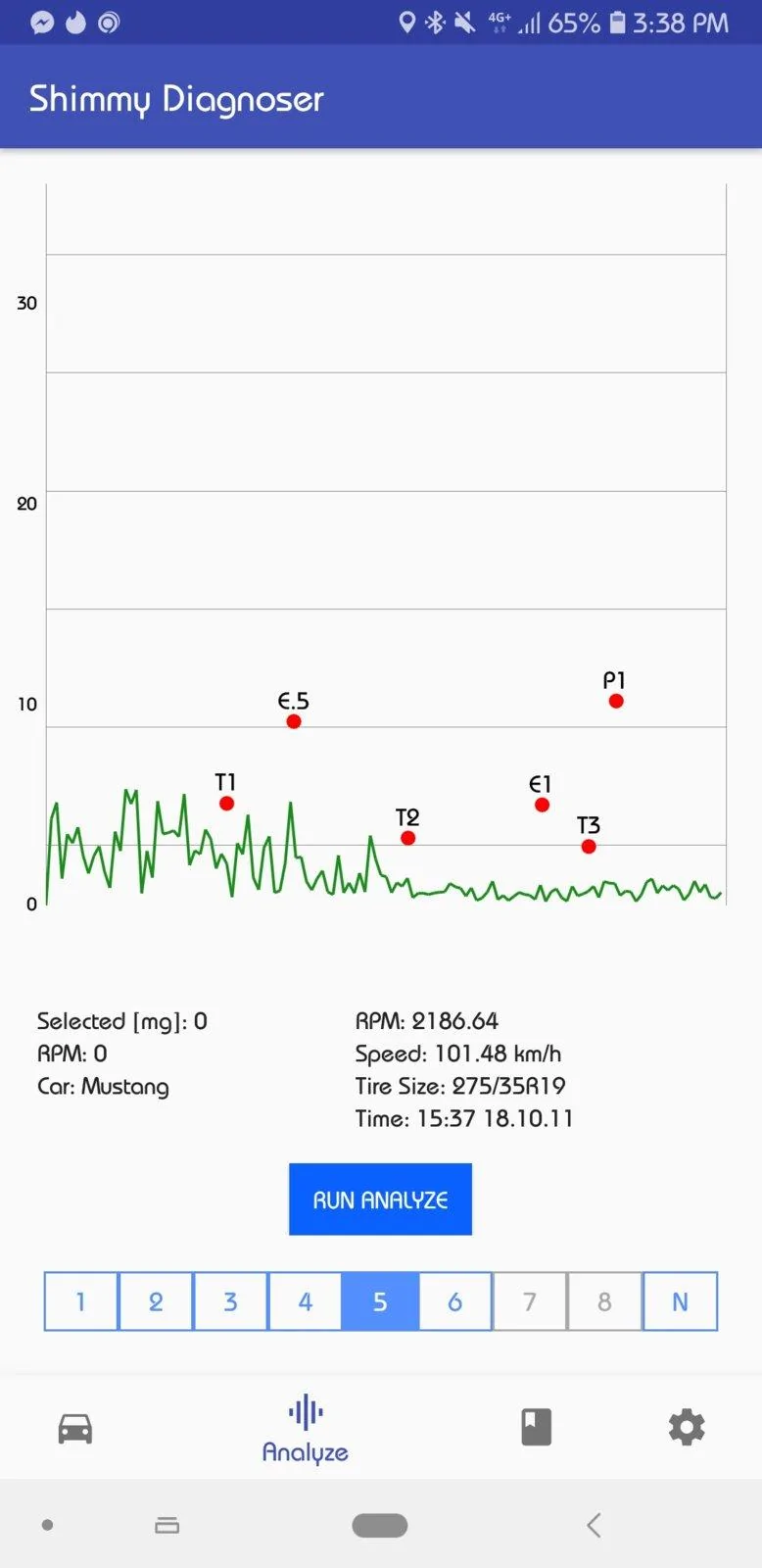

For anyone that doesn't wanna pay $20 for Shimmy Diagnoser app...here it is for Android:
I tried it and I don't know how accurate it is

I bought the app and never used it. kept forgetting. my DS should be here this week, has to come ground and aparently the warehouse is moving at the same time. Is there any library that tells us what frequency is relative to what problem. They used the ford nvh machine on mine and it came up driveshaft. we shall see.
The app will show you codes on the graph, you can look the codes up here:
http://woliemotorsports.com/helpBookAndroid.html#E0_5
