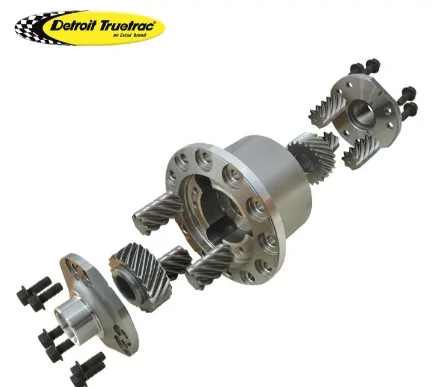

As for the Galaxie, you can install a Eaton /Detroit TruTrac in that 9", & it will operate very well.
They produce a 50%/50% torque bias, per axle, when engaged.
TracLocs are barely 60%/40% at best.
As the clutch plates wear, that bias diminishes.
Clutch style units like Ford TracLoc's are harsh without Friction Modifier additive in most vehicles, so we assume you had it in your F150 that wore out in 20k mi.
If not, it will wear the clutches out quicker than if you use the additive. Most cannot stand the characteristics of using one w/o it. So again we assume you did so.
I was using Royal Purple MaxGear which contains the friction modifier and they advised that I do not add the additional Motorcraft friction modifier. It wasn't nearly as aggressive as this Torsen diff seems.
