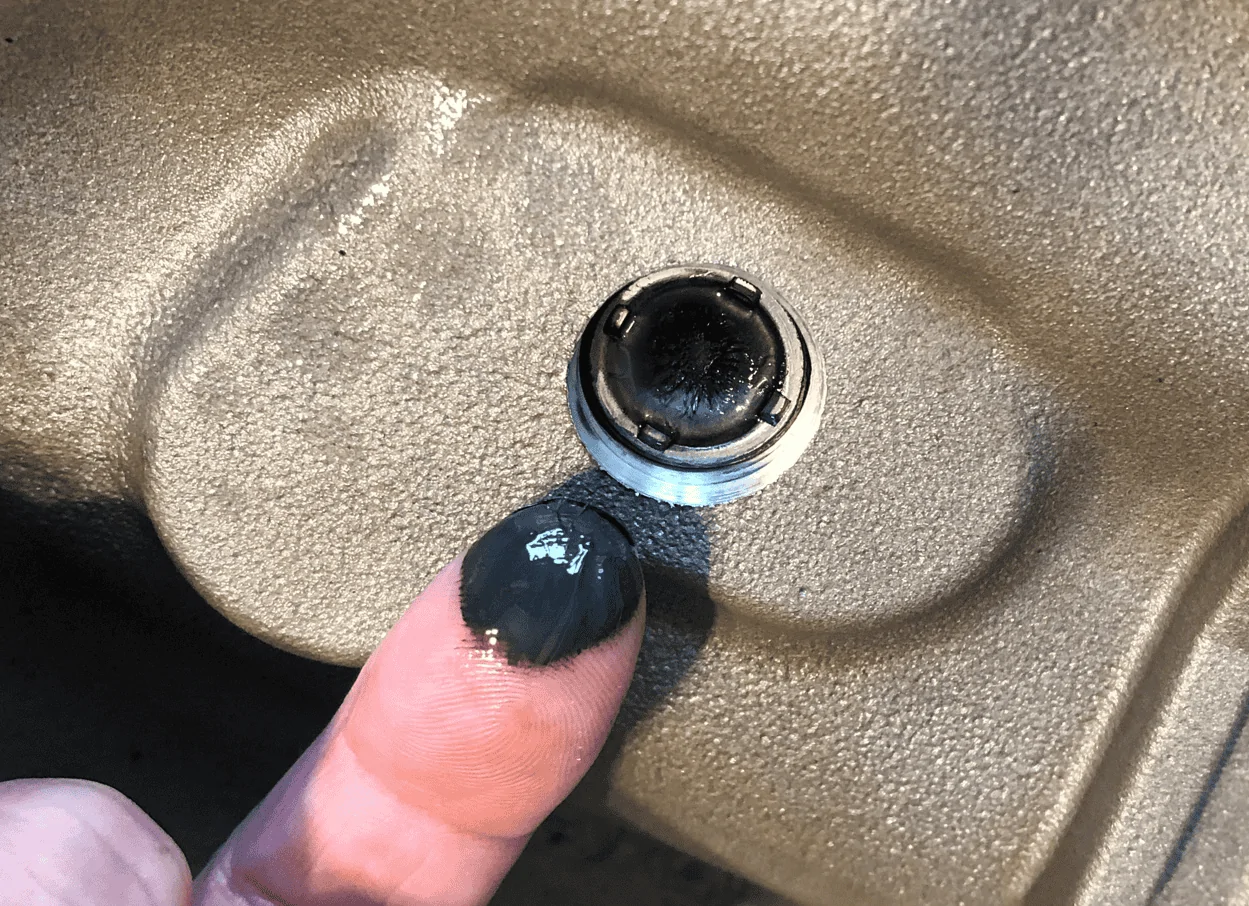

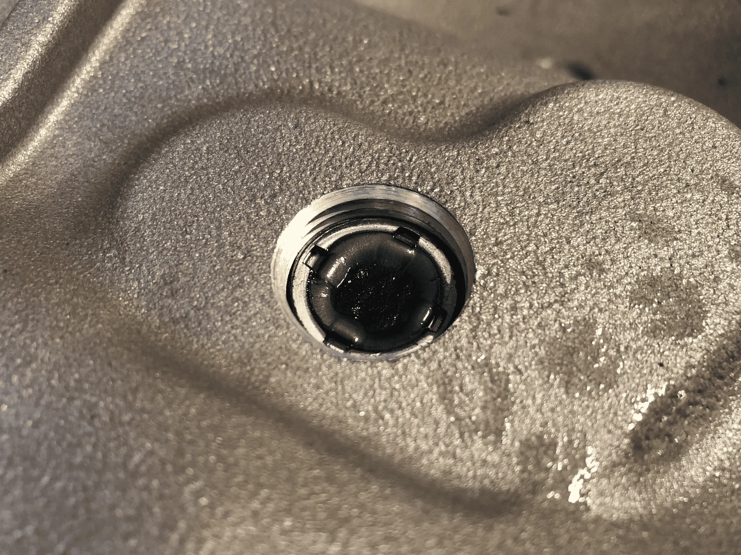

and there was a surprising amount of clutch dust on the magnets.
Does that look like black sludge ?
WD :like:
Yup, it's very fine though.
I had some of that on them then even at 2.5k ...
This has been off the off the car for about a year now, the magnets had been removed, loosely wiped over (not cleaned properly) and then the cover had been wrapped and stored. You can still see that residue in the dimple on the magnet :
When I acquired the cover, the fill magnet (which hadn't been removed) was full and almost level with the recess on the cover.
Its grey / black, feels almost like CV grease, and doesn't want to come out from under my nail ... :facepalm: :giggle:
It must have some metallic properties as it's only on the magnets when the rest of the internal cover is very clean.

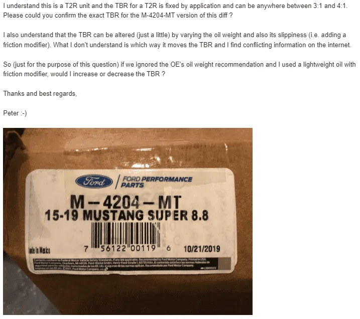

The torsen has a higher TBR, 2.5:1 if I remember correctly. The Trak-Loc is something less than 2? For sure, the torsen locks more and is the one to have.
I've contacted them (twice) about TBR but got no response :

If you remember Brian, those numbers were his. I think the 'normal' torsen was 2.5 and there was a competition version which was around 3.
