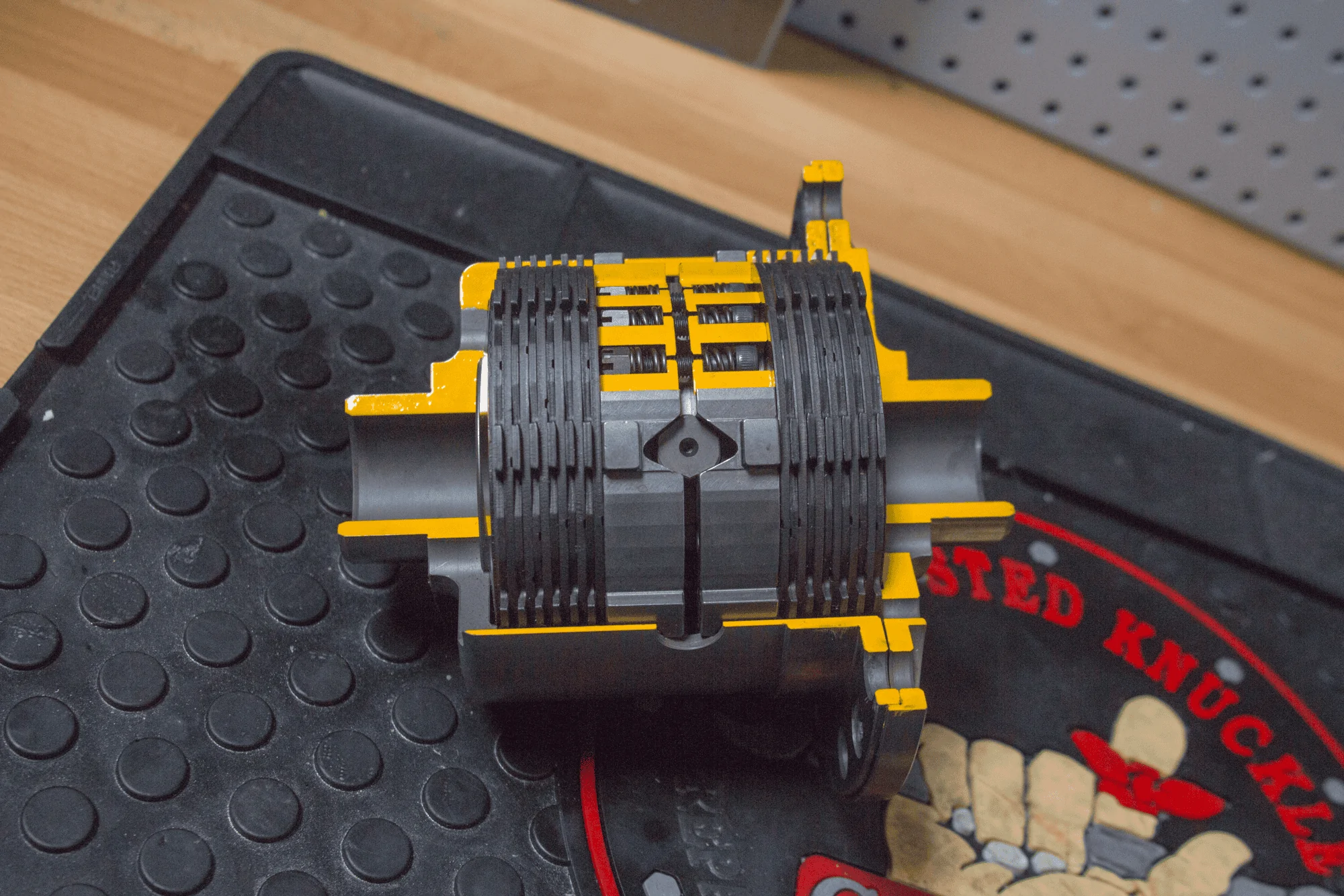

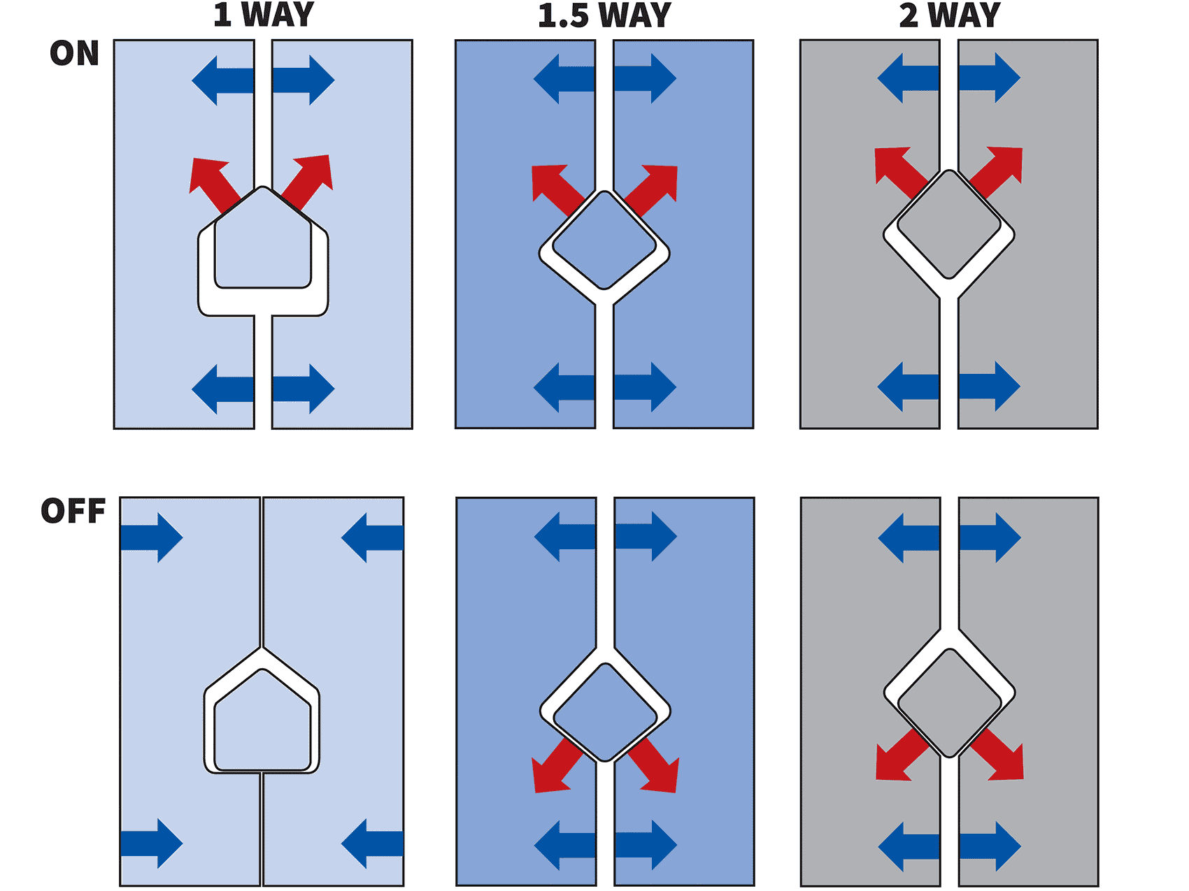

Most clutch-type limited-slip differentials have the clutches engaged, by default, and it takes a certain amount of torque to break them loose. The way they work is exactly what makes them wear items.
The exception I know of is the OS Giken SuperLock. It's a 1.5-way limited-slip in which the clutches are disengaged, and torque mashes them together.
The "1.5-way" part means that engine torque in one direction or braking torque in the other direction can both squeeze the clutches together, but braking squeezes them about half as hard. I have it in my Nissan 240SX partly because I couldn't find a Torsen for that car's rear-end. There were a bunch of other clutch types available for my car, I picked the OS Giken, and years later I think the OS was absolutely worth the $1600.
Here's a cutaway that shows the insides:
It has angled studs on the middle assembly, and when the engine turns the input shaft the studs press into the plates on either side, and press the clutch packs against the inside of the housing.
It gets a lesser effect under braking by having the studs and the matching faces at a shallower angle, so it doesn't transmit as much force out to the sides.
It is available for a Ford 8.8" IRS.
My GT-PP1 came with a Torsen, and I like that so far. ...But if I had some other car with an open diff, or I just wore out a clutch-type LSD, I'd definitely consider buying another OS Giken.
