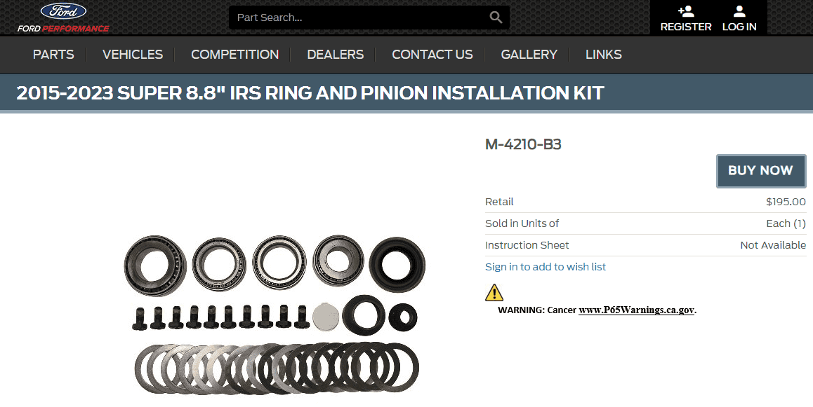

How hard is it to replace the factory Trac-lok with a Torsen, assuming you don't intend to change anything else (i.e. keep the same final ratio and all)? Is it a straight, plug & play fit? Just open up the differential housing, take out the old diff, insert the new one, the end? Or is it more involved than that? What parts would be needed besides the differential itself?
There is a fitting / rebuild kit (that contains shims and the crush sleeve) :
I'm not sure it could be done without that as the exact tolerance of the carrier couldn't be guaranteed from one unit to another (therefore affecting the gear meshing).

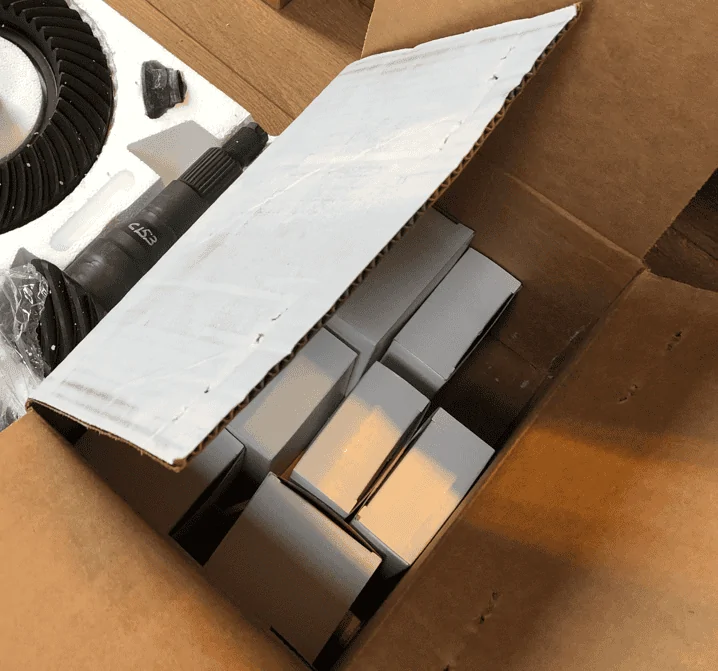

Where can I get this kit from? Does Ford sell it? Do you happen to have a part number?
You might be able to get this stuff separately, but this is what I got :
