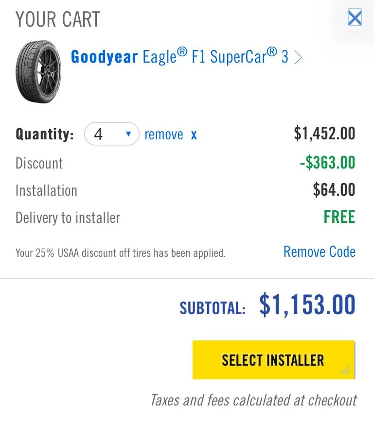

Per the footnotes it appears the tires have to be purchased from GY.com and installed at a GY tire store or independent "authorized" dealer rather than "just any" independent installer. Has anyone tried an installer such as Discount Tire and if so did you get "free shipping"? I haven't joined USAA so far but am a vet so I can do so if needed. Since I'm not a member I cannot "walk through" the process to see what the options are for installers and free delivery. FYI my application would be a stock (FS) autocross 2018 Mustang GT PP1 which gets driven to/from events. It appears the SC3's are not quite as quick as the Falken RT-660's or now available Yok A052's but might have other advantages such as not "aging out" if I don't wear them out in one season of occasional autocrosses.
you BUY them thru GY.com. And they will ship to a GY branded or affiliated tire shop. You then march in and pick up your loose tires and do as you see fit. You will not get the $60 install fee back but who cares...
