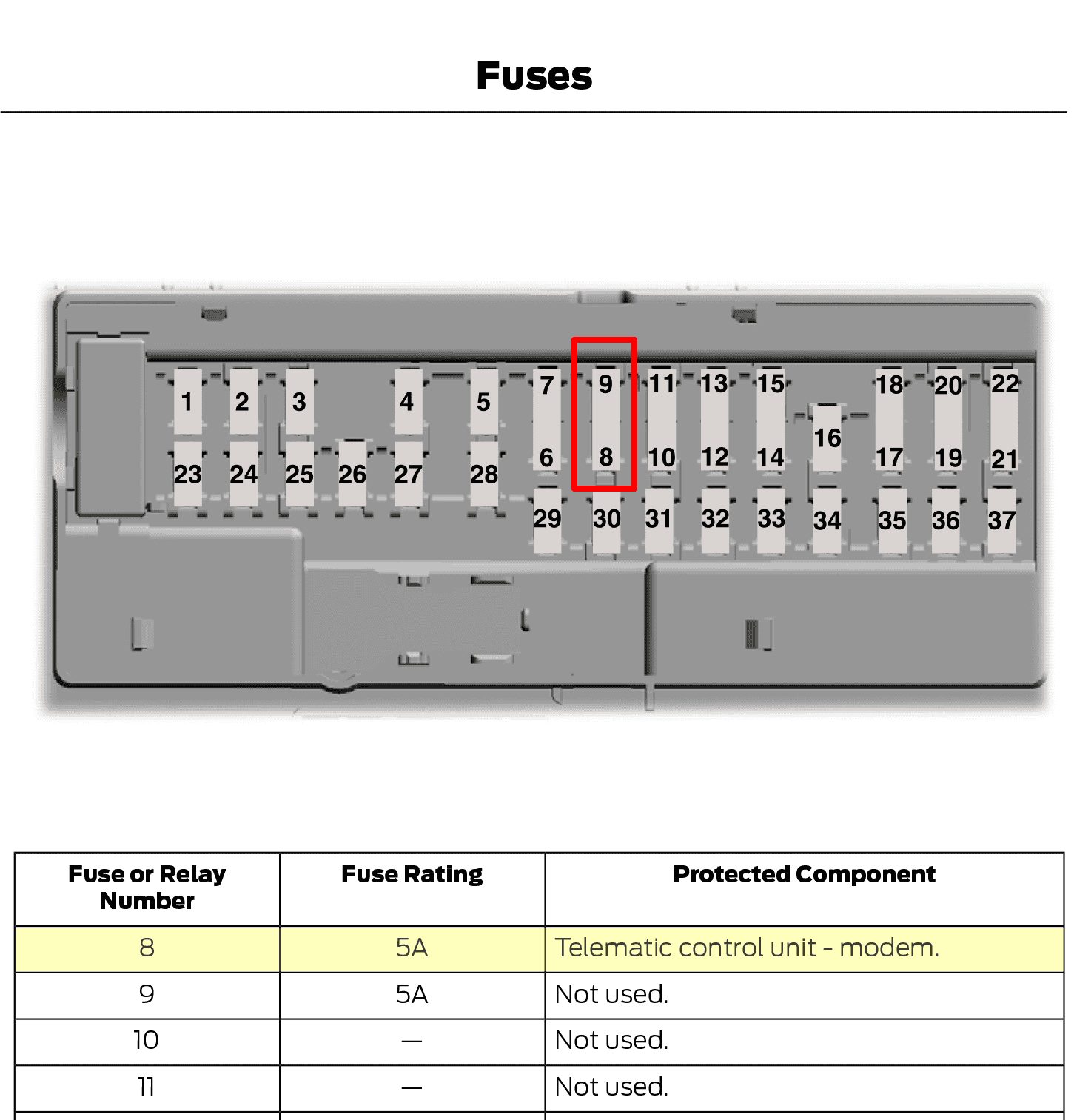

I’m not sure if it’s anywhere in these 31 pages but can you please remind me which fuse you pulled KB?
It varies by year, but it has consistently thus far been a 5A fuse labeled telematics.

Brett: The info is on pages 230-231 in the Mustang manual. I combined the pertinent graphics into one image. The panel is the passenger side under the kick panel and the fuse you want is #8.
