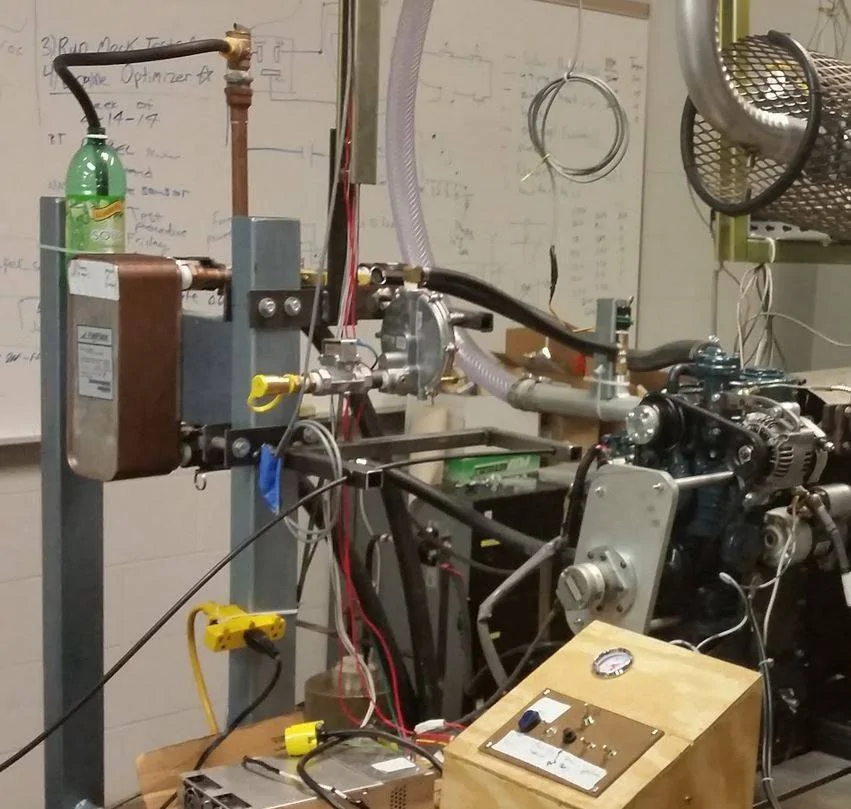

it seems frontal air space is at a premium. Has anyone investigated using a oil to water plate heat exchanger with a remote radiator? This creates two seperate circuits where you would still use a sandwich plate to get oil from the engine, but the water radiator could be mounted in the trunk with a fan/pump. You could probably get away with a rad similar size as if you had one for a diff cooler. My only concern would be condensation from the cooler water getting into the oil. I have used this plate method for coolant to water on a project before and it only required a trickle of water to pass through to keep the engine coolant at a stable temp.
yes, Camaro 6G SS/1LE and now the Mach1. :)
Trunk air is vastly cooler than boiling water but since the reservoirs are so small and closely coupled you hit heat saturation. We just need to figure out how to get the water coolant down to say 120-150F before it hits the oil cooler and engine on it's return trip. :) How many BTUs is that?
Hmm, could we marry a 2nd radiator to the underside of RaceLouvers? quick-connect hoses and mounted on stand-offs? Engine bay air is hot though but maybe we can duct some ala Mopar Shaker-hood mouldings?
