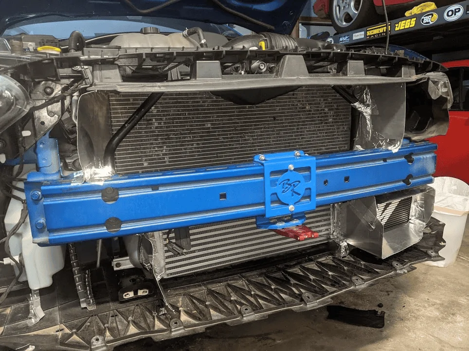

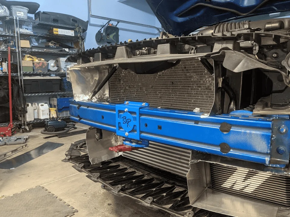

OK, after seeing/reading more stuff in this thread, I've made a few changes. First, I swapped out the massive intercooler for a more reasonably sized one (Mishi clone). Second, I relocated the oil cooler from in front of the radiator to its own location alongside the intercooler opening, cut the lower valence open to provide airflow to it. Third, boxed everything in, hopefully forcing more air through the rad, intercooler, and oil cooler. I have some track time tonight, fingers crossed!

I think it helped. Coolant temps stayed right around 220 and oil never exceeded 260. Ambient temps in upper 70s. That's about a 20 deg improvement for both. We'll see how it goes as the ambient temps rise over the summer.

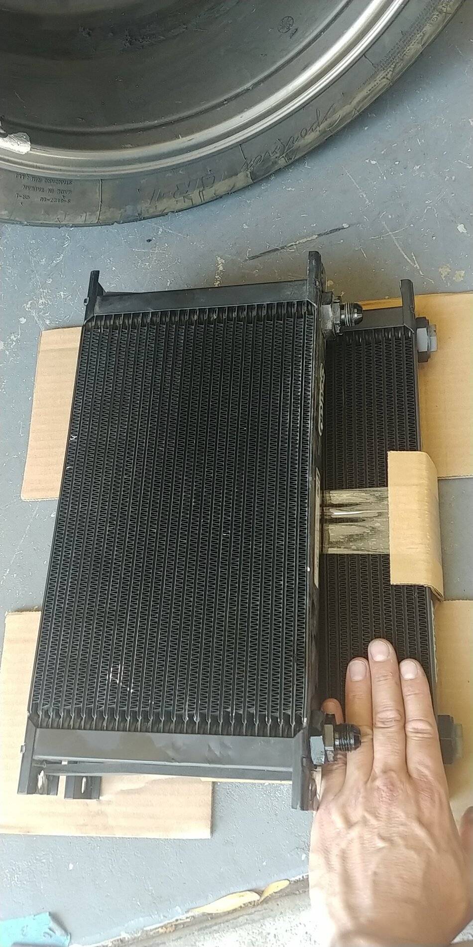

Passing from a 925 setrab trans cooler to a 938. 3" longer.
We will see if is better

Do you guys think that orientation ofnthe cooler is not important? What if i mount them vertical vs orizontal (so longer side running vertical )?

I would not think so. I figure which ever way catches the most efficient air flow. But I have been known to be wrong a time or two in my life.
