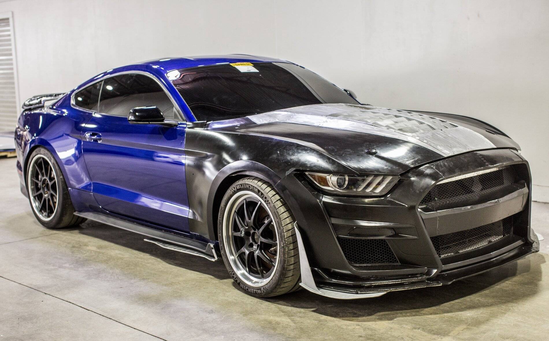

Hmm, could we marry a 2nd radiator to the underside of RaceLouvers? quick-connect hoses and mounted on stand-offs? Engine bay air is hot though but maybe we can duct some ala Mopar Shaker-hood mouldings?
The best solution is to substitute the front fascia with a 350 or gt500 replica. I'm trying to push a company to do the mach1 fascia(better shape on a gt)
So the you can have side pockets. In one you put a trans cooler in the other you go with second oil cooler.
And suddenly the radiator get fresh air.

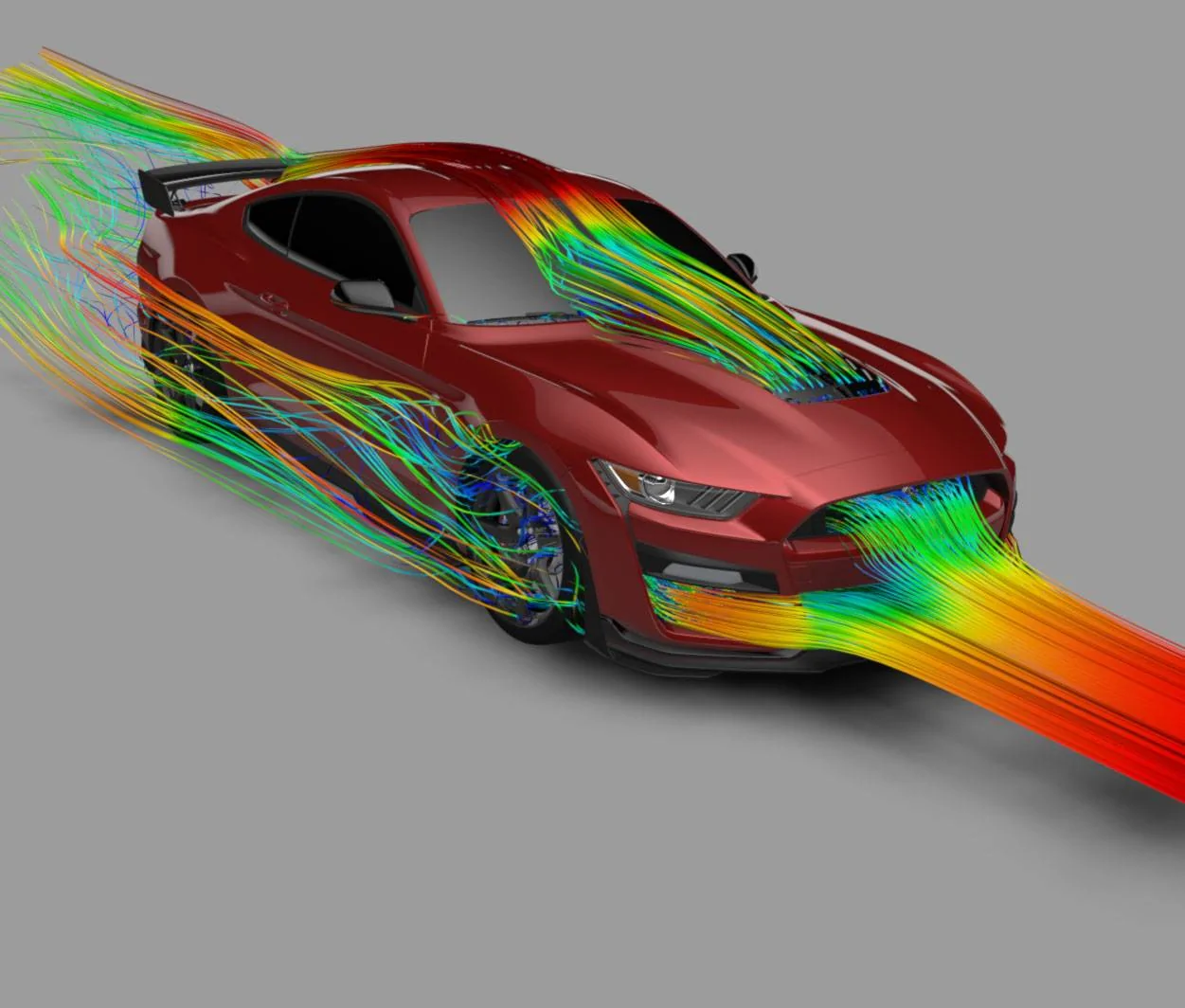

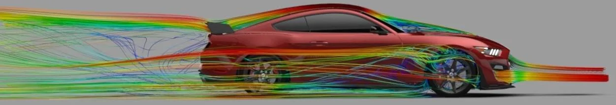

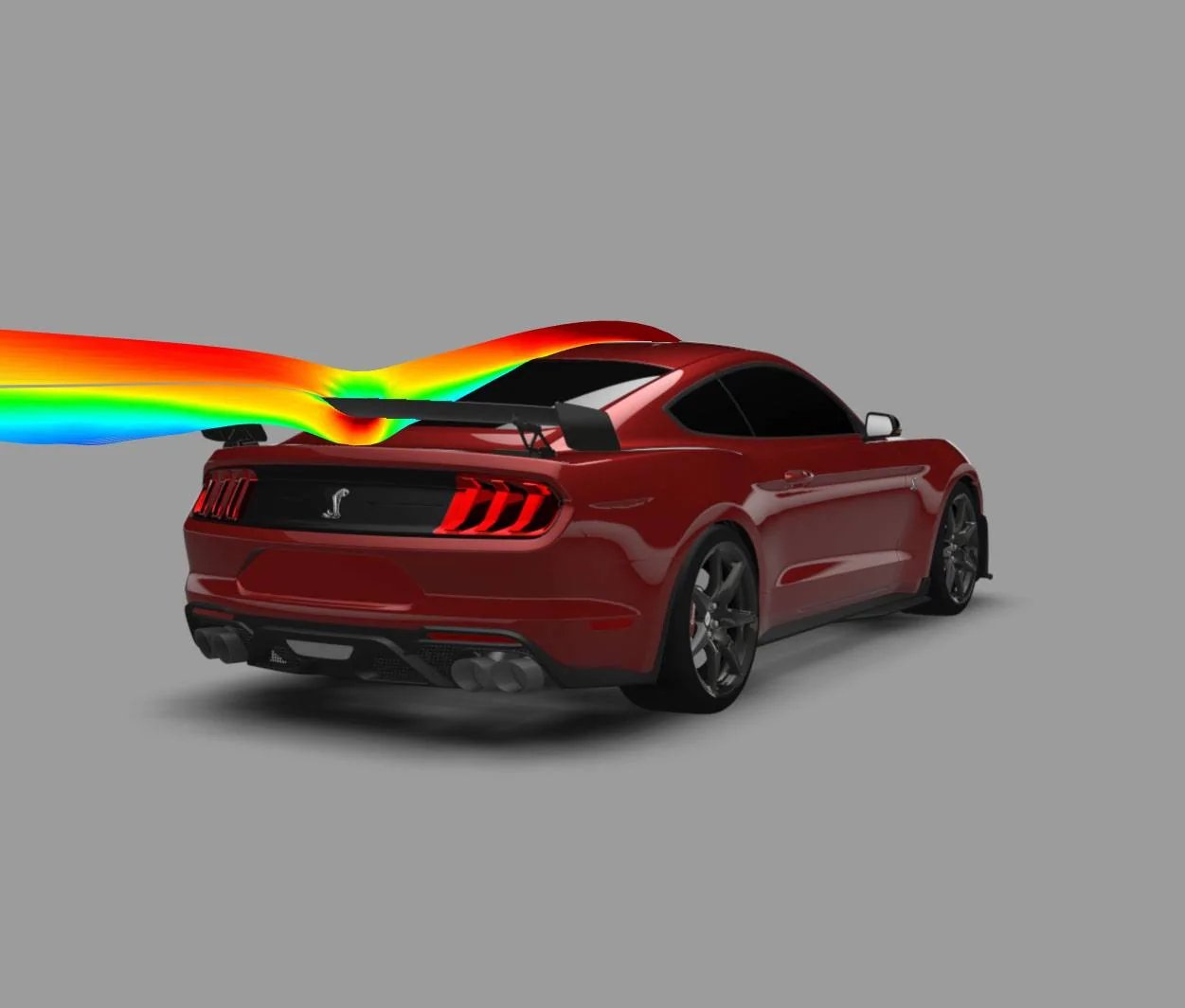

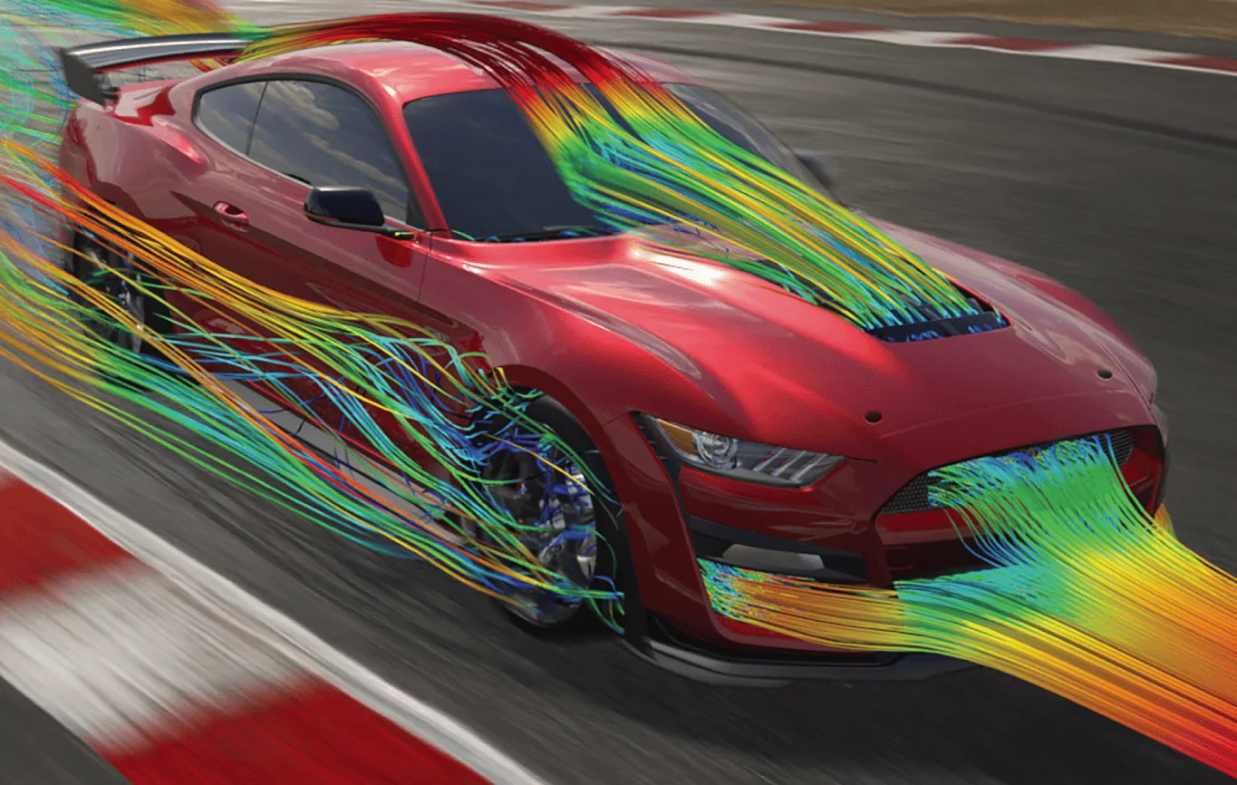

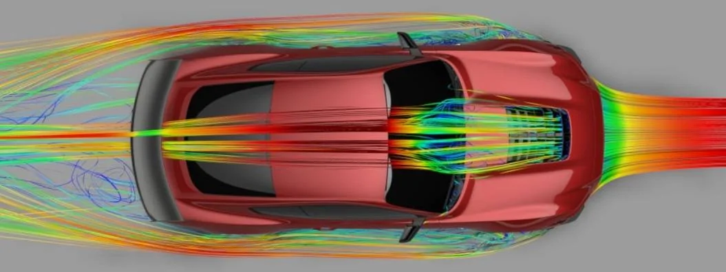

Get some blue tape and yarn and tell me what you see at 0 - 150...
Grab a beer and see what you notice in these picks.
Is that a built in gurney at the back of the hood?..
Is each vent of center hood function like a gurney to generate vacuum behind it?
Beer#2: are colors relative velocity or pressure?
