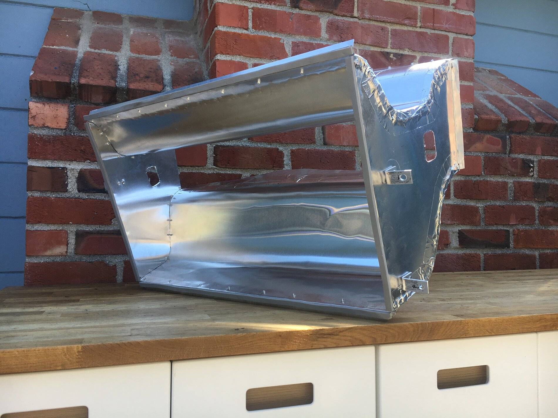

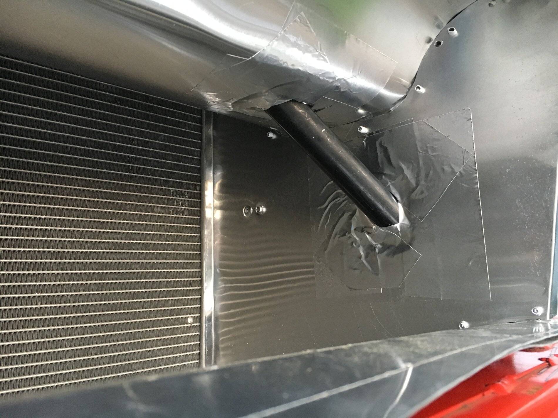

I also vented my hood (race louvers) and didn't notice much of a temp drop. Then ducted my (oem) radiator and got a good 20+ degree temp drop. At the beginning of a straight now when I put the hammer down the CHT actually goes down for a few seconds before it starts creeping up. Oil temps stayed 15-20* lower as well, despite not having an oil cooler.
Interesting. Do you have any more pics you can share, especially on the car? Also, what are you using for an intercooler and are you using any ducting for that?
Mishimoto intercooler and made a duct for it that feeds from the lower grill inlet. Wanted two separate ducts because air flows through the radiator much easier than the intercooler so without them separated there would be less flow trough the intercooler than separated. Goal was to improve the efficiency of this intercooler to avoid having to go bigger. Don’t want the weight or the IC in front of the rad.
Damn, I wish I had seen your setup before I bought my giant intercooler and the
oil cooler. My intercooler comes forward and extends up to about level with the tip of the crash bar, making it virtually impossible for much air to reach the lower part of the rad. And I'm probably compounding my problems by placing an oil cooler in front of the rad. I'm tempted to undo this and start over :(
