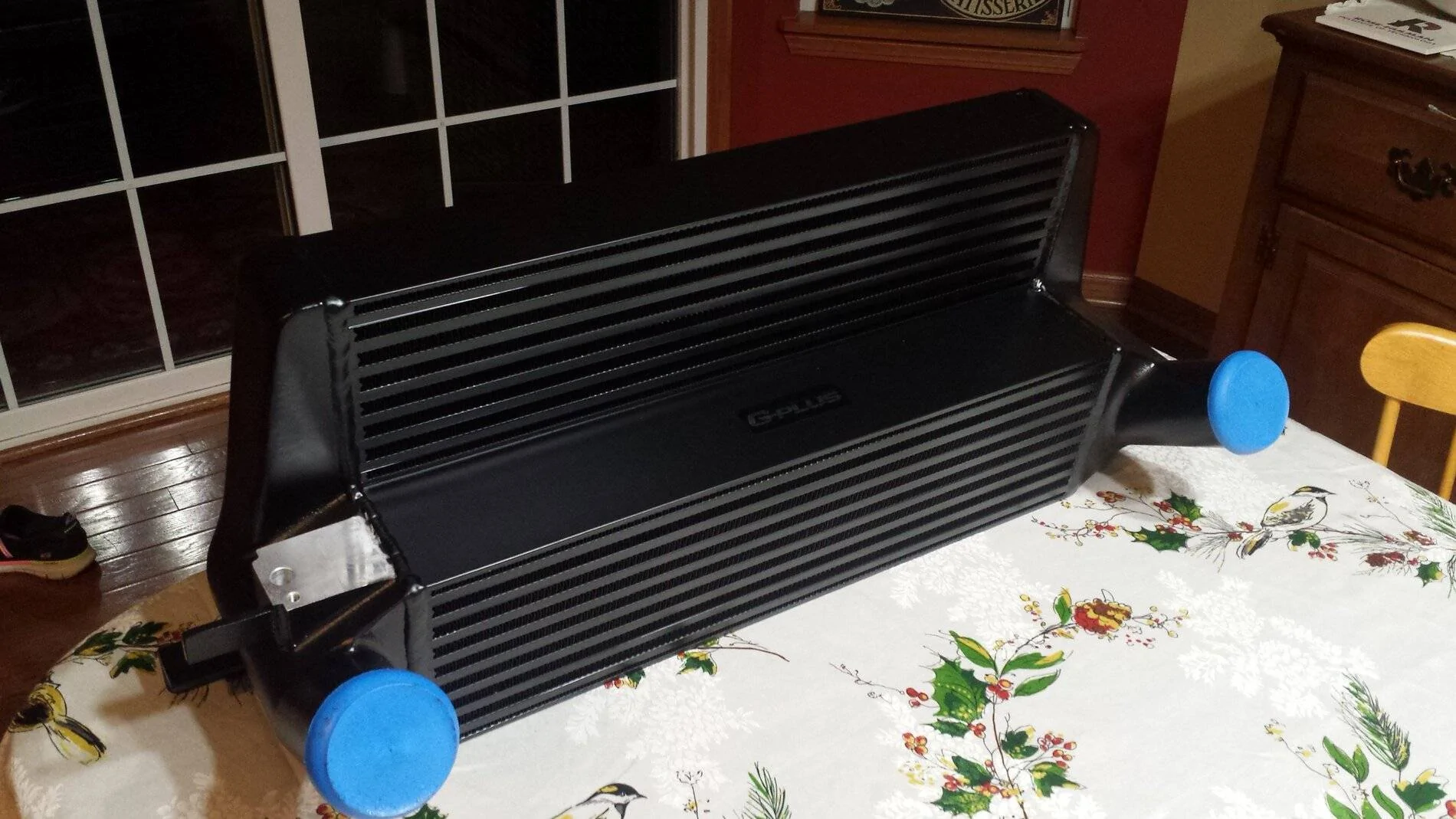

Damn, I wish I had seen your setup before I bought my giant intercooler and the
oil cooler. My intercooler comes forward and extends up to about level with the tip of the crash bar, making it virtually impossible for much air to reach the lower part of the rad. And I'm probably compounding my problems by placing an oil cooler in front of the rad. I'm tempted to undo this and start over :(
granted I didn't test mine under HPDE conditions but this is all the same stuff I did to my EB. I think you need to change out the crash bar with the round one like you see a few posts up and that will dramatically improve access to air.
The big IC was very effective. I didn't box anything. If I buy-back my EB I will definitely do some updates to it.

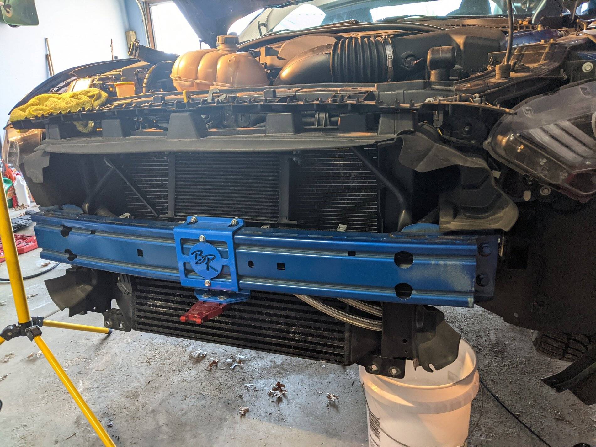

I noticed that thinner bar. However, unless you cut open the bumper cover, I don't see how it's going to let more air get to the rad?
shogun32
Feb 8, 2019
92
16,223
14,019
Northern VA
you can only cram about 30-35mph worth of air thru a radiator so completely open front is not important. What you don't want is air just spilling over the side when it encounters a semi-permeable surface, or causing all kinds of turbulence in front of the radiator face, nor 'shadow' areas where air can't actually get in - eg. right behind the crash bar.
