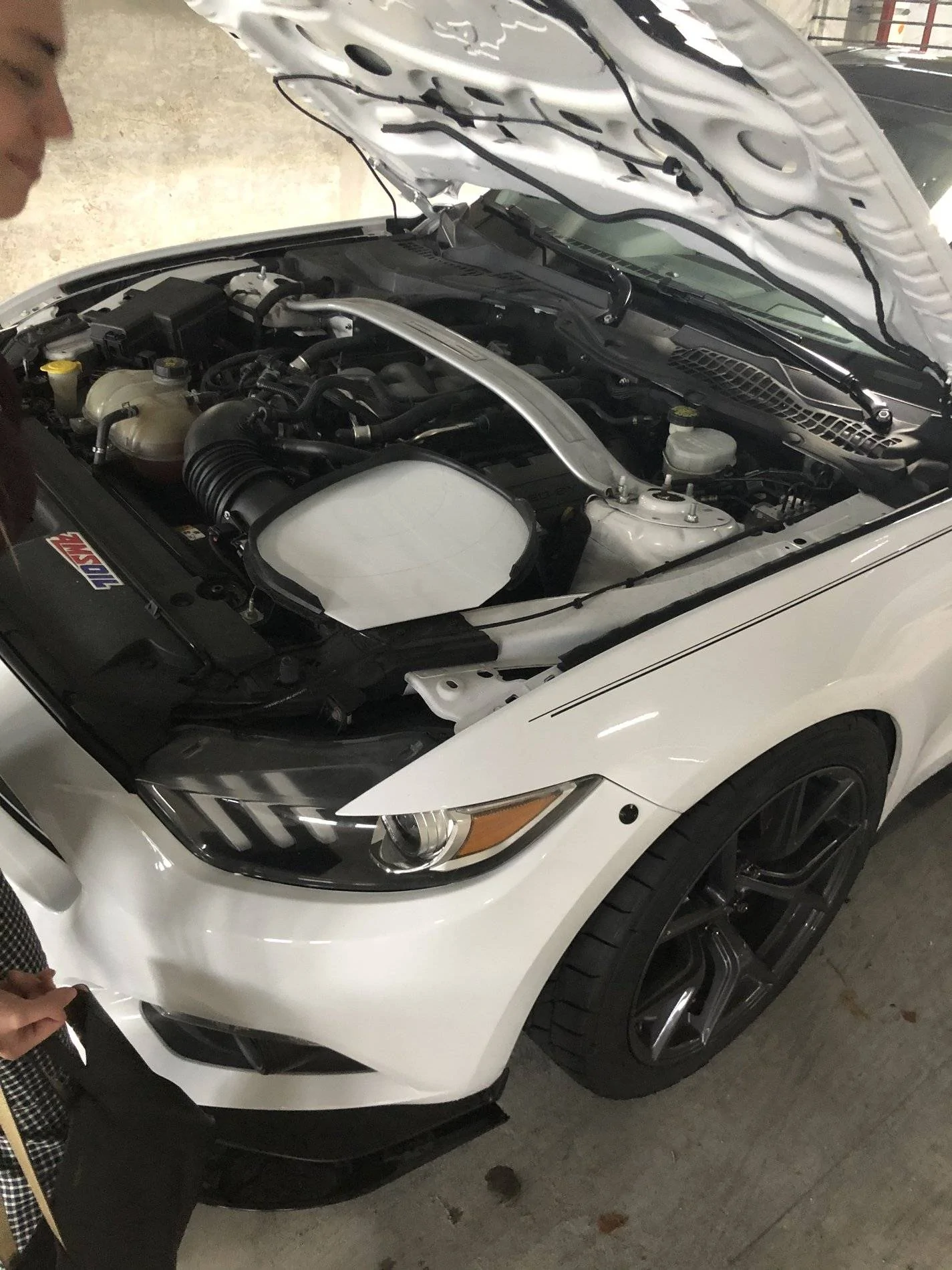

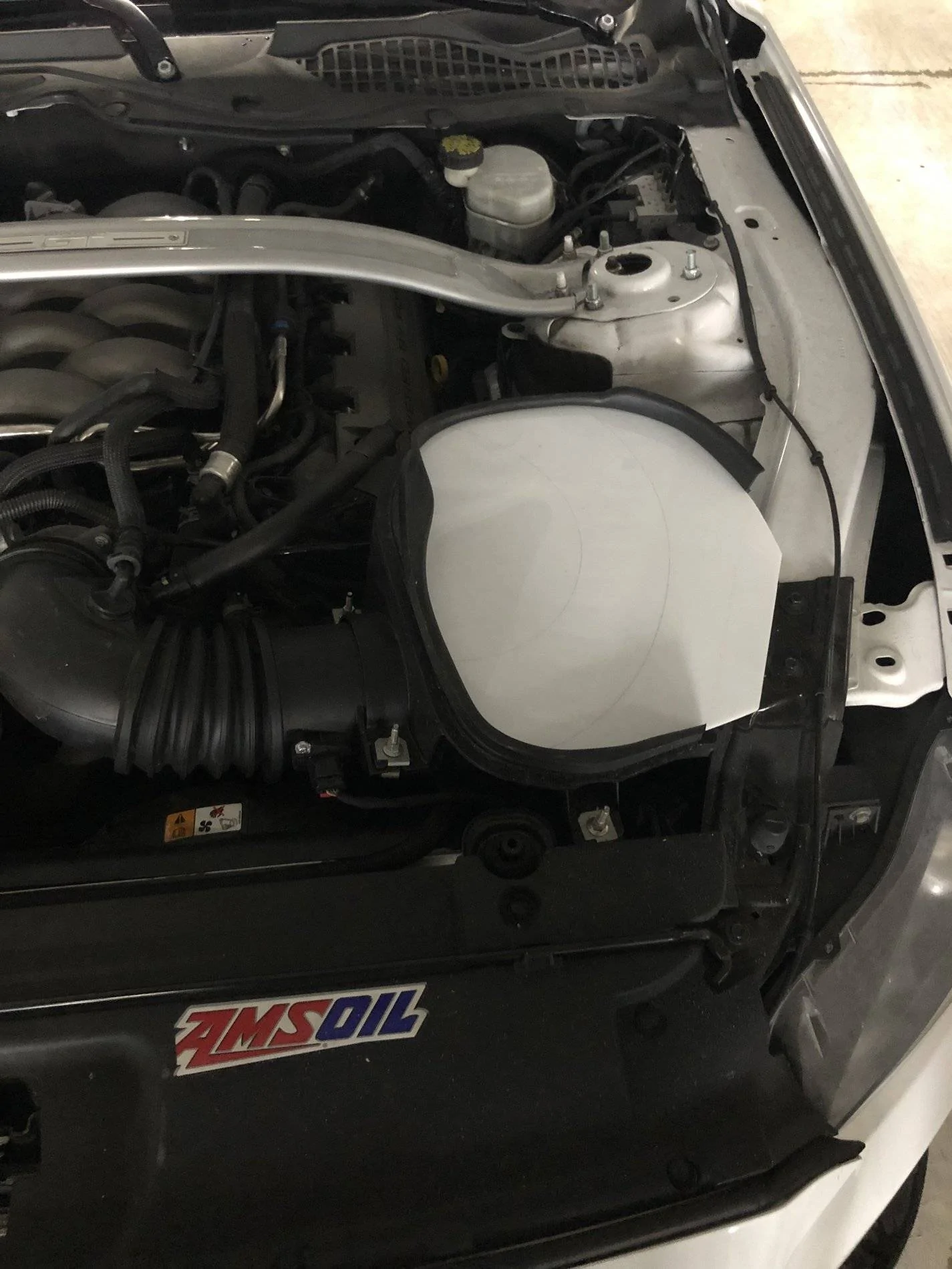

I covered my JLT in my 2018 creating a plexiglass cover.
Very simple.
4 L SHAPE brackets
4 bolts
8 rubber washers
4 nut pr similar
Some metal glue (to glue the bolt to the l shape which otherwise will fall)
Then 12$ plexiglass.
Take the shape. Cut it with a metal cutter circular blade.
Make the hole in the plexiglass and boom done :)
Very very helpful for daily.
I found out not very useful for roadcourse purposes ( you run 3f above after half lap anyway)
I would encourage you to buy somenthing like the JLT filter mesh.
FFPERFORMANCE can definetely help you out
For street it works fantastic.

Fabrication progress..

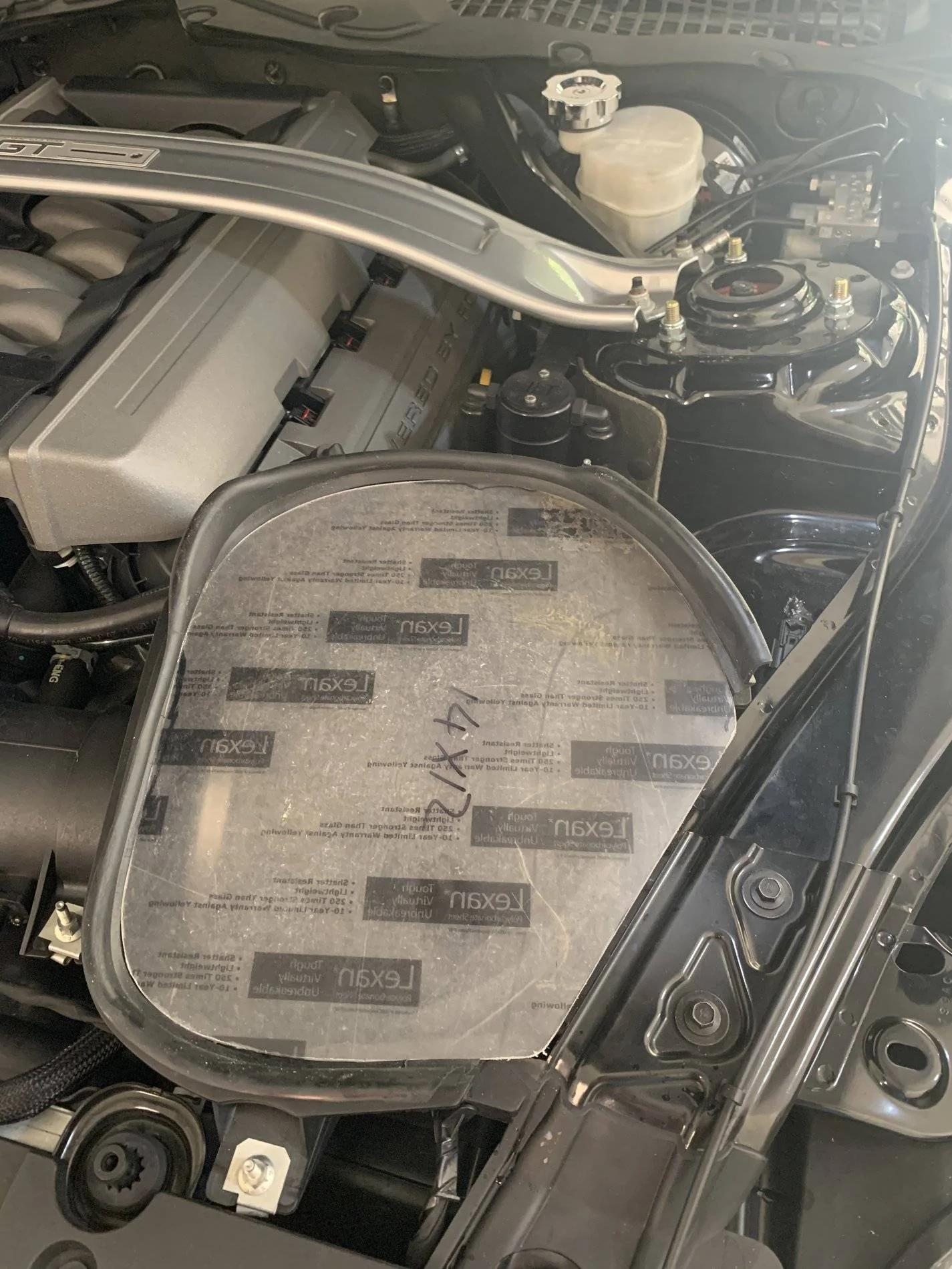

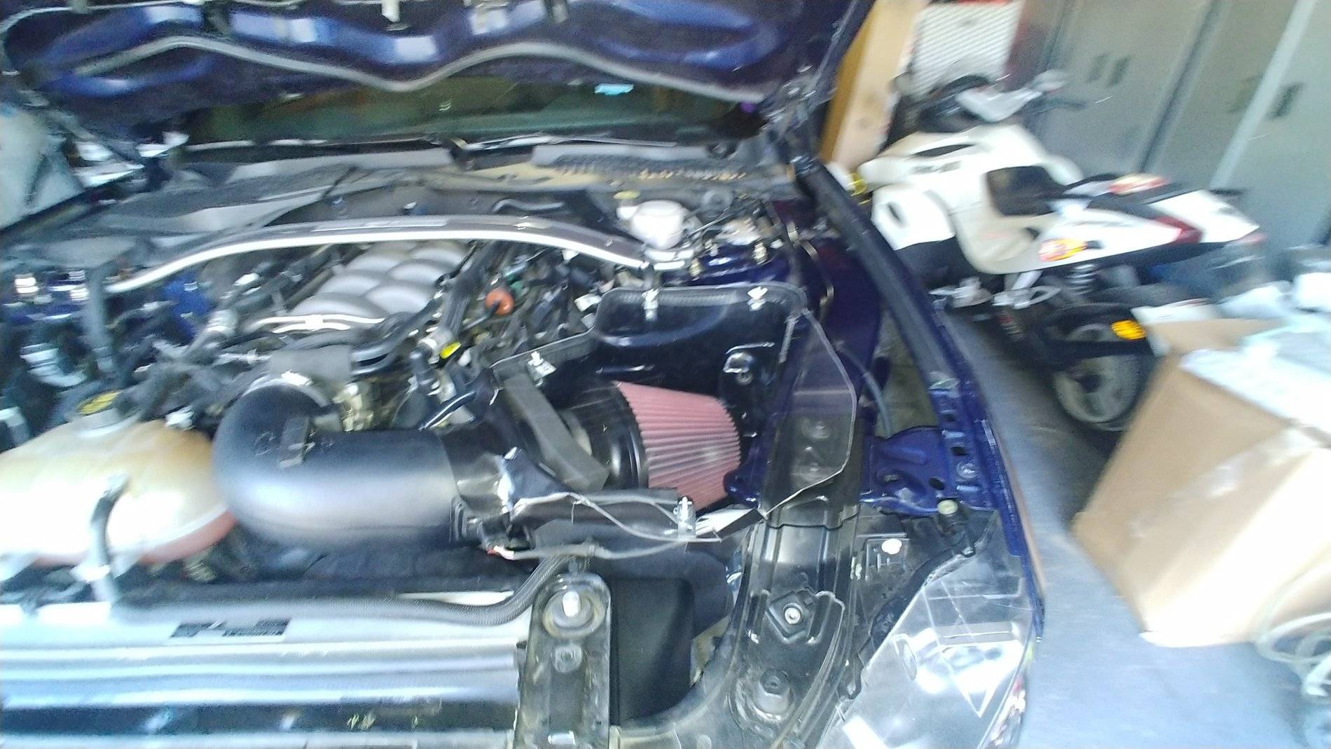

I did something similar with an old acrylic glass sign I had laying around. Cut it to fit within the seal. Works like a charm until I get my hands on some lexan glass.
