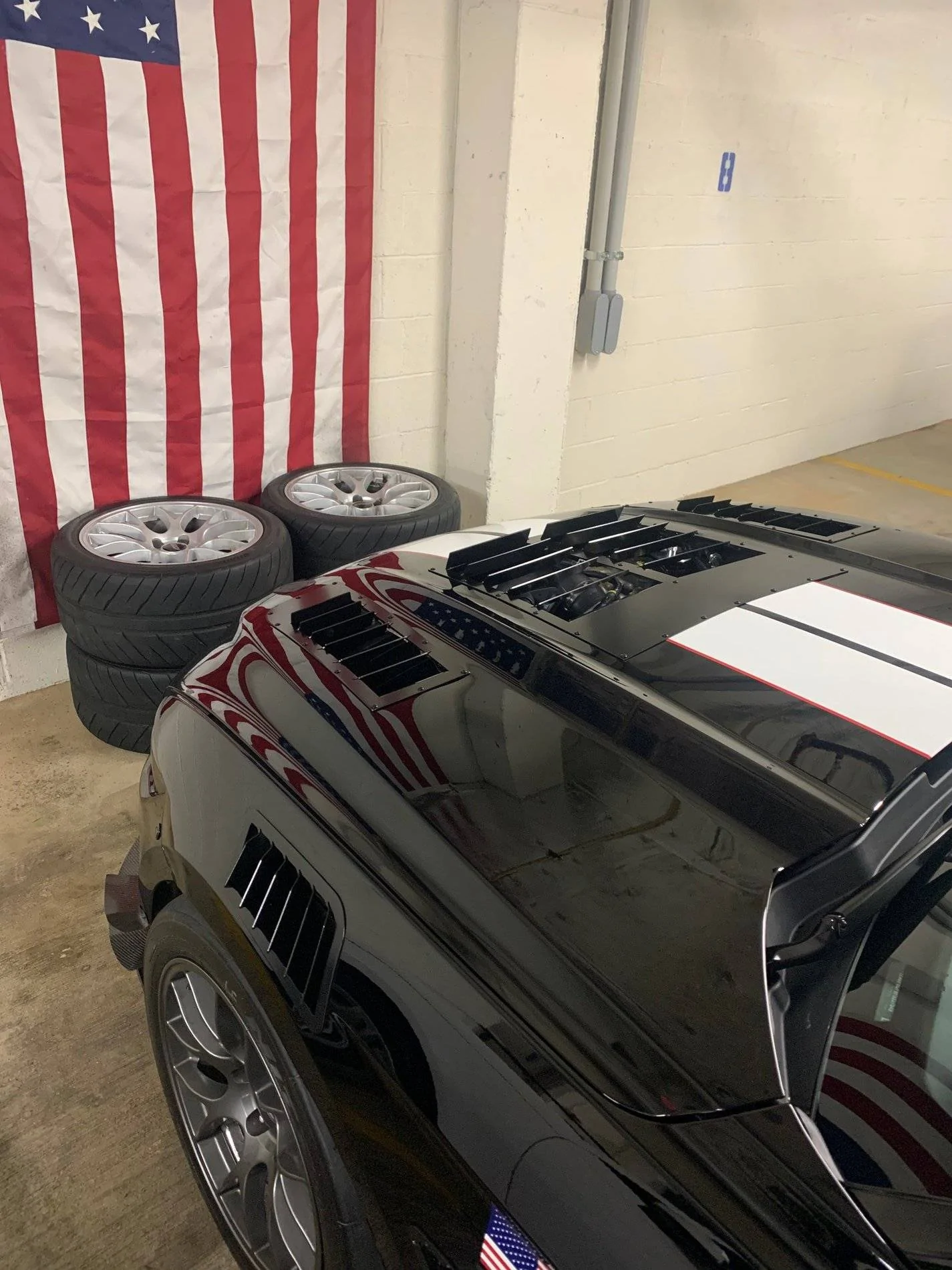

That is my blue mustang :)
So i have trackspec still on the side but i did change the central one with RACELOUVER one.
It seems well done. But to be fully honest i don't have personal data providing they work BETTER FOR ME than the central trackspec one.
I did a trackday with the new setup in LAGUNA SECA but temps were around 70f so not really big issues in overheating.
Aug 1st i have thunderhill where we will be at 100f. I do have data there with full travkspec setup so should be nice to see differences.
On wind tunnel RACELOUVERS generates more downforce also. (About 20lbs more)

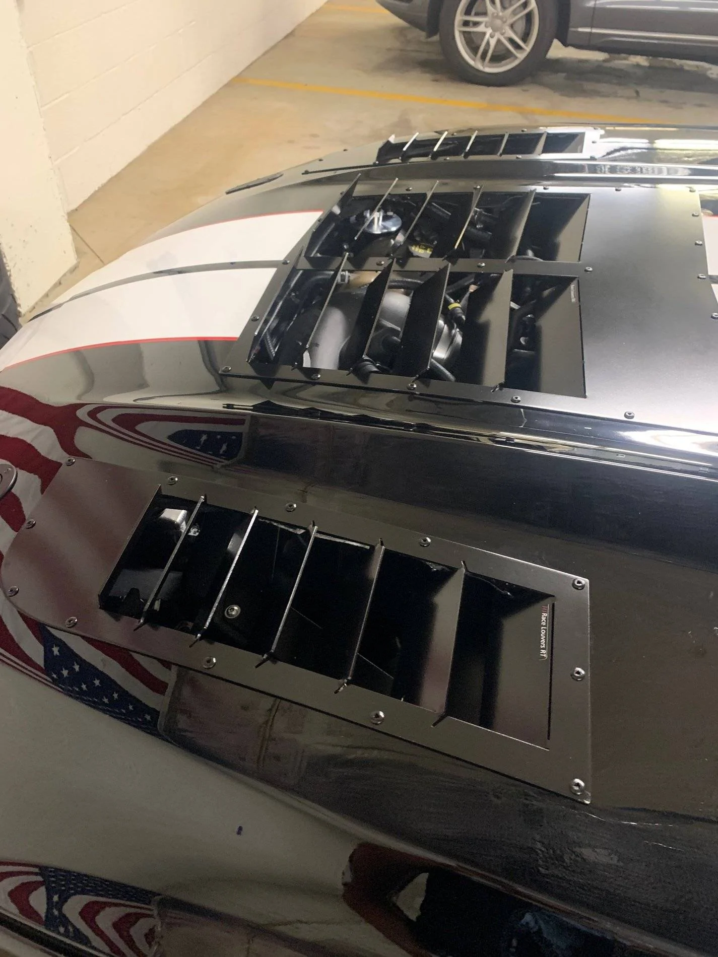

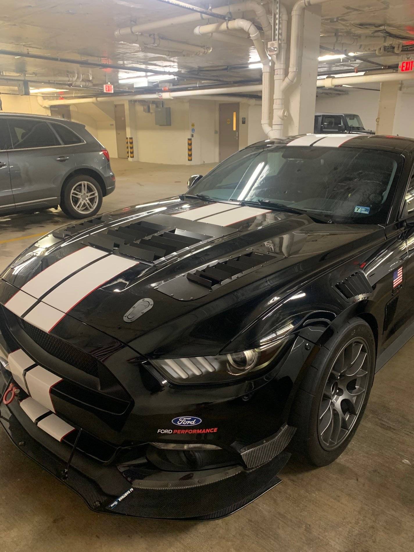

The pic with trackspec and racelouvers together.
Also the fender ones :)

@Flyhalf noticed the center vent has an extended plate that goes up the hood (presumably to cover the existing hole left by the Trackspec?)... did you request that extension? If so, how much extra did they charge for that?
I have been wanting to go with the RaceLouver center vent, but I already have the trackspec... if I can get the racelouver vent and have it cover the existing trackspec hole that would be outstanding.
yes. the back please is to cover the trackspec hole. and honestly it was just because I did install the trackspec to way back. IF YOU DON'T NEED TO MOVE THE POSITION OF THE TRACKSPEC, racelouver will basically cover it.
i agree . CALL RACELOUVERS. say Alessandro told you to call :)
Albert is a great person. very very knowledgeable .

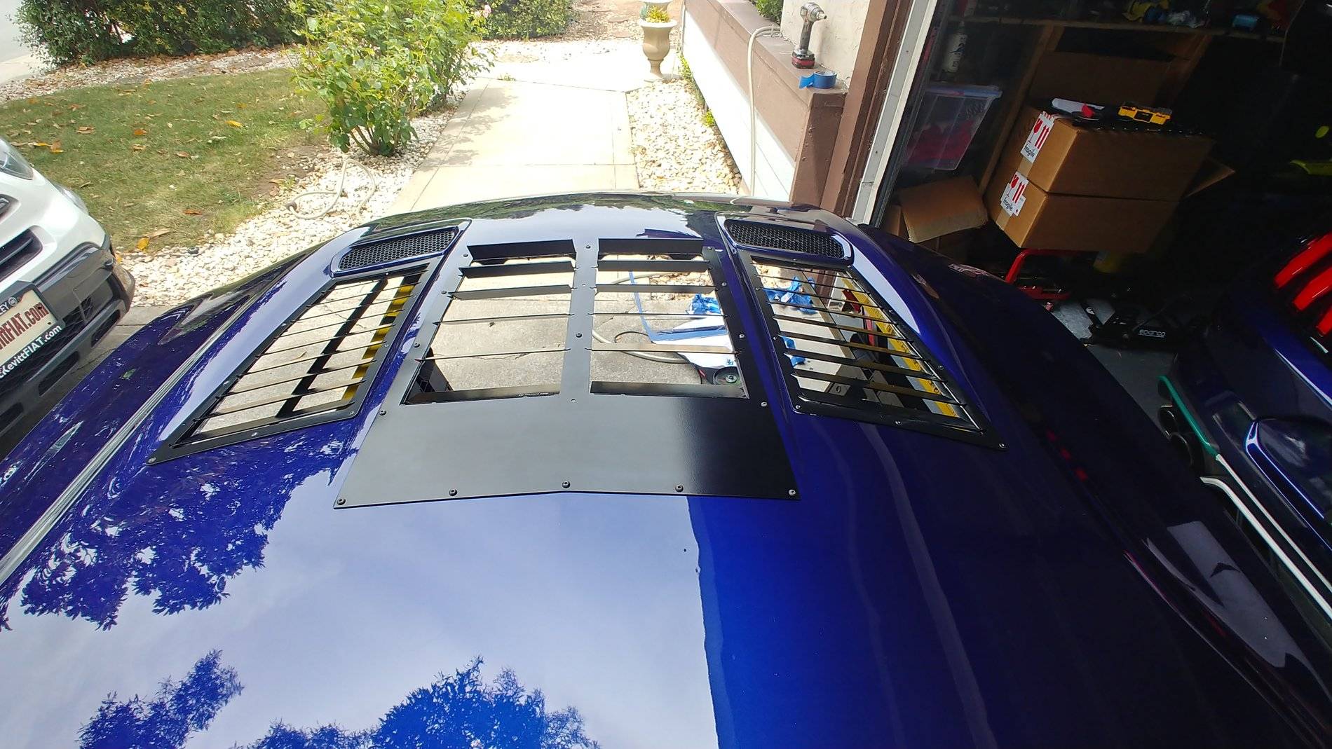

Thanks for the replies. @gtorpedo our hood setups look similar, although I would much prefer yours as the racelouver design is superior in my opinion. The trackspec center vent hood placement is wayyy too far back... ugh.
I ended up making custom wickers for my louvers (trackspec/verus). They work well with the wickers and honestly probably don't need to change them out, but... can't stop touching this thing.

Al will tell you for optimum performance, you want the front fins of the vent flush to ~2" behind the radiator. The block off plates allow you to shift the center vent forward enough to accomplish this and cover the existing hole you made for the Trackspec vent. Also may look into his side louvers as there is a block off plate up front, as I believe both the Verus and Trackspec are positioned too far forward (in front of the radiator) which reduces cooling efficiency.
