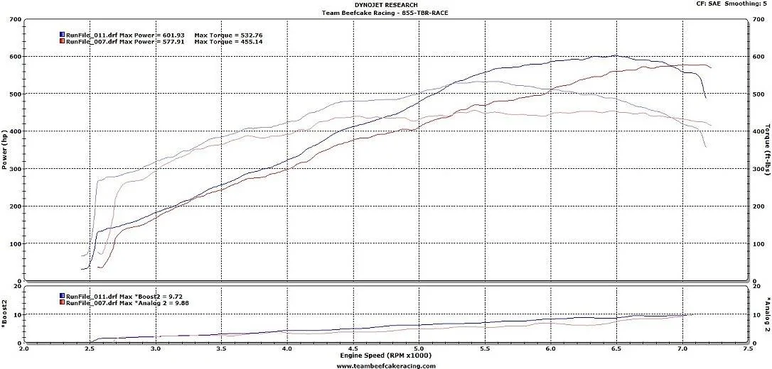

Centri not making any noticeable power till 5k rpm is a weak ass setup.
talking about the torque booster adding more power compared to without
This graph for example...like 10hp at 4k but like 70 at 5k. Nice boost but it doesn't really fatten the low end up like OP wants
