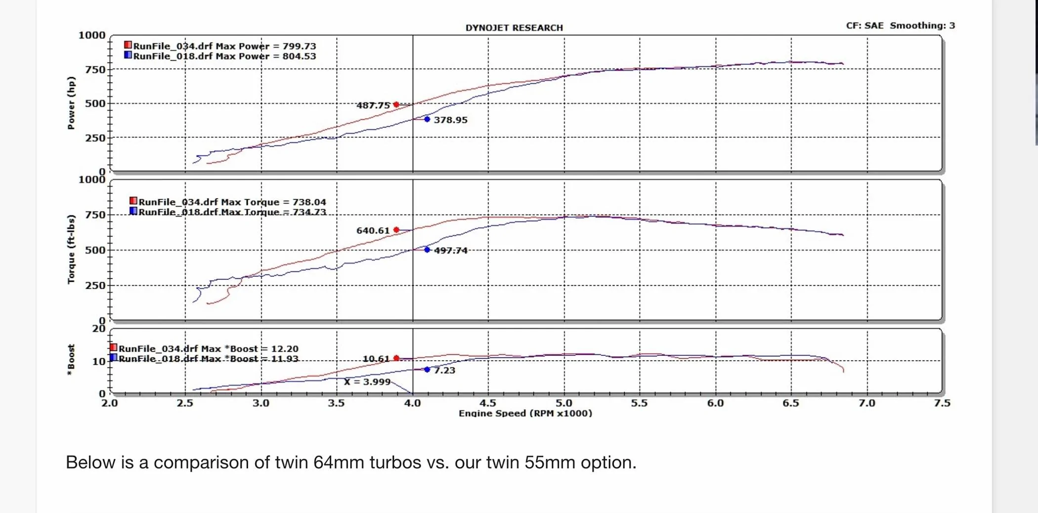

hellion turbo V ess g3 120mm pulley of memory…
Just shows how quick small turbos can spool 500hp @ 4000 , compaired to 5700for the ESS
PD if you want power now…but comes with heat. Interchiller would be awesome for track stuff To help keep everything cool.
but very hard to beat the simplicity of any supercharger really. ESS is a no brainer for that. One day and you away Having fun.
every video I see century blowers is just about people going flat out , with out showing day to day drivability or mid throttle cornering etc. perfect for flat out a10 cars. Got to be at high rpm to make them work.
I guess this is where PD is for the win , crack the throttle and you have power Anywhere any time.
The custom made twin turbo I went in was pretty perfect. At 2500 we had 3lbs of boost and it just was instant power from there Whenever you needed it. almost felt like a OEM turbo car. It had 750hp on 10lbs. It felt so perfect and had power at any RPM or gear. Was a 6r80 car stock Converter etc.
We have a Mercedes A250 and it has full boost at 1800rpm yes it falls over I the higher rpm , I feel coyote is not that different than 2 of these bolted together.
turbo tech has come along way and I feel If one was not shooting for huge HP numbers it wouldn’t be hard to replicate something like a 650 or 700hp instant boost type set up.
kind of perfect drivers car….…. You have power everywhere and controllable via boost curve.

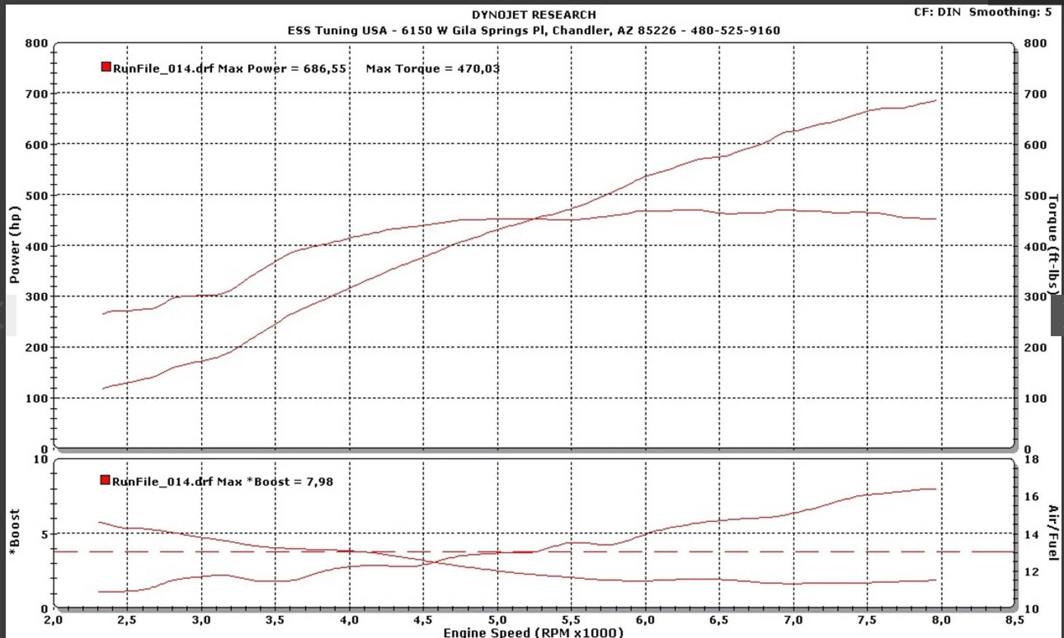

Yeah I see that they dont have lag, they’re just weaker at low RPM. Im my case (autocross), I’ll be in 2nd gear at whatever RPM the course allows, and if I’m getting on the power its probably digging out of a 35mph corner to accelerate up to 70mph before hitting the brakes for the next slow element. I need more than NA torque to pull out of corners at low RPM and to makeup for the torque hit I’m going to take from switching to 3.31 gears
It looks like Centris sort of do that. I’d have a little more power at 3k than stock but not tons more and sure once I get going things will build ok. With a turbo, by the time it spooled I’d be out of time and hitting the brakes. Its very hard to prespool for a corner exit with your foot, so turbos are out, but I’m on the fence about Centris
A wipple might be the right choice for power delivery (more boost at low RPM??) but they’re heavier and more expenaive.
My question is: Are you planning on installing a fuel system? (Or KPM type of upgrade) so that you can run E85?
IMHO, the centri setup will work great for what you are trying to achieve provided you get the benefit of the additional timing you can add with E, and the ability to pulley down. People saying that ā€œthey’re weak down low, no power until 5k rpm etcā€ are running conservative setups that aren’t exploiting the system properly.
ESS or Procharger, E85, and a pulley that will net you 13-14 psi, and you will see boost the moment you tip into the throttle.
people running pump gas and a giant blower pulley are sad because they aren’t coming anywhere near the full potential of the system

Exactly. You spend very little time at redline. Pulley so that you’re making power as soon as possible. The ethanol helps not only with timing, but cooling the cylinders (especially important if you have a stock bottom end with very tight ring gaps)
