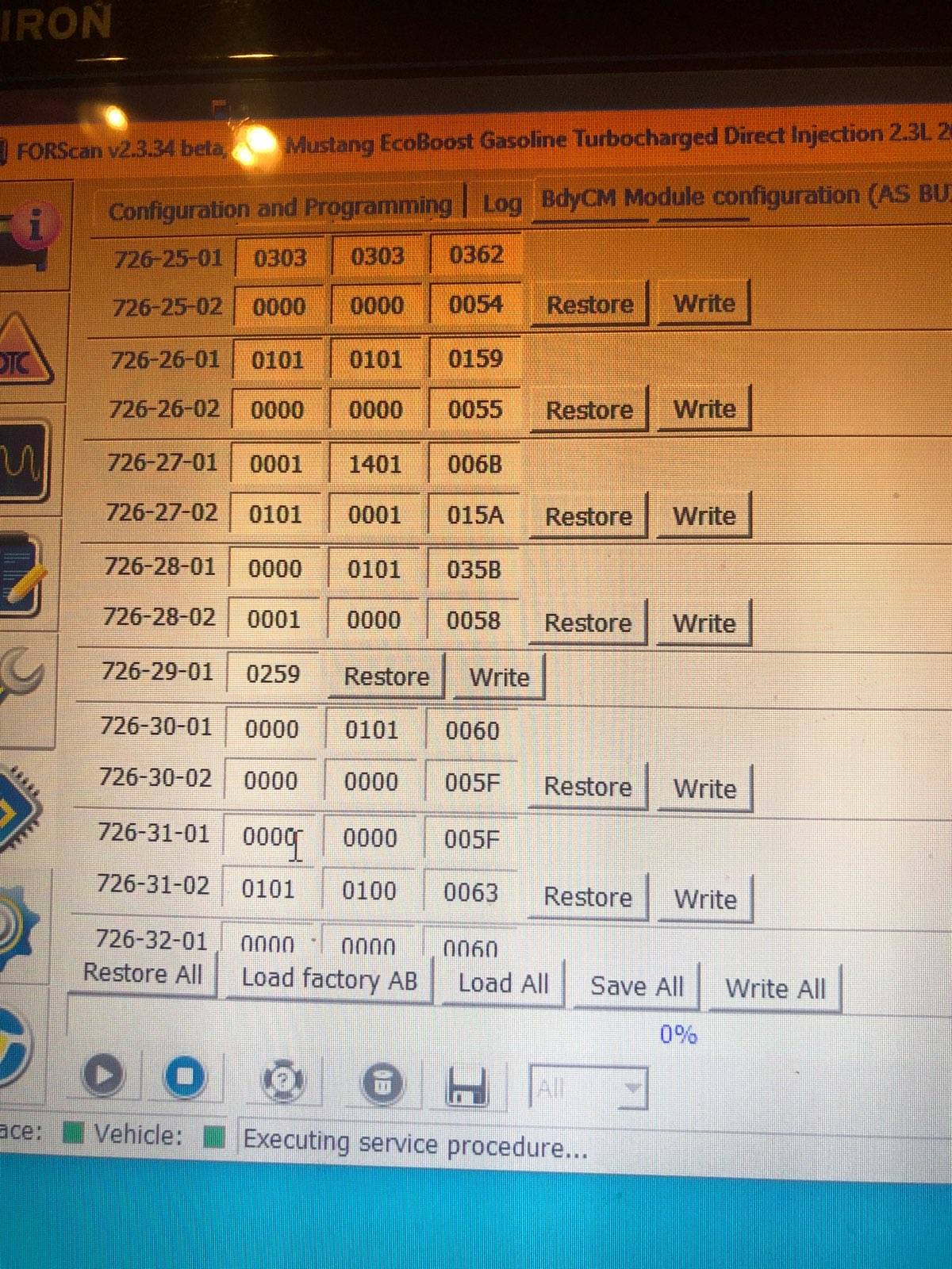

hey guys try this for the hazzard lights
Base->Sync3 Swap, Fix Hazard Toggle BCM 726-29-02 : xxxx xxx0 xx Enable
Hope it helps
I’ve found FYI no code line matches for a 2020. The 02 doesn’t exist.

Has any 2020 owner upgraded to sync3? I don't seem to be able to fix hazard toggle switch. The 726-29 line in the Bodycm as built is different. There is no 02 line.
I downloaded a premium 2020 as built and they match what I have for 726-29.
Also lost FordPass connection, but that's a different topic. Any help is appreciated.
Try this, 726-41-01 x*xx xxxx xxxx Hazard Type 0=Latching 1=Momentary.
Hope it helps
I changed it from xxxx xxx1 xx to xxxx xxx0 xx and now hazards behave as expected, thanks for the tip.

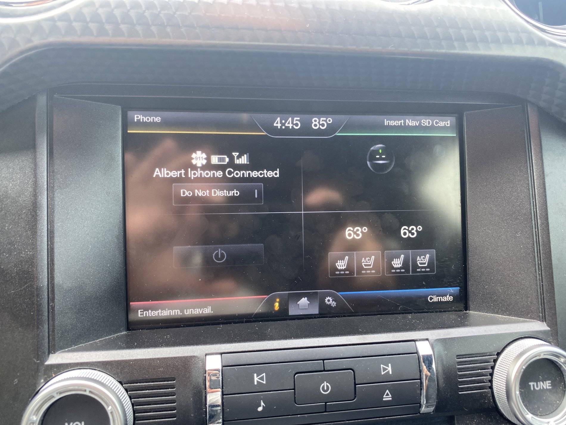

Anyone know what I need to mess with in forscan to get radio working correctly?
I bought an plug and play harness but guessing I need some stuff tweaked in forscan because only my right speakers work with the Bluetooth audio and I gotta changed audio format using the audio request button but I don’t hear the lady either
FYI I have a 2016 PP1 and went from the sync 1 to sync 2
