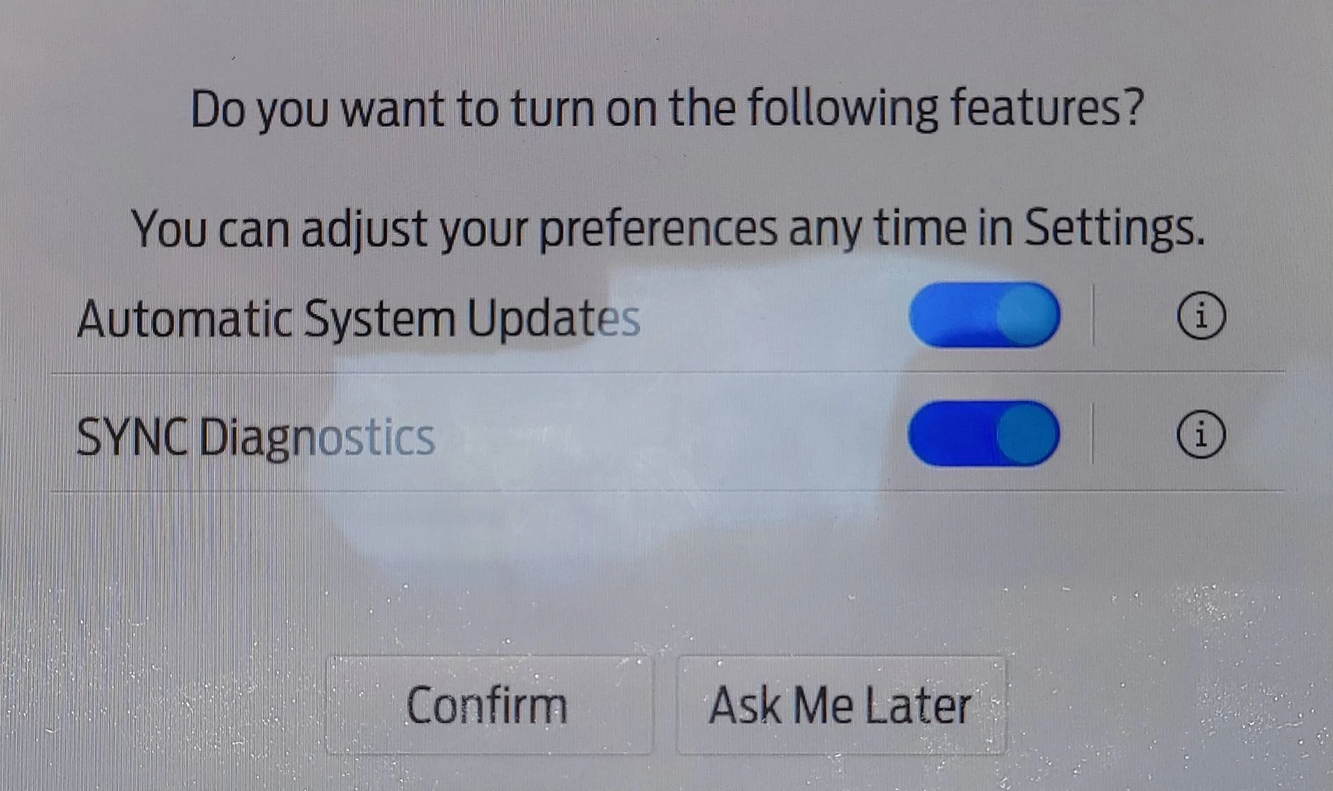

I have a 2015 mustang and I upgraded the sync 2 to a sync 3 last year. It worked great until recently, now it's forgetting the USB thumb drive and this automatic updates window comes up every other time I start the car.
It also has to index my usb drive every time this happens so I can't use syncs voice features for a while. I've tried a master reset and that didn't fix anything
Any ideas?

At first I thought the title meant you upgraded the software and not the hardware.
I had the same symptoms as you - those screens plus it would not remember some settings. I upgraded the software version and that fixed it.
Why doesn't Sync3 retain my settings?

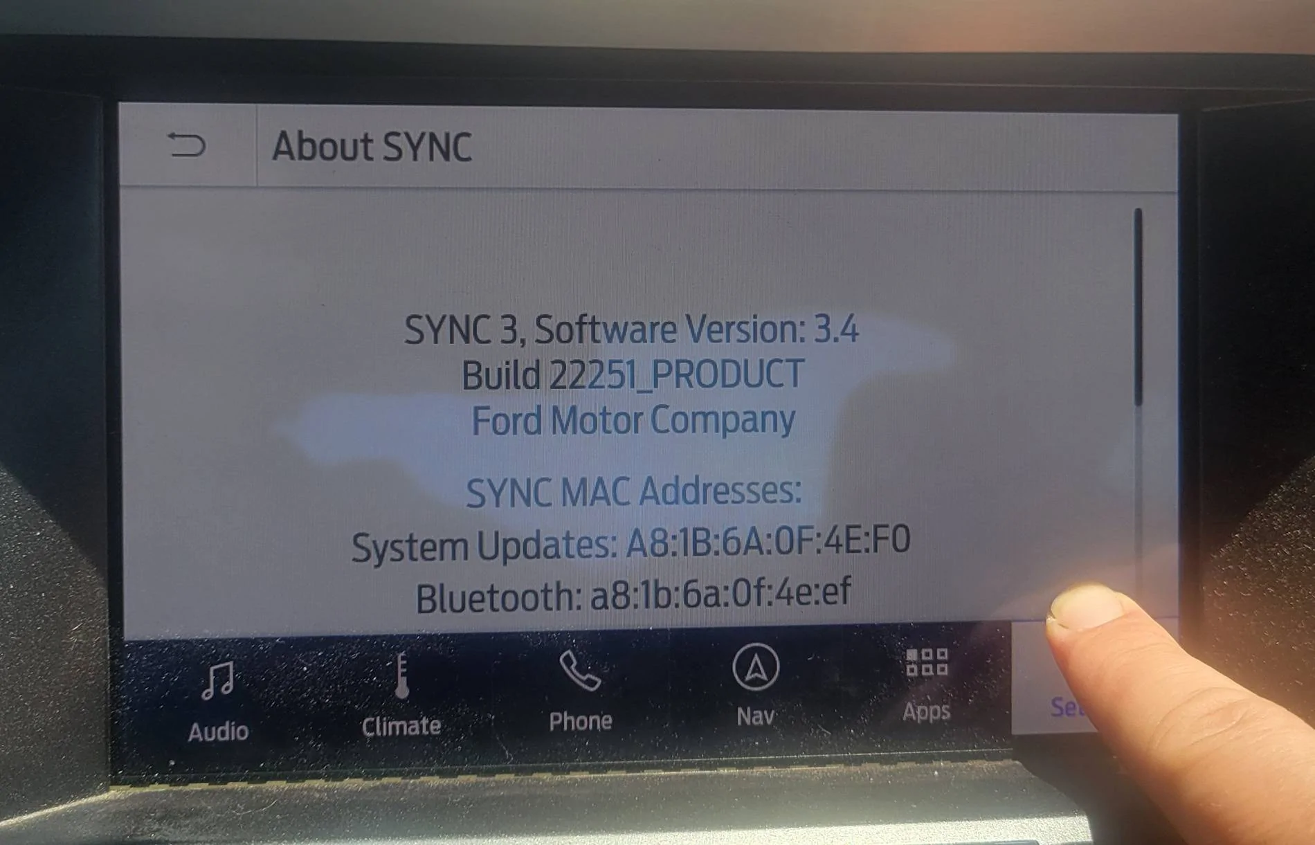

I update SYNC 3 with the latest version from the Ford website. This is a new version that I have after the update:
SYNC Generation SYNC 3
SYNC Version3.4.23188
Do I need a dealer visit for an update or it's the same software update?
