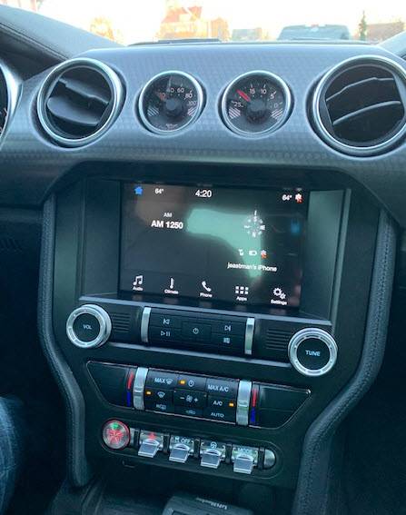

Just finished my install from 4" to 8" on my 2020 GT PP1 Base car.
I am so glad I worked with Thomas at HextallS550.
The unit was brand new. Bezel was new as well. The price cannot be beat plus the excellent help to program. I would not hesitate to reach out to him. I think he has some bezels available for a kit.
All functions are working flawless..
