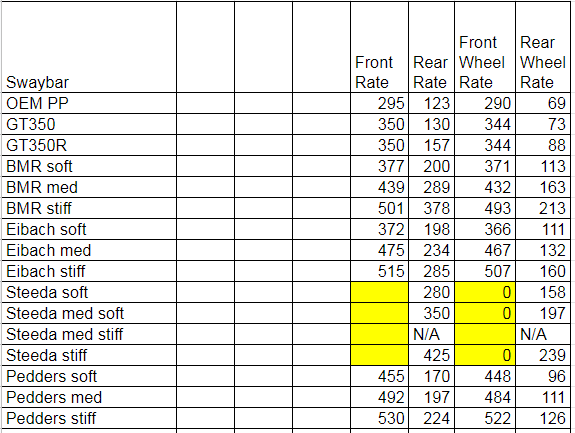

from Brian's spreadsheet. He might have updates but there isn't another public source that I know of.
SwaybarFront RateRear RateFront Wheel RateRear Wheel Rate
GT PP29512329075
GT35035013034479
GT350R350230344140
BMR soft377200371122
BMR med439289432176
BMR stiff501378493230
Eibach soft372198366120
Eibach med475234467142
Eibach stiff515285507173
Steeda soft2800170
Steeda med soft3500213
Steeda med stiffN/AN/A
Steeda stiff4250259
Pedders soft455170448103
Pedders med492197484120
Pedders stiff530224522136
Interesting to note that the updated sheet has 230 for the GT350R rate. Previously, the number was 157, per https://www.mustang6g.com/forums/threads/sway-bars.119344/post-2503192.
I wonder where this new value came from? My Google-fu failed to yield any results
If the new number is true, then the Pedders soft is actually the least stiff upgrade!

Digging deeper, I found some info on the PP2 sway bar.
https://www.mustang6g.com/forums/threads/pp2-swaybar-data-anyone-have-it.122203/
Ford claims the PP2 rear sway bar is 67% stiffer than the PP1. It is a solid 24mm rear sway bar.
Bmac's OEM PP rate is accurate; Cortex has OEM measurements for the sway bars here: https://cortexracing.com/product/2015-ford-mustang-eibach-anti-roll-front-rear-sway-bar-kit-s550/
Given the PP1 rear sway bar is 123 lb/in (75 lb/in wheel rates), that would mean PP2 rear sway bar is roughly 205 lb/in (125 lb/in wheel rates).
The GT350R, though hollow, should have a similar roll stiffness per: https://www.mustang6g.com/forums/threads/pp2-swaybar-data-anyone-have-it.122203/post-2551400
Given this info, the stated 230 lb/in seems to be not far off given the above estimates. With this knowledge, the Pedders rear bar is probably the best possible upgrade for the rear bar, if additional roll stiffness is desired! But one looming question still stands: is the bar still too stiff?
I have yet to reach the level of skill where I can [safely and consistently] approach my car's limits on the track. I'm running the stock PP rear bar right now; I'll revisit this thread when the time comes :)
shogun32
Feb 8, 2019
92
16,223
14,020
Northern VA
yeah it's crazy beefy. Thanks for the info, I updated my spreadsheet.
