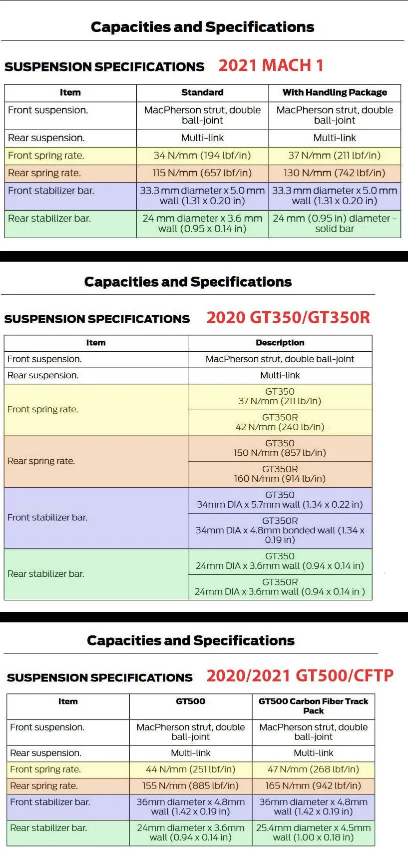

I made that :D
Except I lost the screenshot I had so time to save it again haha
For reference, the HPP model has a 34mm FARB & 24mm RARB.

The shear number of options these engineers come up with is pretty silly. Look at those front springs.
194 #/in
211 #/in
240 #/in
251 #/in
268 #/in
For sure there are at least this many others in the mix when you add the various versions of GT and Eco.
Those could easily be reduced to two, maybe a 220 & 270 #/in. If you wanted a softer spring for the 'daily' GT's, then maybe throw a 170 in the mix. They should spend a less time tinkering with meaningless spring rate changes and a little more time figuring out how dampers work.
194 #/in
211 #/in
240 #/in
251 #/in
268 #/in
Lol @ figuring out how dampers work.
For the OEM, I'm sure they have some internal targets for ride frequency or body roll or something. Spec'ing a different shock valving or spring rate is not even a speedbump in their pipeline. They just don't need to share springs across vehicles for such a simple and known quantity part.
You're less cynical than I am. My guess would be they have a ride and handling lead engineer on each variation of the car. That engineer wants to justify his position by spec'ing a slightly different rate than the next, but not so different that any negative comment about the car can be genuinely criticized or likely even felt. So everyone works prove they deserve a paycheck while staying in the box which some internal Alpha dog previously established.
