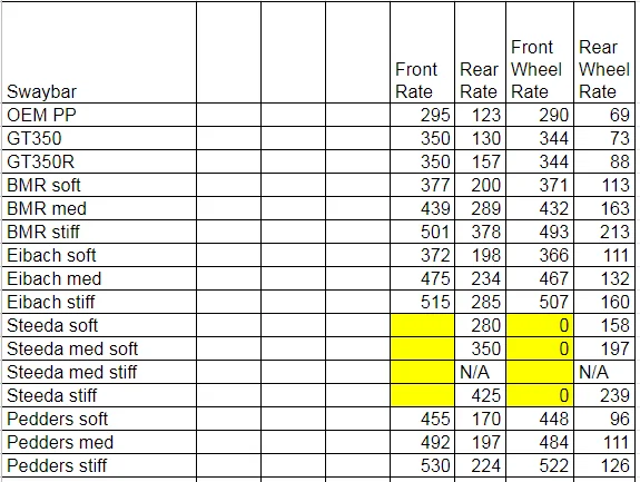

I put together a chart that shows the bar rates (published and tested), and the effective wheel rate of the bars. You can add those wheel rates to the spring wheel rates published on Page 8 of the Spring rates sticky thread. This will allow you to see total roll stiffness and bar stiffness contribution to the total. I do not have Steeda front bar rates yet. View attachment 351548
Link to the spring rates:
https://www.mustang6g.com/forums/th...s-all-in-one-thread.44925/page-8#post-1637308

Excellent info, does anyone know base GT rates? Apologies if this has been posted already.
After some digging on here, it seems as though the front GT bar is the same as a PP bar, but the bushings are not bonded.
