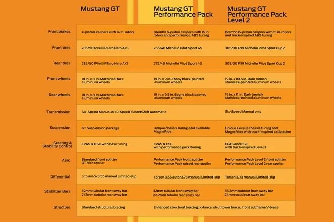

Does anyone here know the diameters and rates of the PP2 front and rear anti-roll bars? If so, please share, thanks.
Edit: While we’re at it, does anyone have the spring rates as well?

OK, no stack of bibles here, but my online research (which Al Gore says is ALWAYS correct cuz he invented it) shows the PP2 springs are rated @ 198 lbs (F) & 823 lbs (R). As an FYI, the PP1 springs are rated @ 165 lbs (F) & 728 lbs (R).

I’m guessing he worked this from the Car & Driver article (I believe) that stated a 20% increase for front springs and a 13% increase for the rear springs from the PP1. Math works out exactly (with a sprinkle of rounding).
I can’t pull up C&D here in Germany, but CJ’s posted the same numbers in their article here:
https://www.cjponyparts.com/resources/2018-mustang-gt-performance-package-level-2
They also mention swaybars for the PP2 being 12% stiffer in the front and 67% stiffer in the rear.
