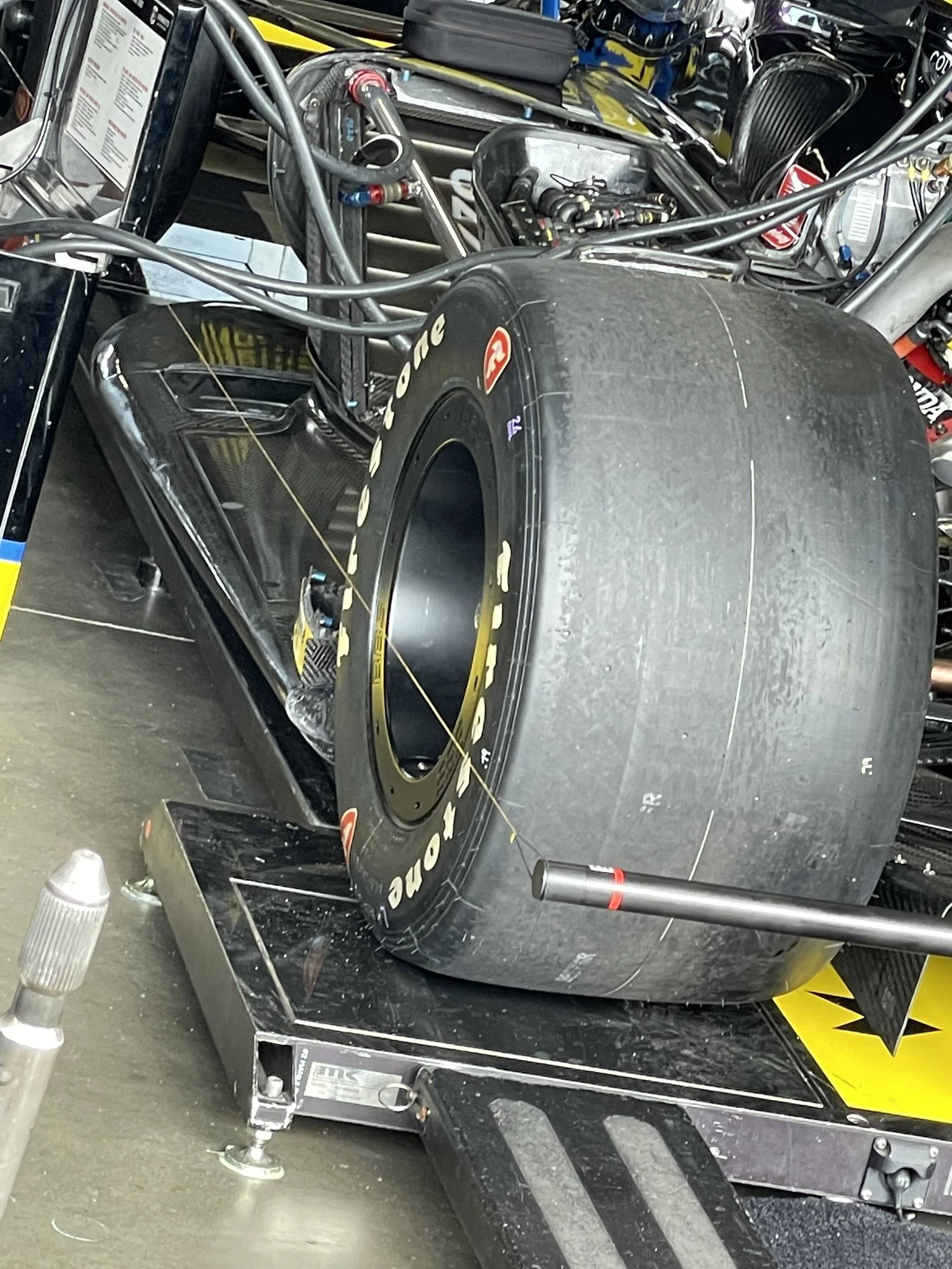

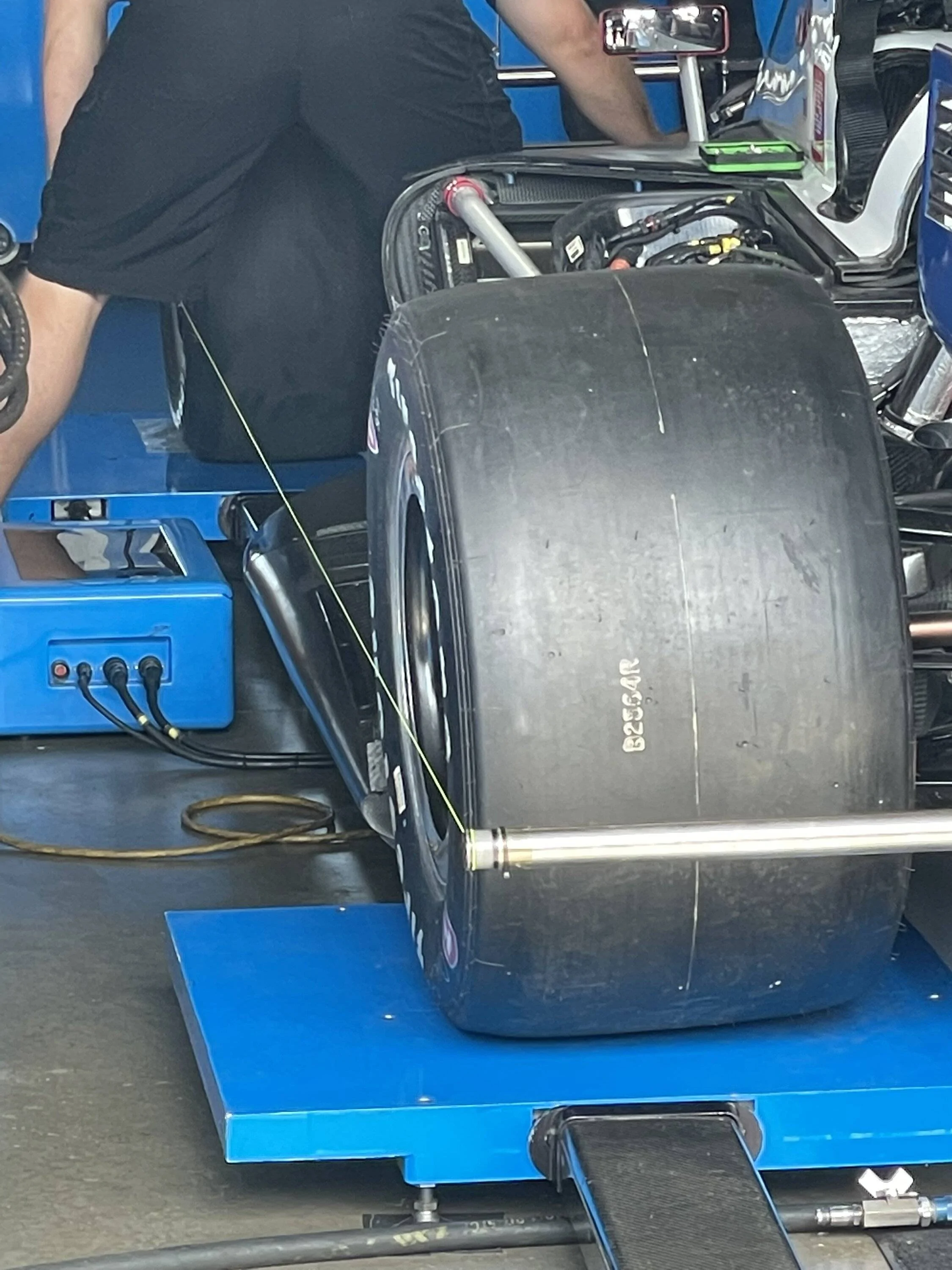

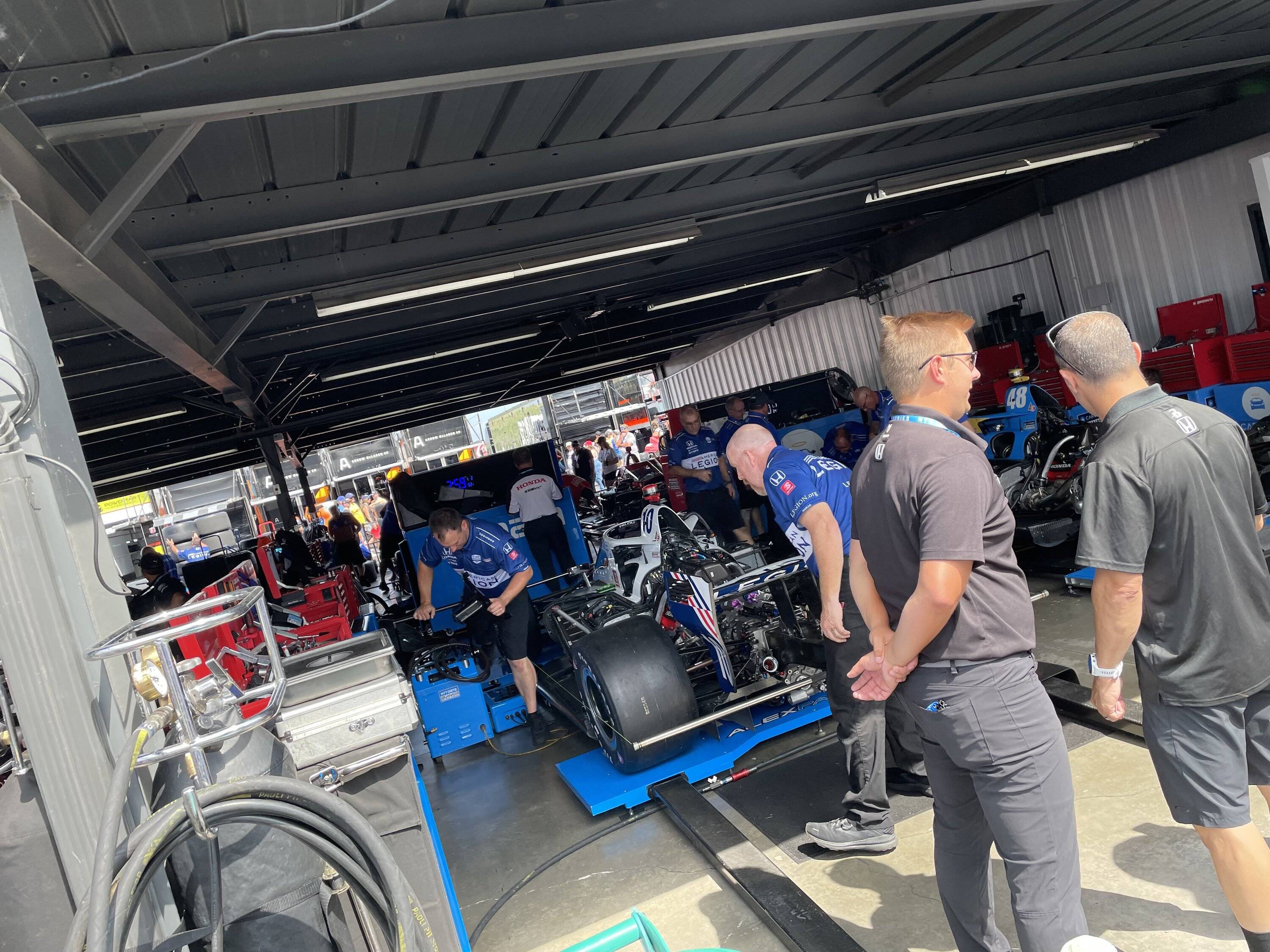

I couldn’t recall which thread it was, but in one of the self/string alignment threads, I know a few comments were made about how unbelievable it was that strings are more accurate and how unlikely it was that top end race teams use strings to do alignments. Well….

Someone said using strings was unbelievable? LOL...I took my car in to get a quick alignment done before an event, and the laser system would move as the wind blew. The shop often works on track cars, and they got it pretty close, but after the event I wen't home and put everything on strings, and needless to say, there was some adjustments that had to be made.
What is better, is even the shop said look, it would be fine for normal daily driving, but you will want to run strings to get it exactly where you want it. That is what we do with the track cars we align anyways. Our alignment machine will never get you there.

I can get +/- 2mm by eye. That's not remotely good enough. Before you try to call bullshit, I've done it because it was the only option I had, and it's happened more than once.
Strings are as good as the person using them. The IndyCar guys will work in 0.25mm increments or tighter.

Which is why you'll notice that most of the IndyCar teams will have a wheelset which is specifically meant for setups and never ran on track. The lip of the wheel will have been machined perfectly flat to eliminate the issue of runout. Let's also be fair, the wheels they use have a little tighter tolerances than most.
