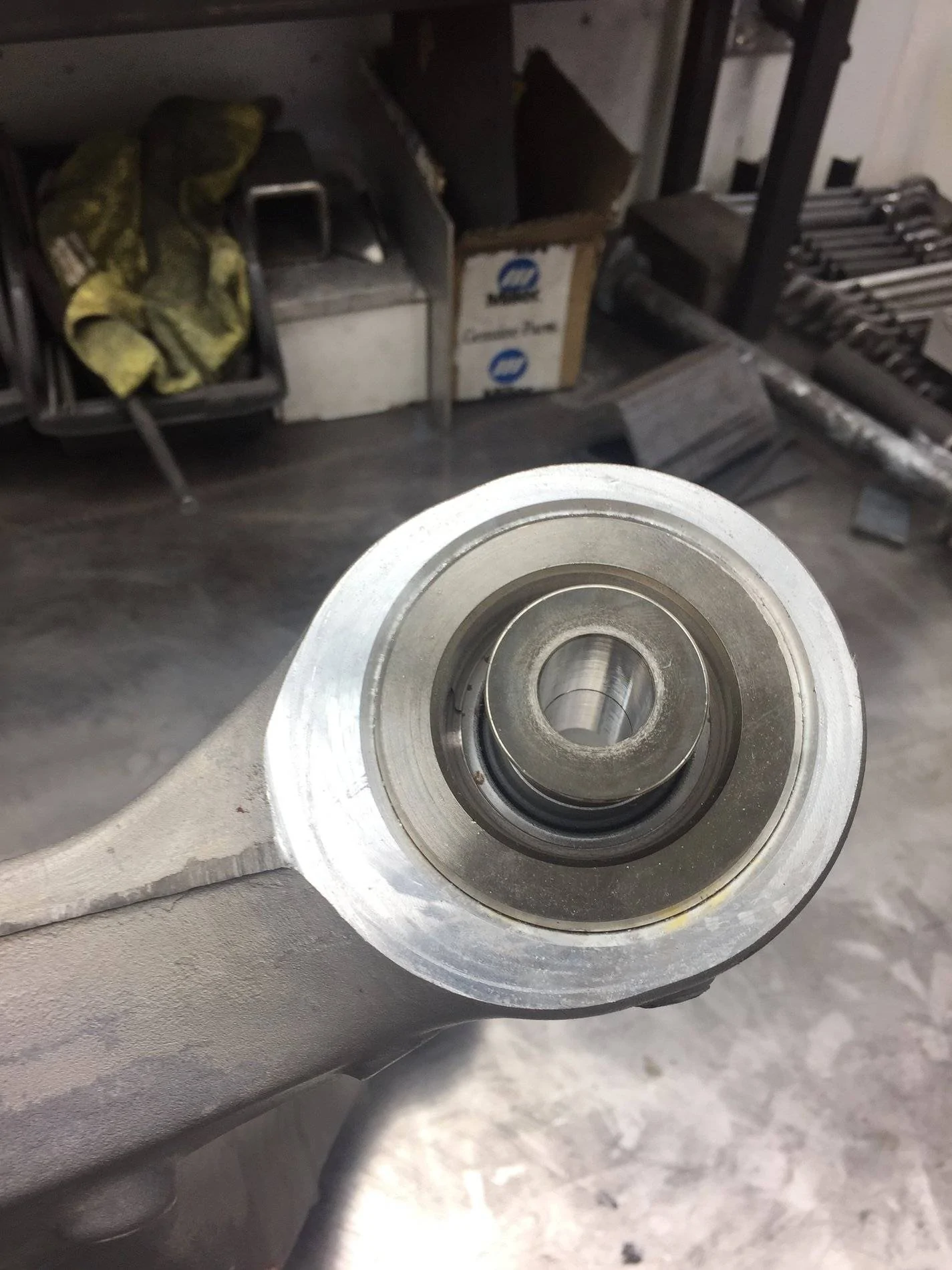

Could you use a deburring tool to clean up the shavings around the bearing? They may clean up nicely and look as good as new. On mine, there was a very small amount of shavings that came out the end once the bearing was pressed in. If you look closely in the pics you will be able to see what I’m talking about.
Will you please post photos of the damaged control arms, as they may help others who go down this road of installing spherical bearings?

Why would Ford make people do that? I think I can sort of see threads at the very bottom but it's hard to tell.
I already put the car back together without taking photos, the amount of metal that came out of mine was pretty significant imo - which is why I went ahead and bought 2 new lca's to get them done professionally.

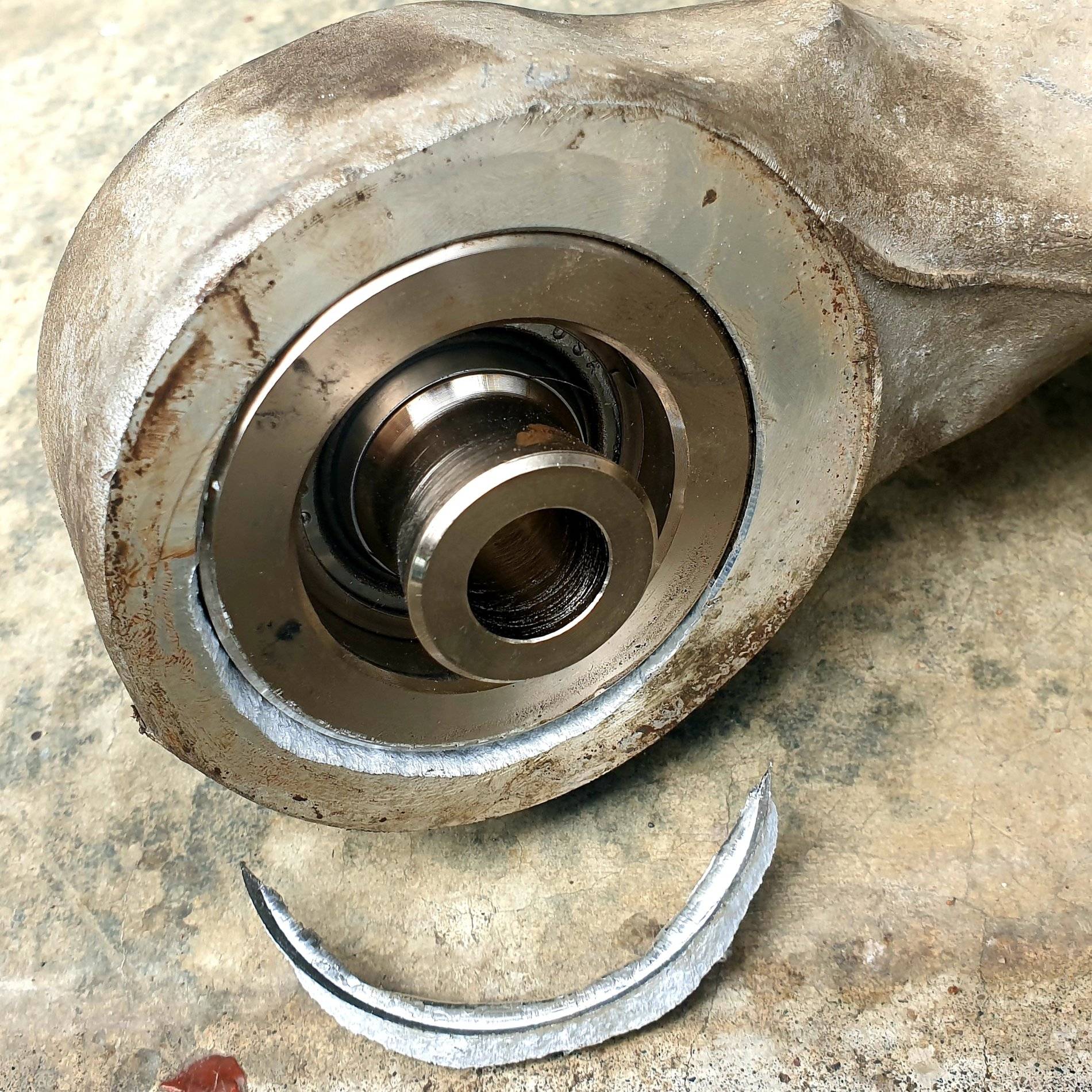

Something like this?

Yes! This is exactly what happened to me. What has been your experience with this?
It was pressing in very smoothly right till the last 1/8 of an inch, the press hung up for a moment like it hit something hard then it actually popped in further than needed and spat out a bit of aluminum. It was on a really merciless bastard of a hydraulic press. I flipped it over, pressed it back a 1/16 to be flush.
I cleaned the next one more thoroughly and used lots of lubrication. Had a similar hang up anyhow but didn't spit out any lip fortunately. I'm just running it and it's been fine so far. I bought a cheap replacement arm if I ever start losing my nerve about it.
