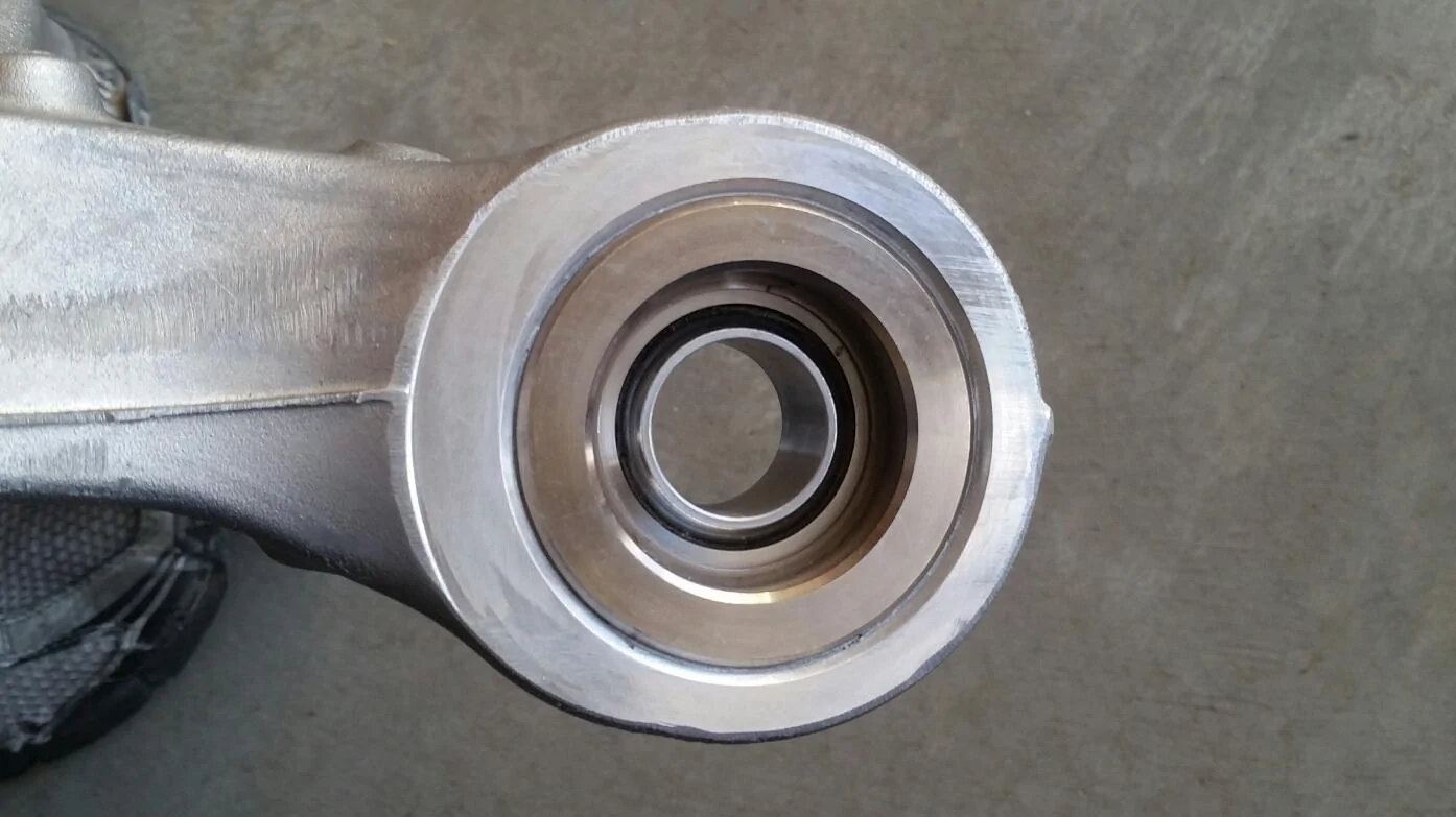

Rustang
Feb 2, 2016
296
102
O'Fallon, MO (STL)
Rustan
LB '17 GT Premium PP
I installed mine today but it will likely be a week or so before I get around to driving and able to give my impressions. I will say this, install is a pain, not difficult but tedious. I pressed mine out and in will a ball joint press rented from Autozone too, ugh. I used an impact on it though so it actually just pressed them right out and back in.
