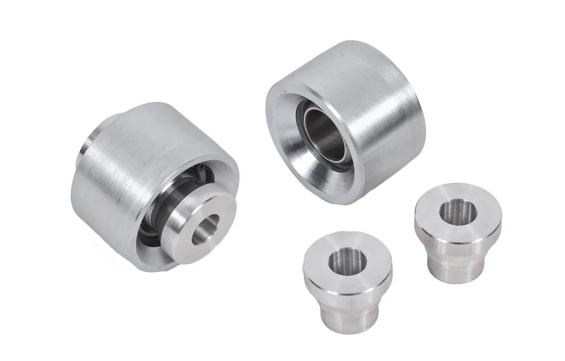

I've been looking at the BMR BK081 spherical bearing for my RLCA, Lethal puts it in their BMR suspension packages and Steeda has a very similar design to their RLCA bearing, but now I've learned that Superpro offers a polyurethane bushing for the RLCA, and at a cheaper cost.
Could anyone tell me if there would be a difference in NVH between the two? Any difference in actual performance under spirited and normal driving conditions?
I know I can't go wrong either way as long as I get rid of the OE rubber bushing, I just want to make the best decision.

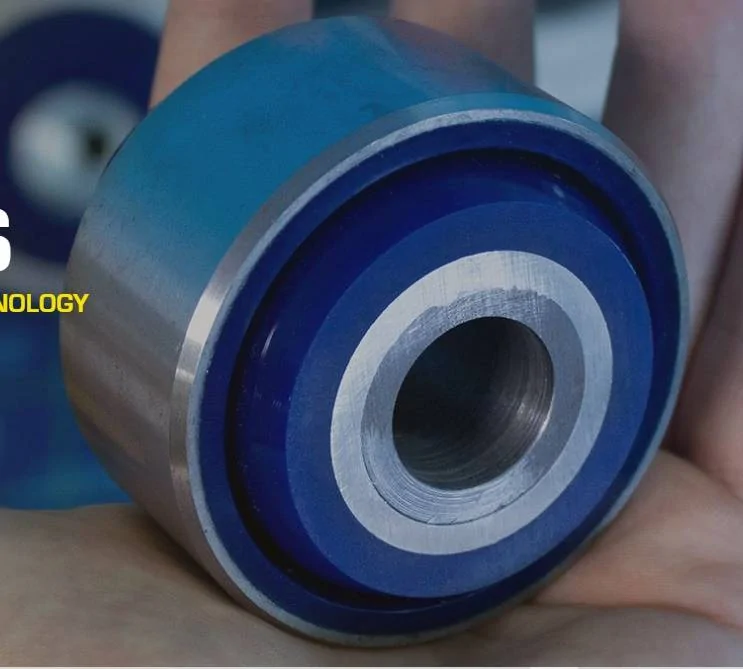

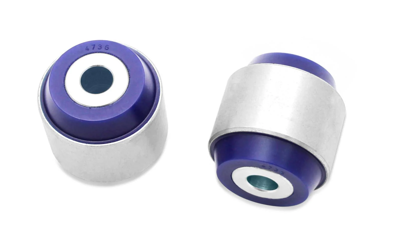

Normally I'd completely agree, though in this case it looks like they've designed it to take some off-axis rotation.
Could be, if they actually look more like this. Seems it's the Aussie companies that pay enough attention to what's really going on in a compliant bushing to sneak in some compliance.
Norm
They do indeed look that way.

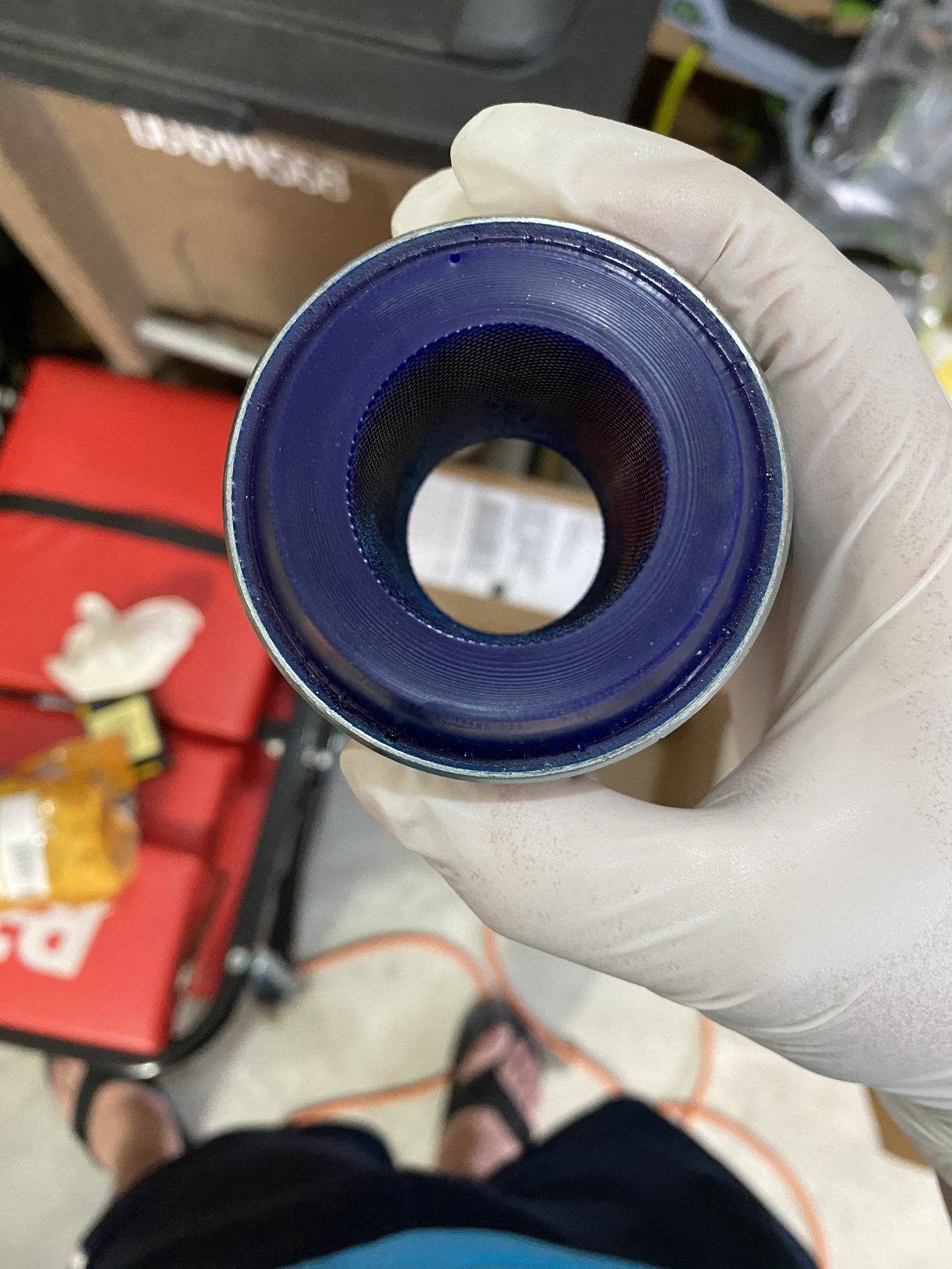

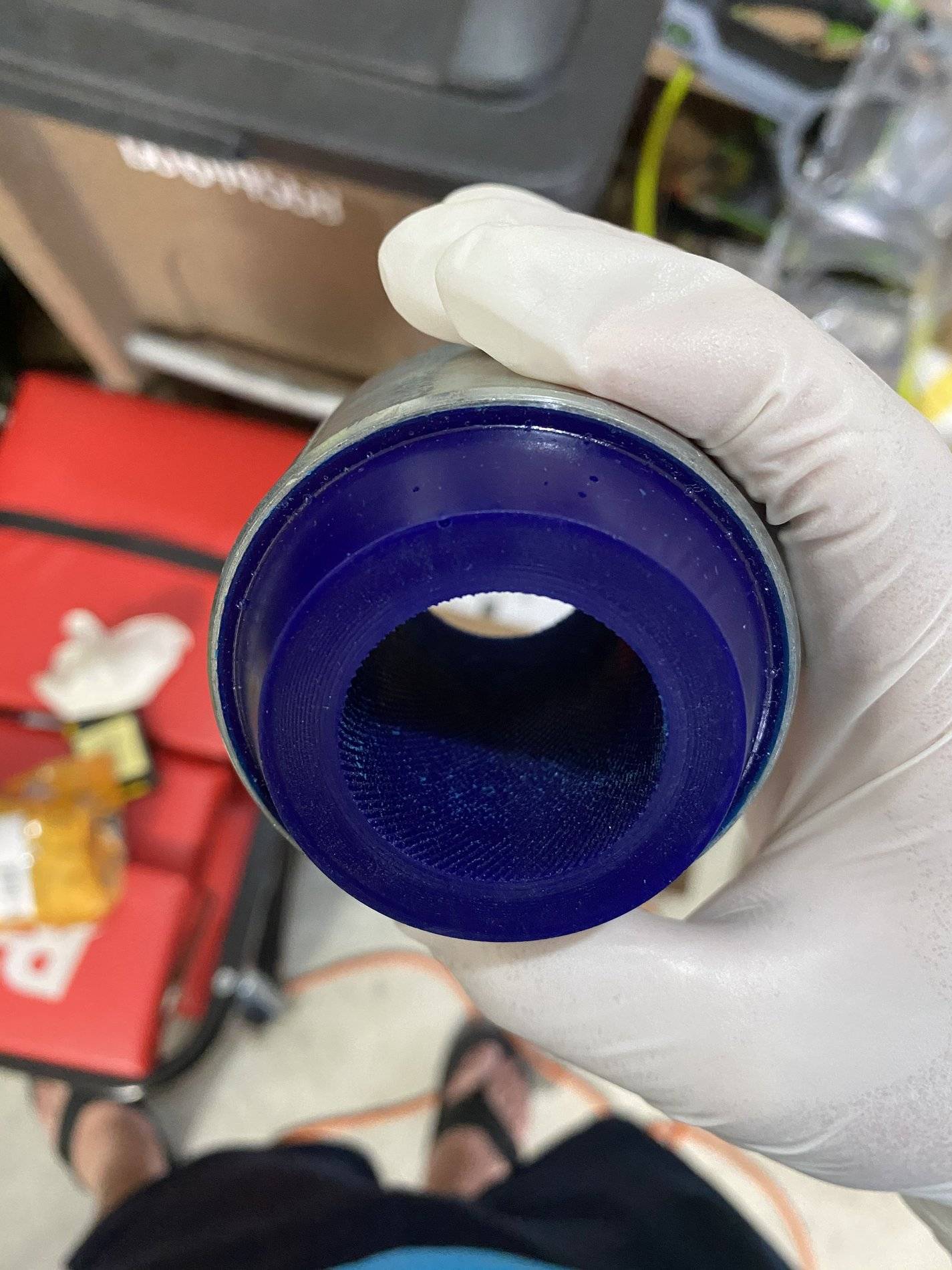

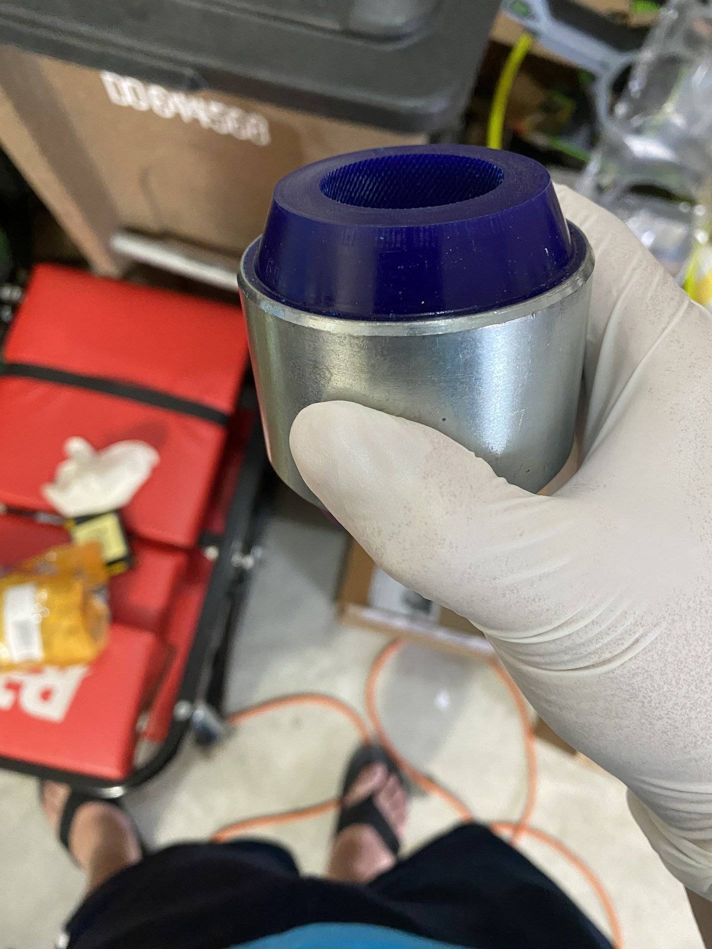

Want me to send you guys a clip of those super pro bushings? I have them setting in a box right now.
