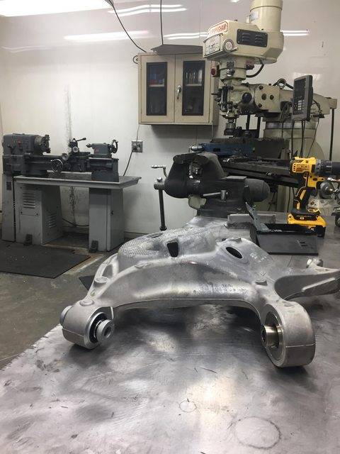

You are so close... you don't have to cut all the way through the shell. Make the cuts and then use a blunt flat head to hammer the edges of the shell near the cut in. Takes the pressure off and they should slide out easily

Thanks for the Pro Tip Grimreaper! I am going to call my buddy who has a machine shop at his house and see if I can run out and have him knock this out for me. I took it as far as I feel comfortable going myself. Time for the pro to go to work. I’ll provide an update once I get it handled.

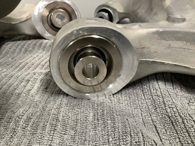

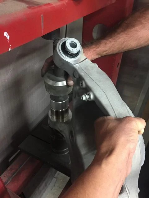

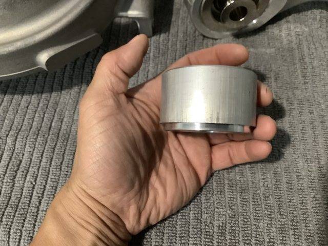

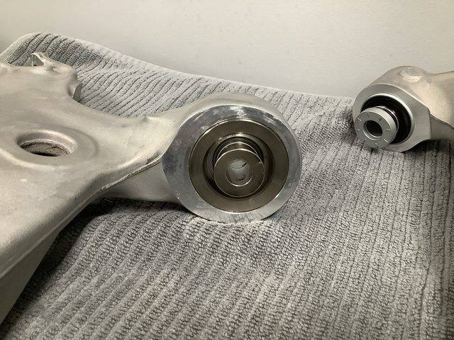

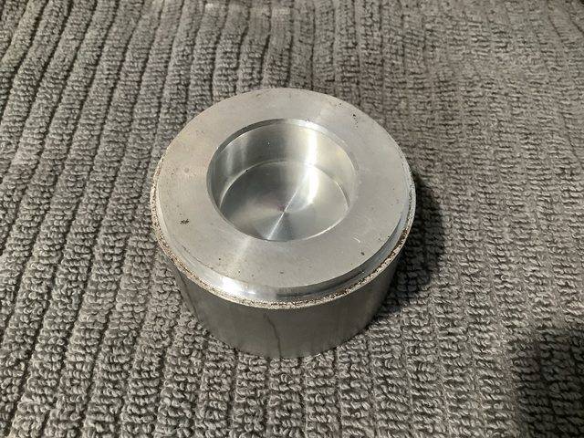

I took the control arms out to my buddy’s this morning and he was able to get me taken care of. I don’t know the size of his shop press, but it is at least a 20 ton for sure. His press ram was about twice the size of my 12 ton press ram. Pro Tip: He turned down the end of the Steeda press tool In his lathe (made a lip to seat inside of the control arm outer bushing sleeve) to keep it perfectly aligned while pressing the sleeve out. I wouldn’t say it was an easy task by any means. I had my fingers crossed the whole time hoping the job went perfectly and it did. He did have to use both hands to pump the jack on the press to get it done though. Man I’m glad that part is over with! Here are a few pics to show the finished product and modification to the Steeda tool.
Modified Steeda installation tool.

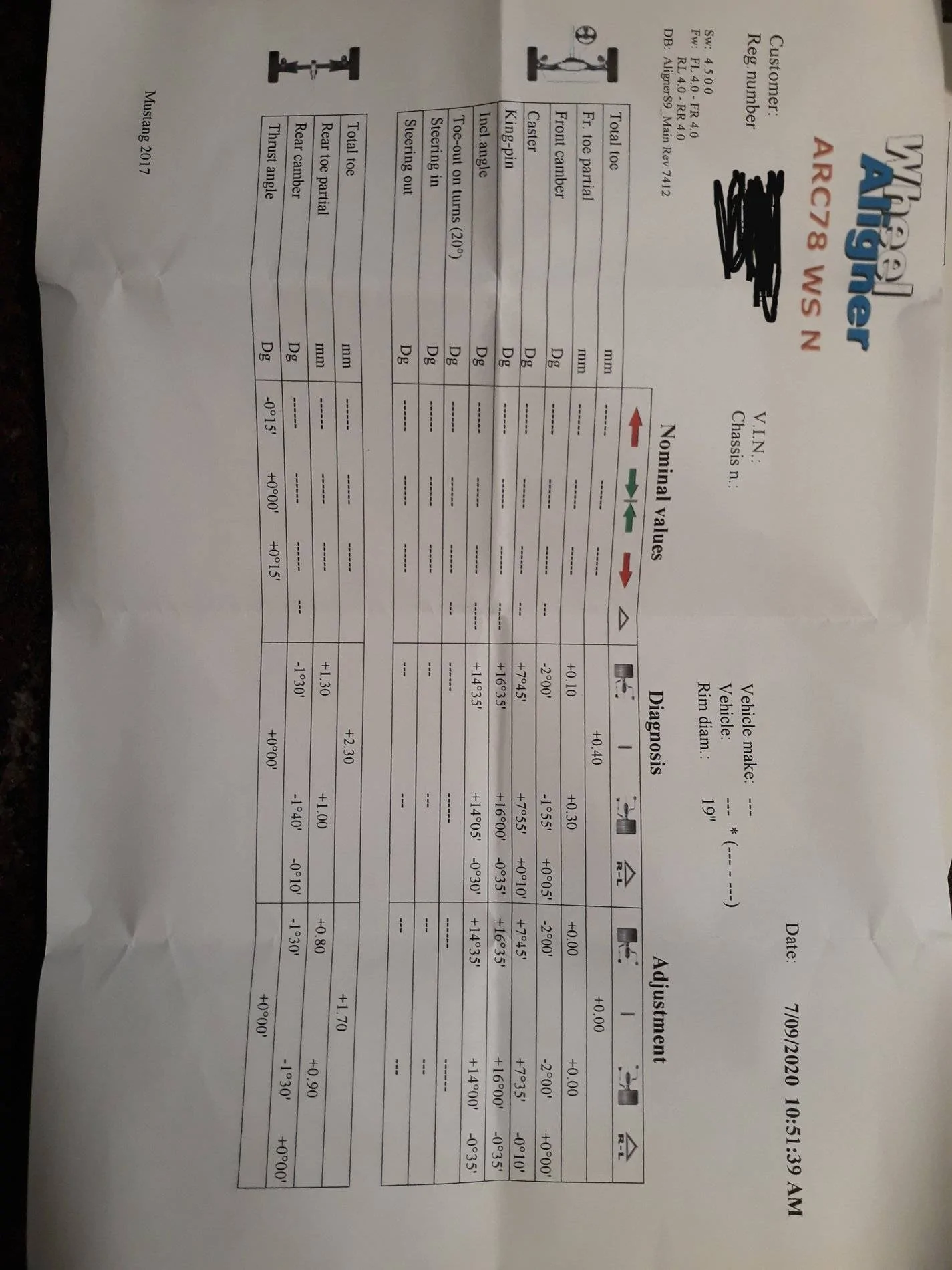

To answer your questions. When I did the install I only had a 200nm torque wrench. So I tightened the subframe and chassis side control arms as best as possible. And only witness marked with a paint pen the bolts that I actually got to spec. Then when I get the allignment completed on the hoist they would be completed then. Which happened to be yesterday.All done.
The Steeda rear camber adjusting brackets are only for ease of adjustment. They do NOT increase the range of camber available. With the BMR SP083R springs I have them adjusted as positive as possible. -1.5 degrees. Without the steeda kit, I wish you luck in adjusting the camber with any real accuracy or sanity left by the end. My alignment by a professional chassis tuner took approx 2.5hrs which included torqing 10 bolts and a 15 min test drive. $200 Aud.
