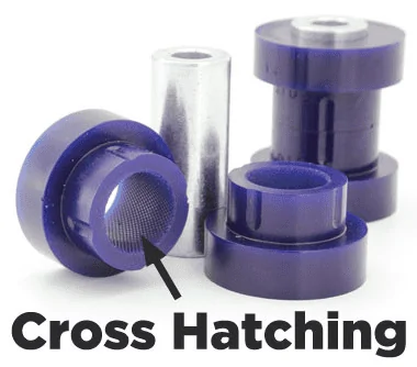

When we talk NVH. Poly is great....when it is great. lol. I realize these companies have these mesh interiors of their bushings as can be seen in earlier photos. That mesh design is meant to hold grease "forever" per say...and not require re-lubrication. Well, I am going to say this - that is smoke and mirror talk. What you will see is eventually there will be many people having to replace their worn poly bushings on their RLCAs...and you will also see people having to completely tear apart their suspensions to remove the inner sleeve and re-grease to rid of squeaky noises.

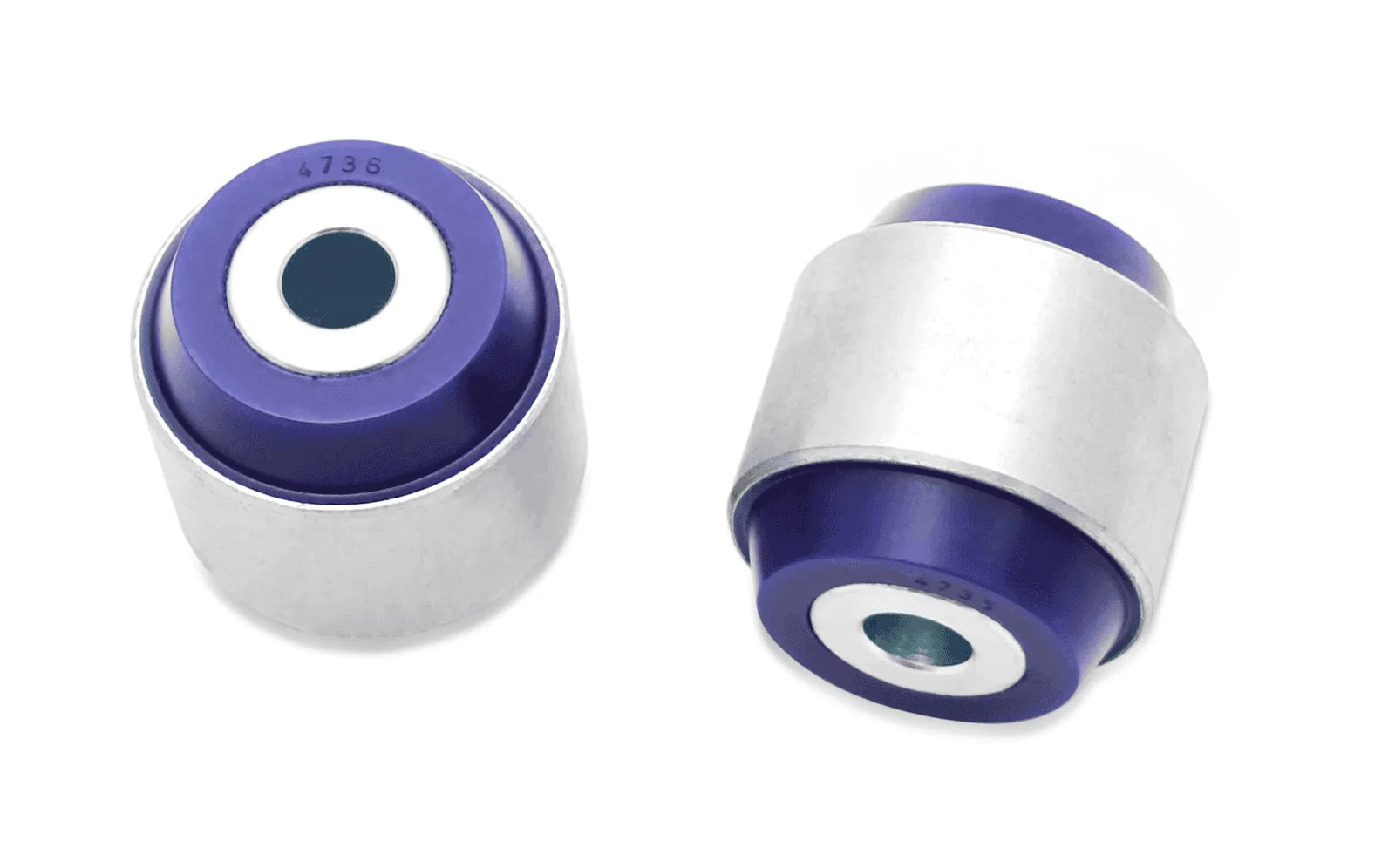

I may be missing something but the SuperPro bushing has a steel sleeve insert?

The mesh inside the sleeve (sometimes a groove) is meant to retain grease to avoid the squeaks and groans you usually get with poly bushings.
And it's better in some environments than other. I live in a dry part of the country, so it works well for me, because it never gets washed away. In particularly wet areas of the country, they will need to be pulled out and re-lubed every so often (yearly?)? Yes. At least for the time being, I can say that will be at something longer than 10k mile intervals. FWIW, I don't think Energy Suspension products are all that great, but they sell a good bushing grease for pennies.
They do but the traditional smooth bushings generally end up washing out for me. I've never tried one of the cross-hatch style or grooved solutions so I can't speak to them. I used to just live with the creaks and groans but now I'm old and things like that make me cranky so these kind of questions come up when I'm making plans.
