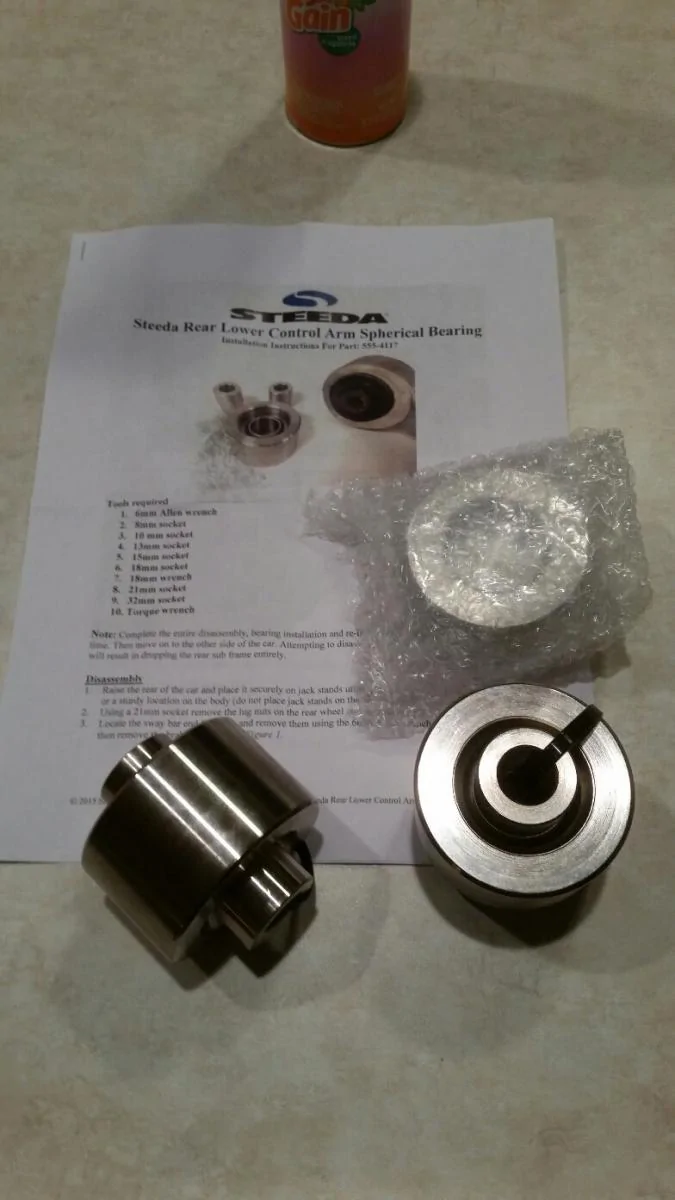

Got my set in the mail the other day, just need to carve out some time to put them in and enjoy. I have the red diff bushings in and do have very slight gear whine but I only hear it when accelerating, not present at speed.
