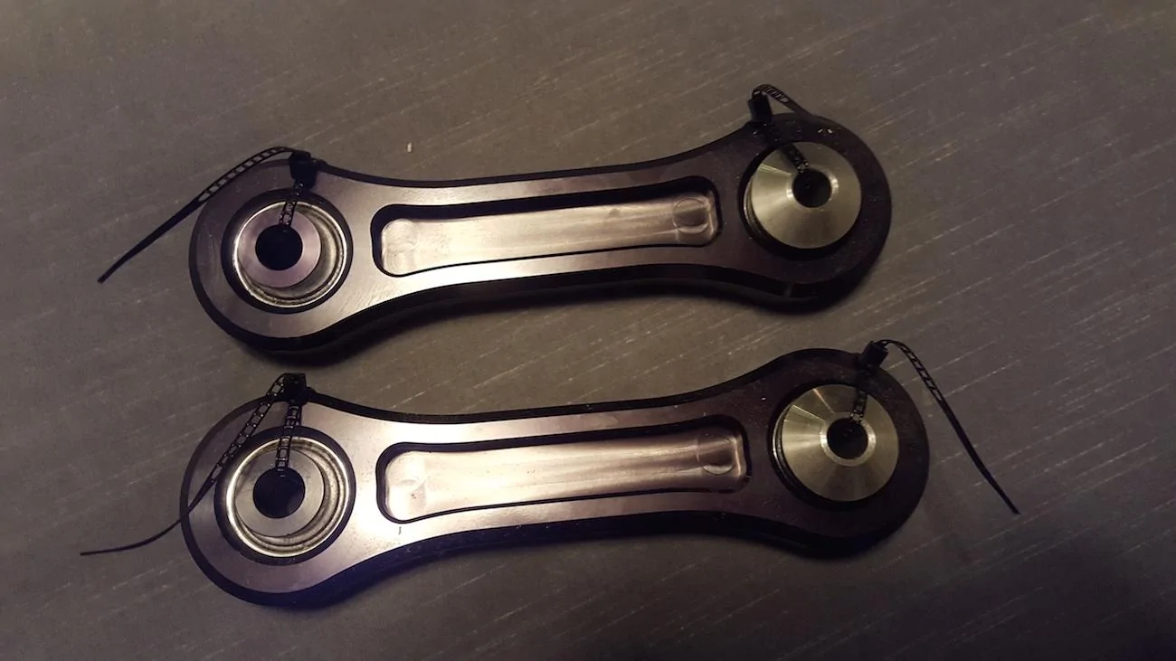

In the end I went with the option that seemed to be the "biggest bang for the buck" solution.

Here is an example of some installed on our rod-end components.
These have proven to work very well, and I recommend them quite often.
