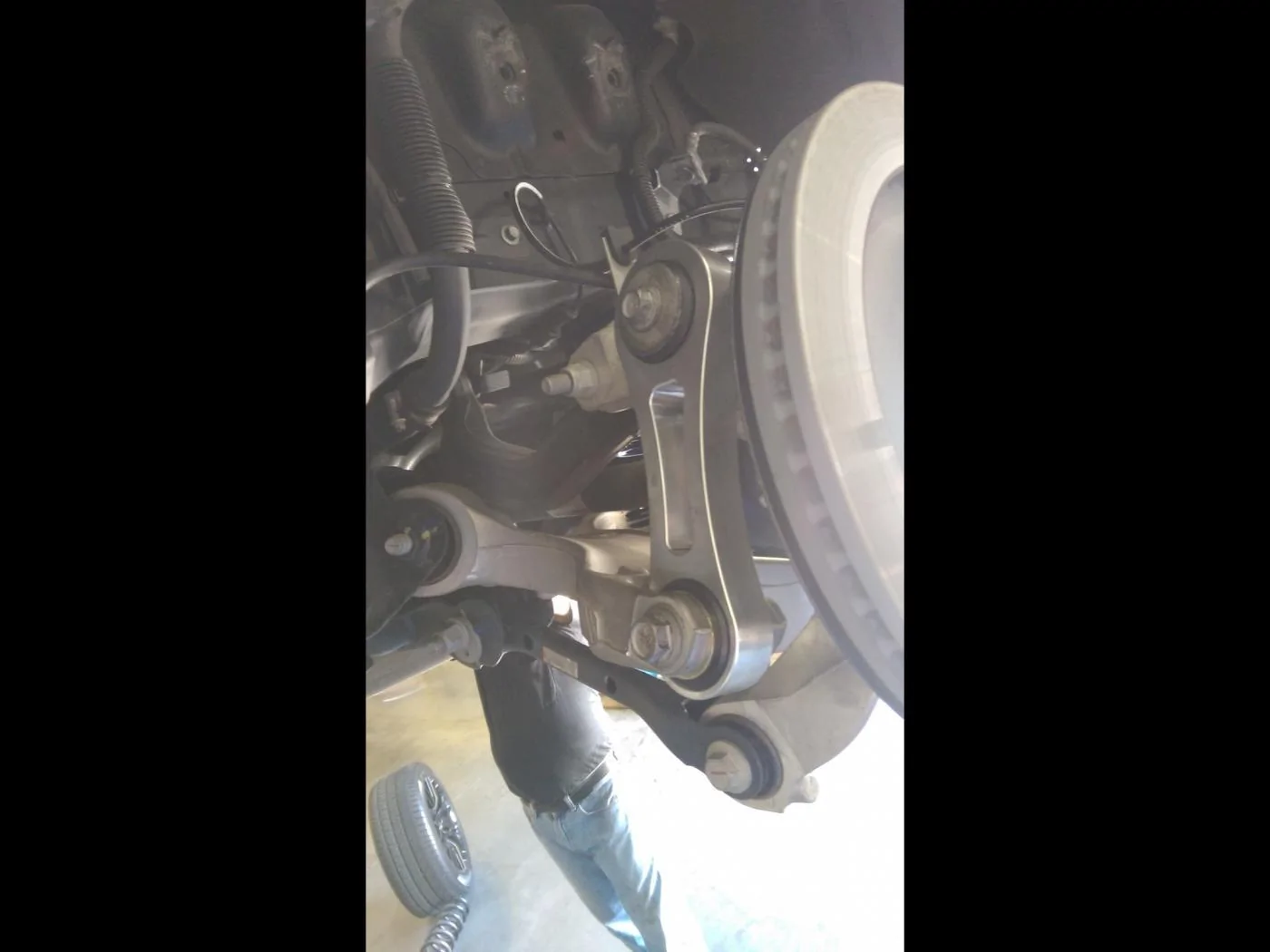

Here is a shot of our soon to be released Delrin versions. $159.95.
I will have some Delrin/Bearing shots in a few...and those are $149.95.

Good post David. I am sure you will join the club. ;)
These are the next change to my car. Very shortly coming to a thread near you [emoji11]
