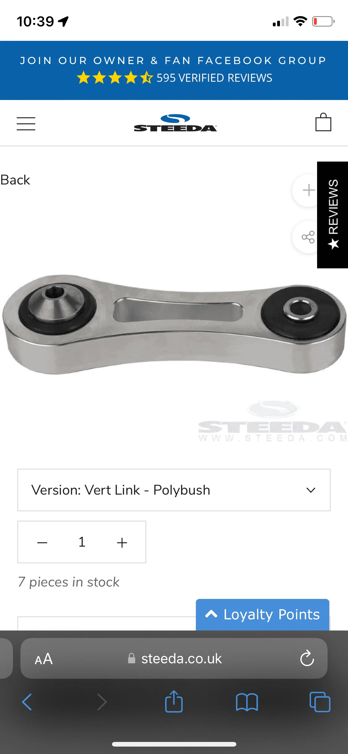

If I buy the Steeda links with the polly bushes :
Can the bushes be pressed out and replaced / refitted ?
I’m messing around with the idea of anodising a set - for looks and corrosion protection :like:

Yes, the bushings do come out of the vertical links very easily. No pressing or special tools are needed. I’ve had mine out once already to clean and apply fresh grease to the bushings.
Thank you :like:
Just to be clear, do you have the poly bushes or the delrin version ?

I have the delrin bushings, but the physical appearance is the same. I can’t imagine the assembly/disassembly being any different between the poly and delrin.

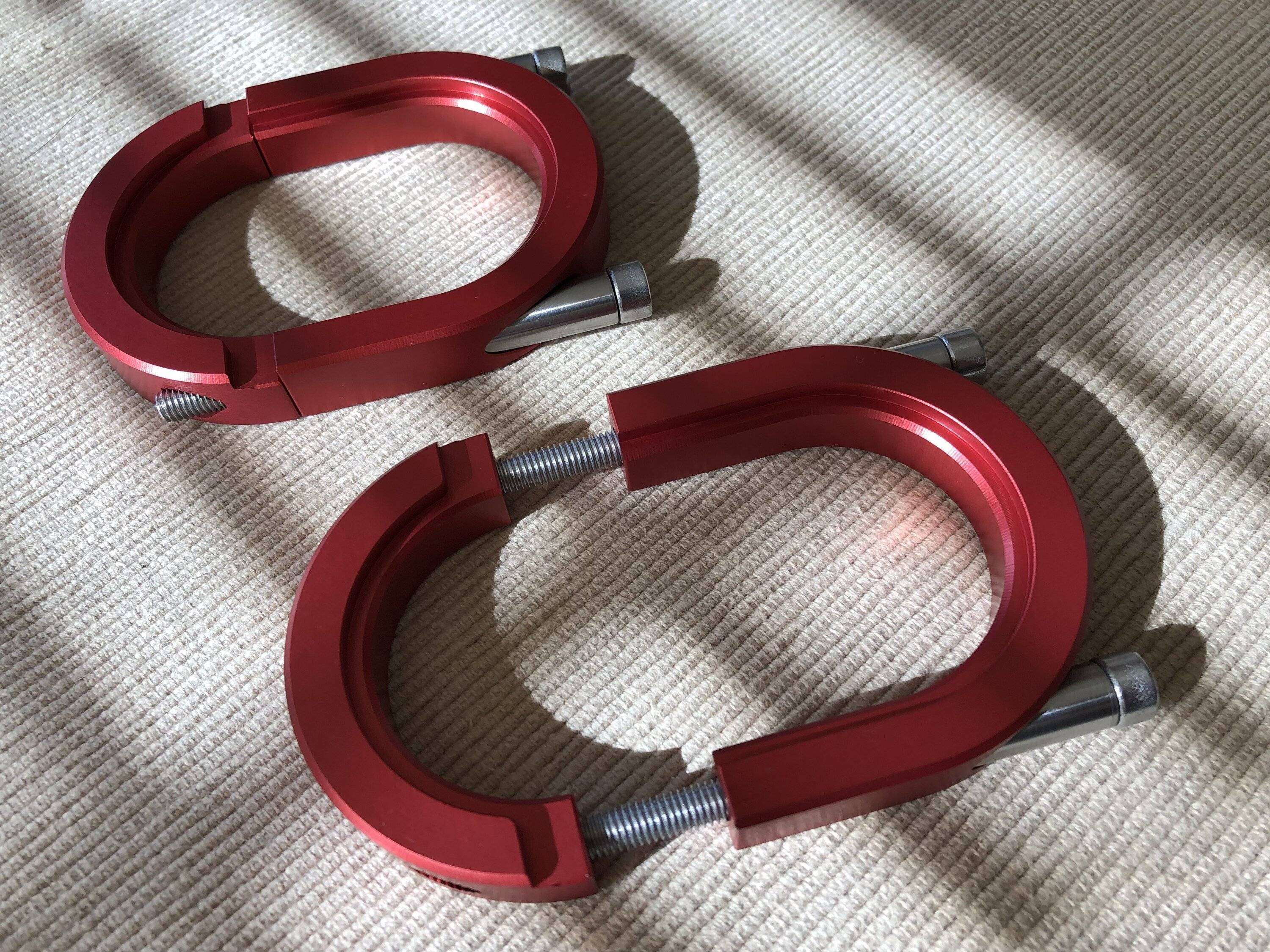

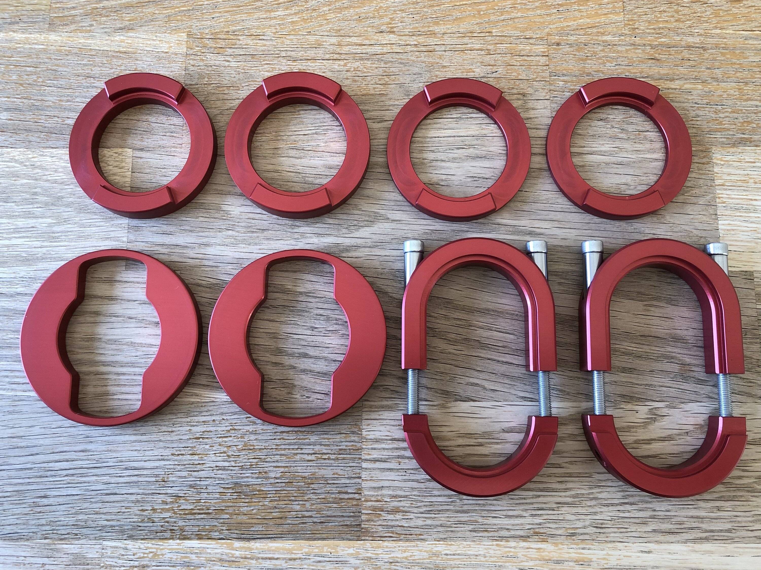

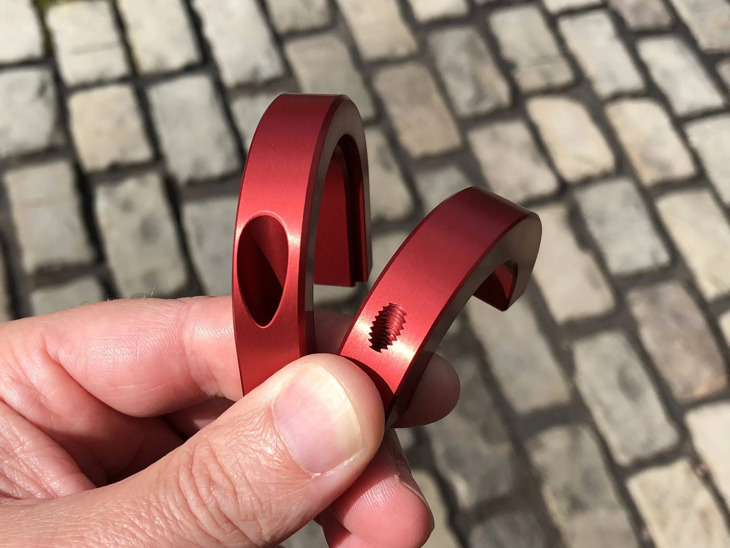

Just to follow up, subframe support bushes done :
Other parts on the radar, but I've not purchased them yet ... :like:
Those look to good to install! Please be sure and get some pics of rhe bottom of your car once you get everything coated and in place.
