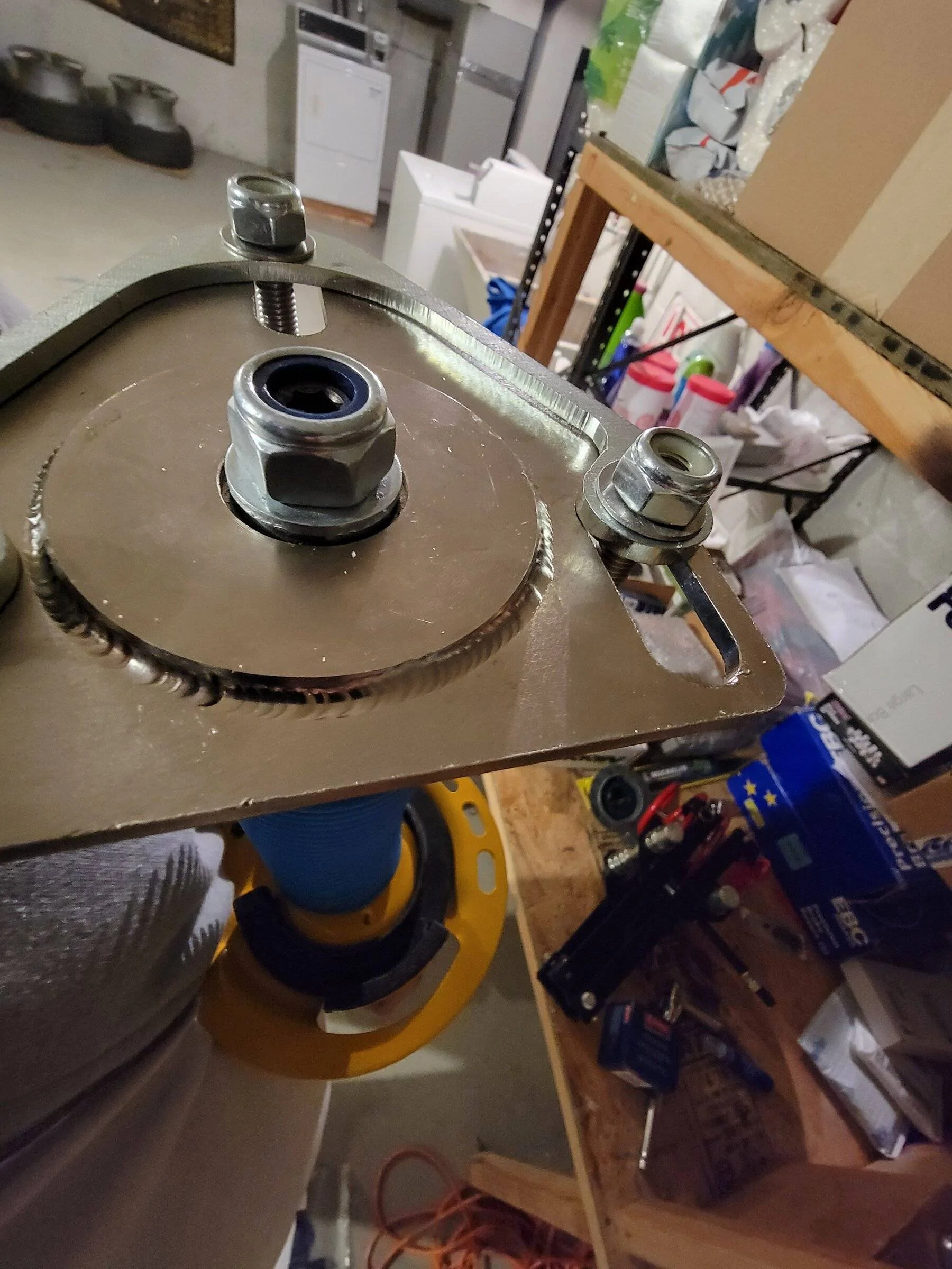

Hello all! Nice to talk to you guys. I'm a long-time reader/browser, first-time poster.
I have a 2019 GT non-PP and had been gathering a few suspension parts which I plan on getting around to in the near future. For now I was trying to assemble the front struts. I went with the Bilstein B6, BMR Handling springs, and Steeda camber plates, along with new upper and lower rubber isolators.

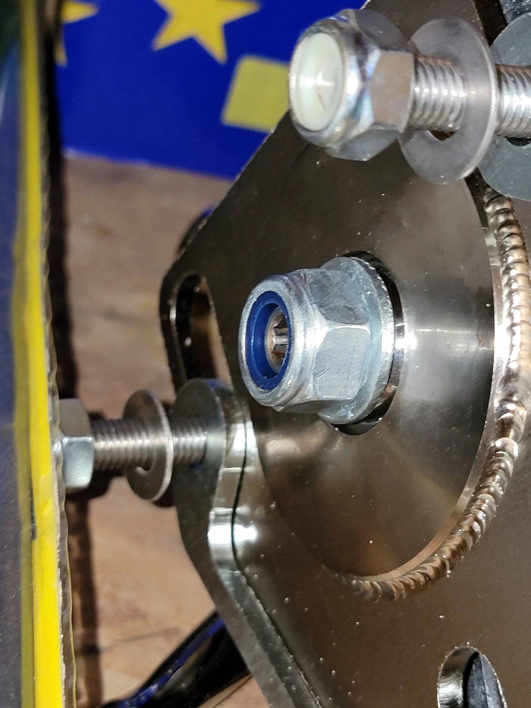

My problem is the strut nut is not sitting flush with the strut shaft. I just got off the phone with Bilstein and they advised to crank down the strut nut while holding the shaft with an allen key, which is what I'll do. However I had a message out to Steeda as well and they recommended not to use the washer that came with the Bilstein strut/nut. Does anyone here have experience with this install and if removing the washer was necessary? I saw a post someone made with photos but couldn't understand what the resolution was with regards to this washer ‐ would I be able to use it or do I have to remove it?
https://www.mustang6g.com/forums/th...ngs-struts-install-problems-questions.102163/
Below are some photos I had taken to show that the strut nut isn't sitting flush with the shaft, but assuming that's not an issue once the nut is cranked down, you can see the washer I'm referring to as well.

Is that nut actually bottomed out or did it just stop because it hit the nylock section? In order to work, the threads need to actually extend through the blue plastic section of the nylock nut otherwise you have no protection against the nut loosening up with strut rotation. If you can't get that otherwise, I'd remove the washer but try cinching down the nut while holding the shaft with a hex key first.

I just assembled my Bilsteins with the same Steeda plates and mine looked the same. I assembled them with the washer the Bilsteins came with first and they looked the same as yours so I removed the washer and the nut is now even with the top of the strut.
After I install them in the car I'm going to blue loctite the nut and torque it to spec.

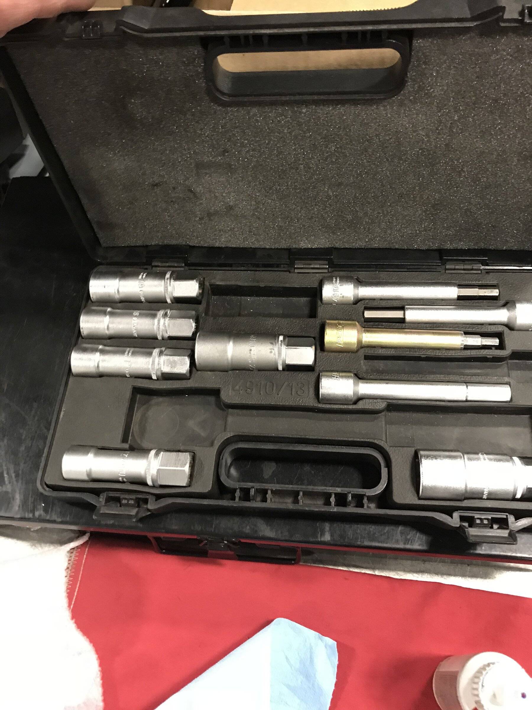

This is the correct tool needed to properly install Strut shaft mounting nuts.
Spinning the strut shaft is a sure way to tear up the internal piston seals.

Can’t recall off top of my head but there’s a spark plug socket size that fits that nut. Most spark plug sockets have a hex shape so you can put a wrench on them and slip and Allen key through the center of the socket to torque the nut.

@NeverSatisfied Yeah thanks! I ordered a crowfoot wrench that can be used with a torque wrench (and of course has an opening that can be used to access the hex slot). And thanks for the strut/spring feedback! I'm looking forward to it and very excited about it!

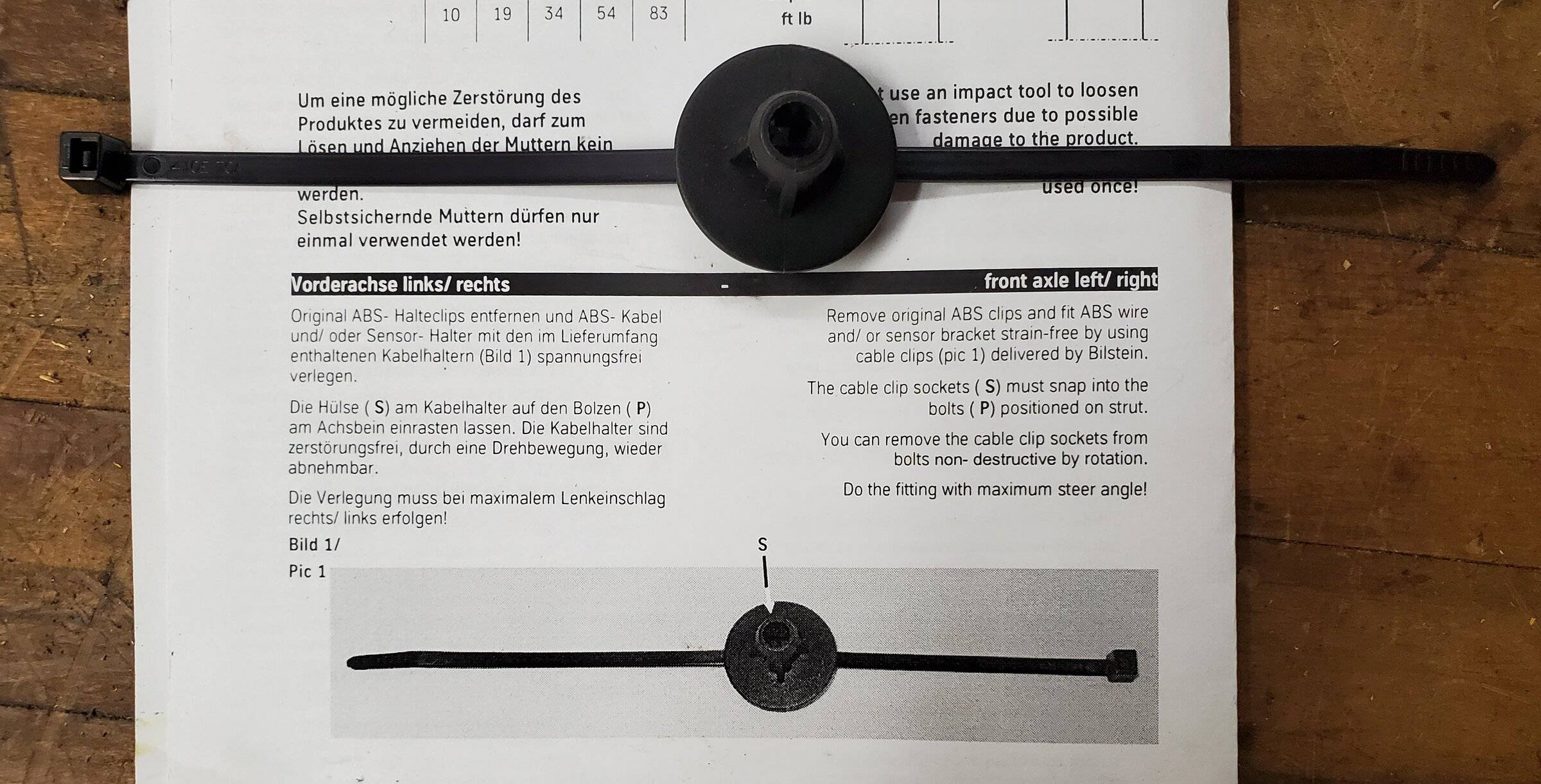

And lastly need to ziptie or find a solution to attach the wire that is originally attached to the factory strut (the factory strut has 2 openings for the wire to attach to, whereas the Bilsteins only have one of those openings) -- @Siege you may see this also when you install your struts
I'm in the middle of installing mine too! The Bilsteins came with a zip tie to replace the lower wire mount that pushes on to the threaded studs sticking out of the bottom of the strut.
Double check your box because mine were just loose in there.
Ohhh that makes sense! I saw the threaded studs you're talking about, but didn't understand what the purpose was. Okay I will double-check the boxes; I know mine were slightly damaged just from regular shipping so they must have just fell out into the "main box" -- thanks for telling me about it!

I had it sitting on the workbench so I grabbed a picture

I found it! Lol thanks @Siege ! Yeah unfortunately I only found one of them, so I just contacted Bilstein asking for a replacement.
But definitely wouldn't have even known about it had you not told me -- much appreciated man!
