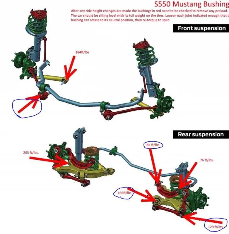

Brian@BMVK
Apr 27, 2020
951
973
Illinois
2015 GT - Sold
It wasn't. Guy who installed said I might not need it because of the minimal drop. I decided to watch tire wear, etc. and never got it aligned. Sounds like that wasn't a good idea. :) I didn't realize it could effect the ride.
Unfortunately, no. It does not take that much ride height change to throw it off significantly, and there's a good chance that the lockout alone did enough to necessitate one.
Definitely make an appointment to get the bushings clocked while on the rack, and then aligned after. The ones circled in blue are the ones to get (on both sides).
MidwayJ
MidwayJ
Sep 9, 2018
1,902
2,913
Dallas, Texas
Jay
2019 Mustang GT Coupe
Thanks for the info on the bushings. Between this and tire pressure it's good to know things can be done to make changes for the better.
