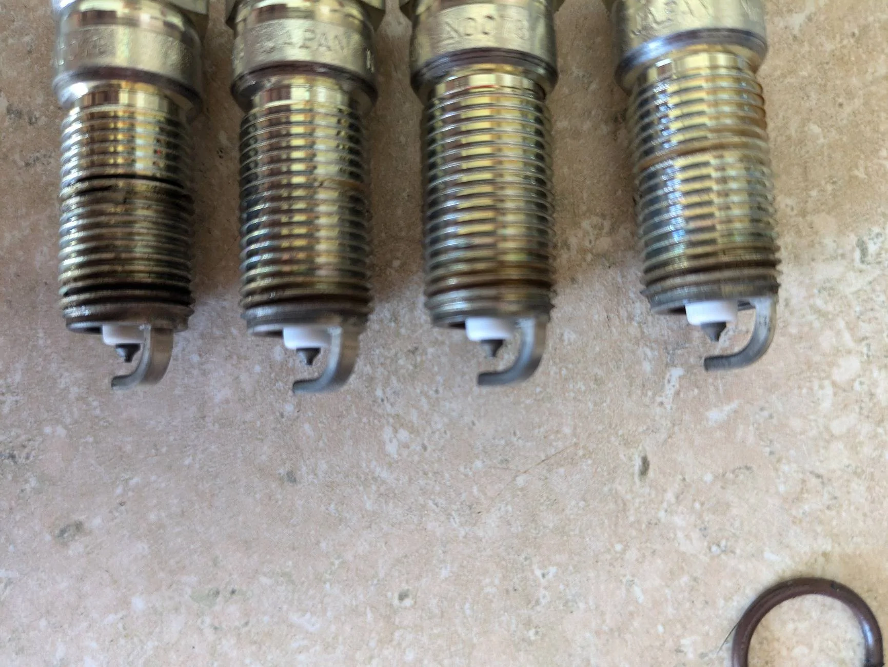

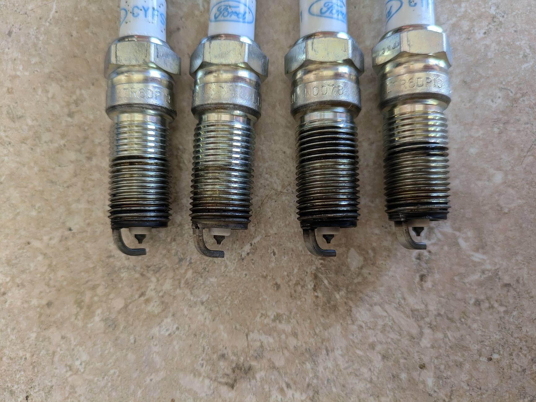

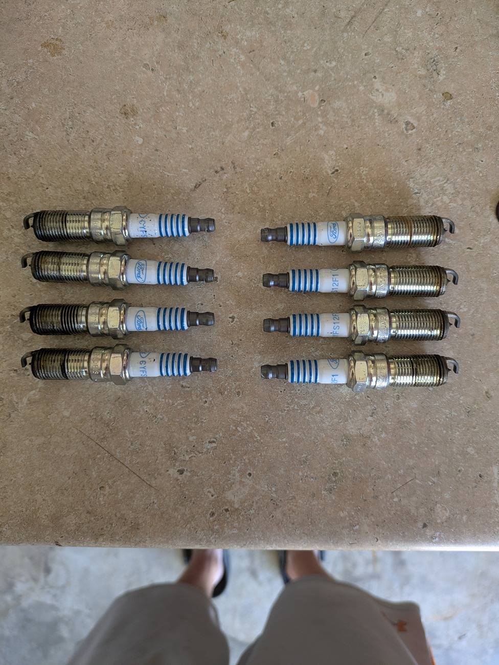

For a couple reasons, I decided to swap back to the iridium plugs this afternoon. When I pulled the platinums, the passenger side certainly didn't look like the drivers side.
So apart from the obvious valve cover leak, what are your thoughts/opinions on what I can learn looking at these plugs?
Passenger side left, front of engine is towards bottom of photo.
Passenger side, front of engine to the right.
Drivers side, front to the left.

The gaps are off other than that looks good
You're looking at the #4 plug (passenger side rear), right?
Long story with that one. I messed with it a bit, so yeah I agree.
What about the oil on the top of the threads on the passenger side bank?
Might not have been torqued properly. Hard to say but I wouldn't lose any sleep over it.
From the pictures, they look good to me from the side. Make sure you torque them IAW OEM specs. Clean, Install and Have fun.
