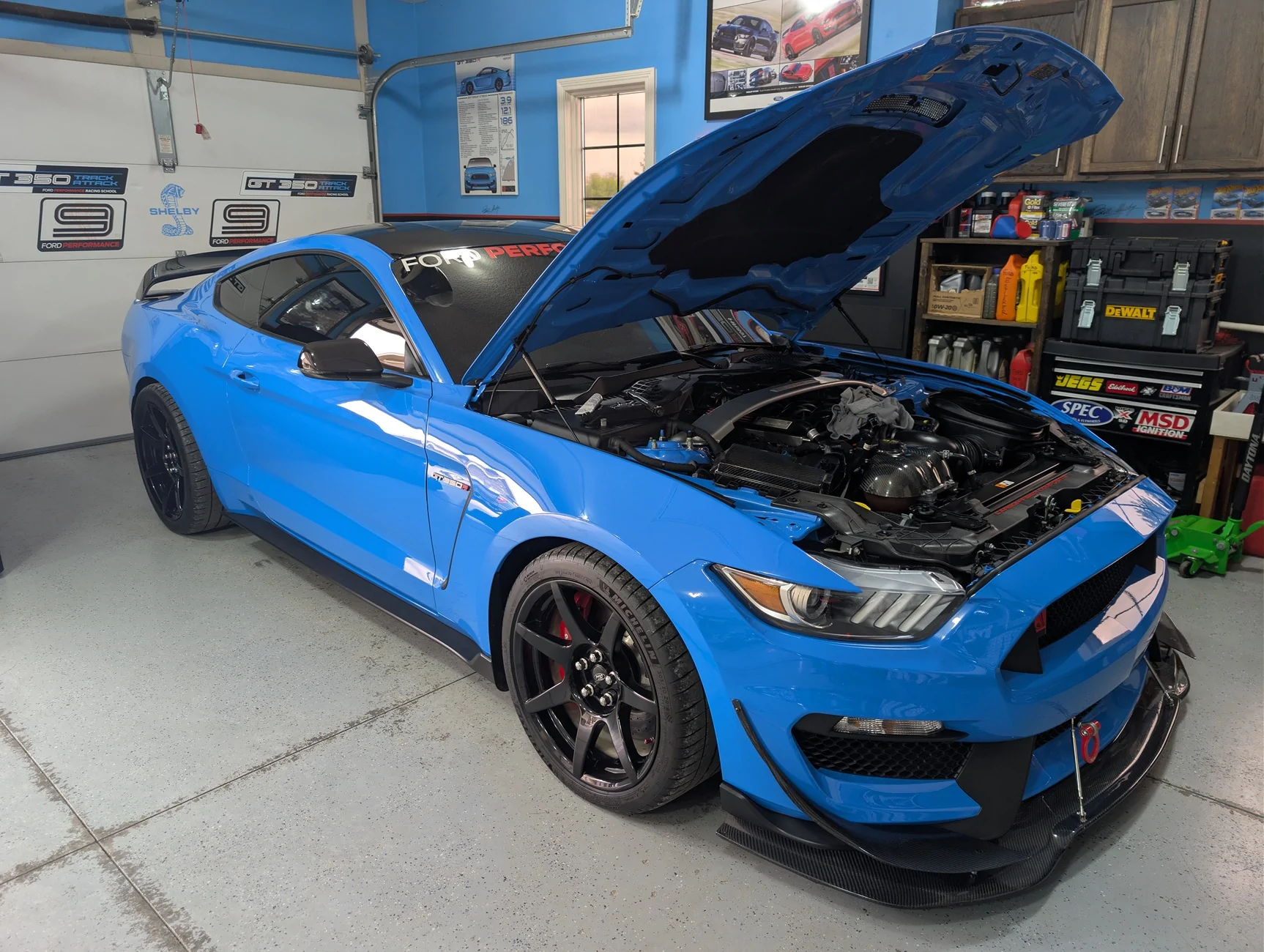

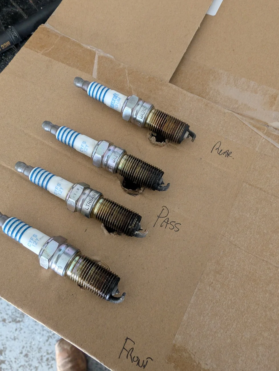

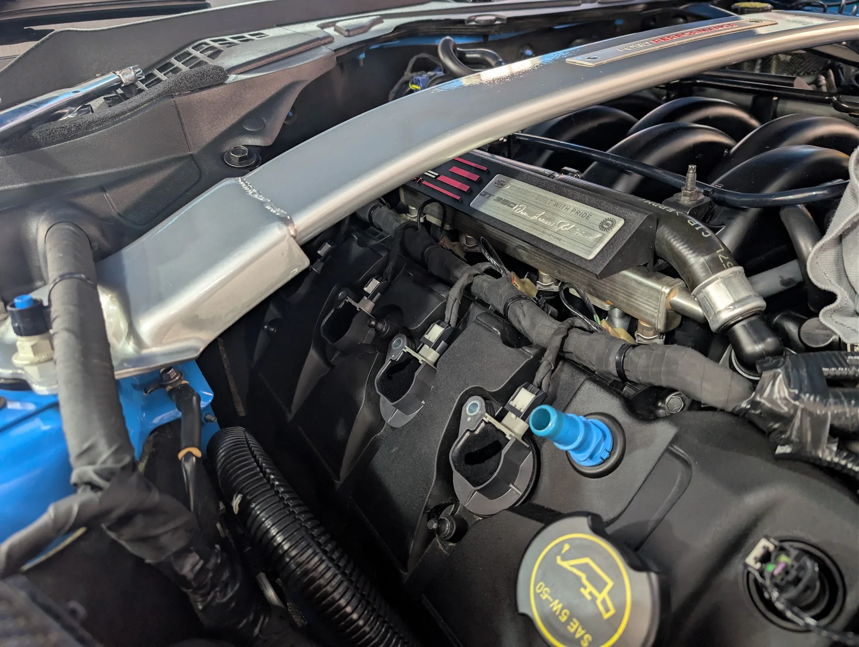

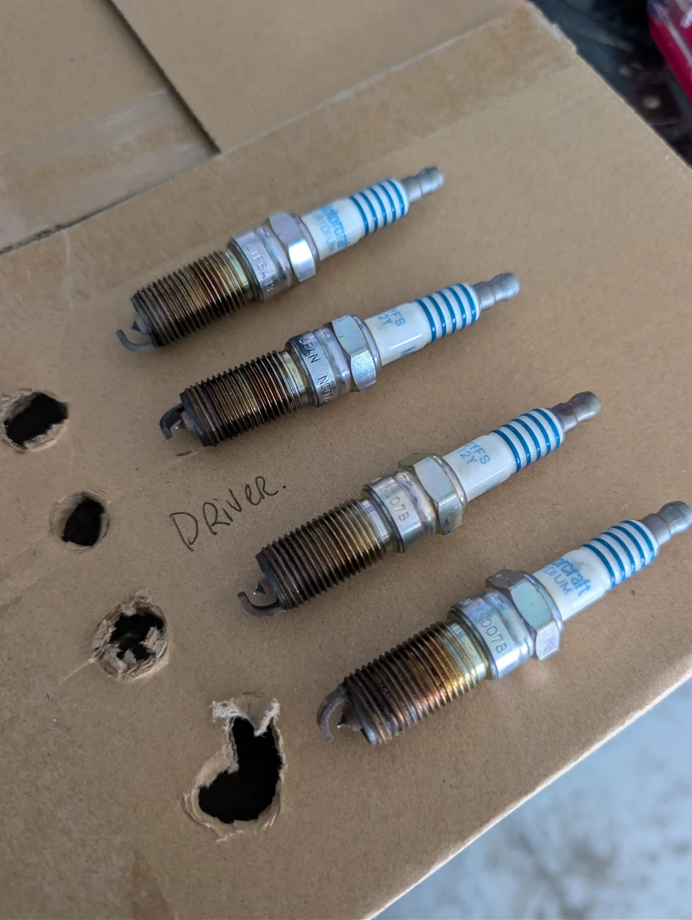

I have a 2017 Shelby GT350R GB with 22k miles. I've owned since 2020, it's been such a great car. I have changed all fluids over to Amsoil the week after purchasing, rear differential, trans fluid and engine oil. With that said, I enjoy maintaining my car, whether it's fluids, brakes and brake fluid etc. I figured I hadn't done plugs, something cheap and easy to change out.

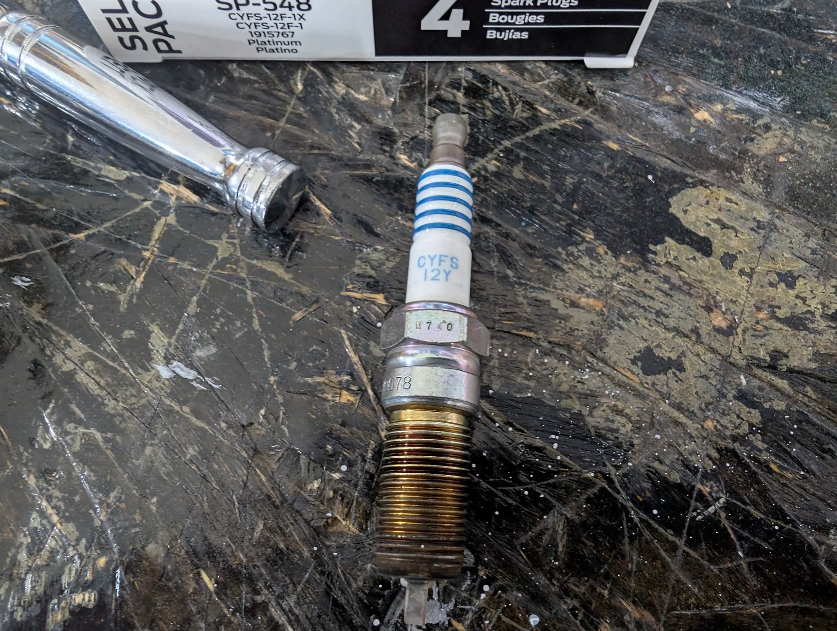

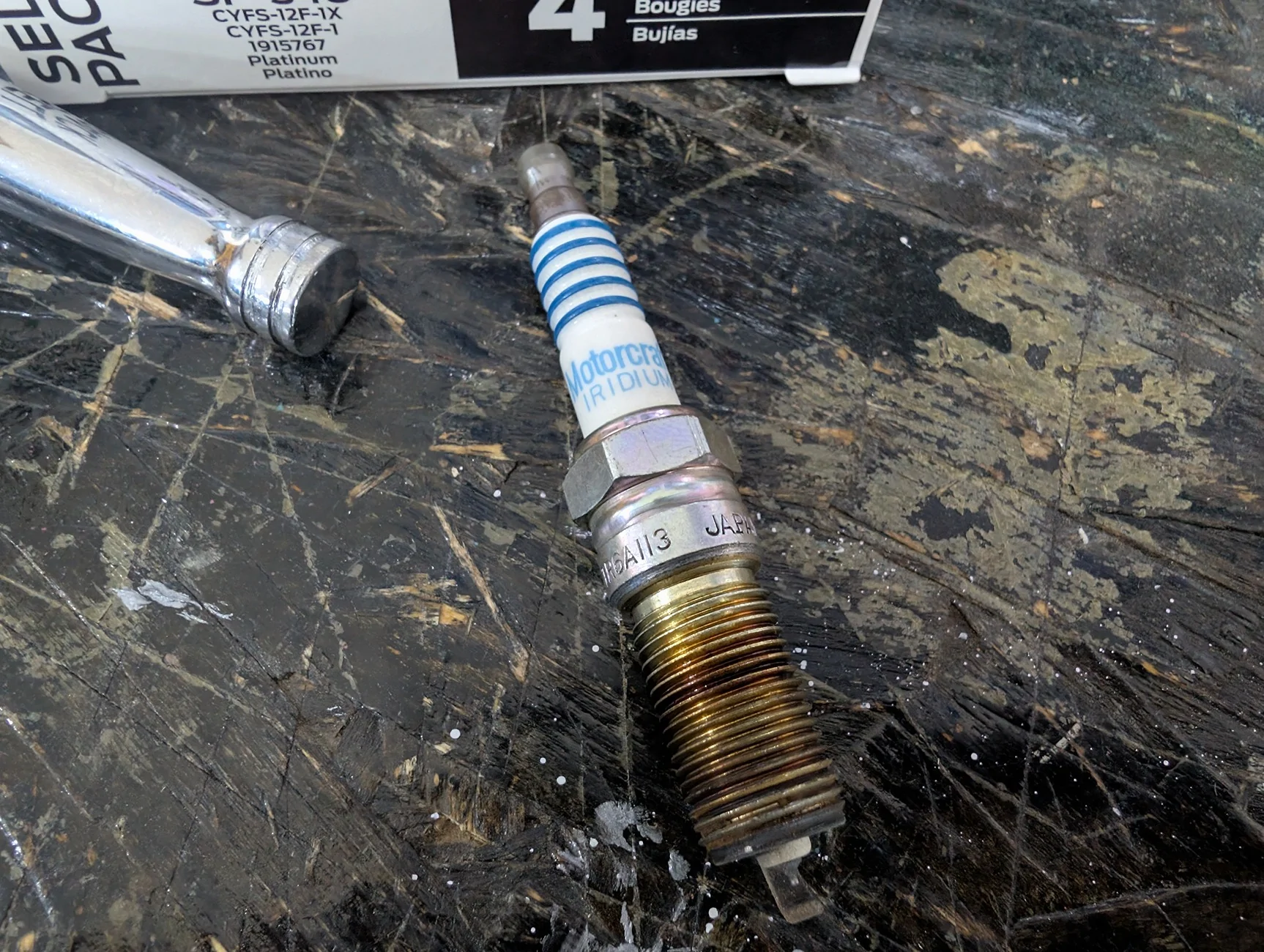

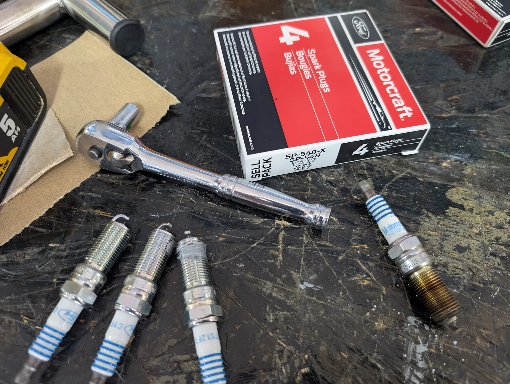

I removed the rear passenger plug first to find I have Iridiums CYFS12Y (not sure what SP #) but I'd imagine SP509 comparable.
I did some looking prior (didn't remove a plug first) and purchased some Ford Motorcraft Sp-548 Platinum plugs as most forums or posts referenced them. These plugs come around .052 gap out of the box. My Iridium plugs removed were around .054- .055 on gap. (.02 gap change from New)

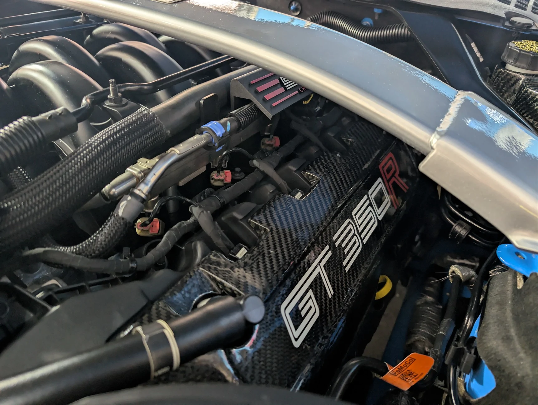

I contacted a few reputable Shelby mechanics and they assured me that the SP 548 platinums are good to go but to gap them around the tighter spec of .039. There was supposedly an update on the 19+ to have the gaps around .039 on a N/A car. So that's what I ended up doing, installing the SP548 plugs gapped at .039-.040 (as close as I could get). I installed and torqued down, 12-14 lb ft is recommended from what I've read and what's printed on the Ford Motorcraft box.
Pretty easy job and for around $50 for all 8 plugs, she will be good to go for another 9+ years or 22k miles.

Spark plugs are such cheap insurance - I always change em' much earlier than recommended as well.
On a side note, looks like cylinder #3 is burning a bit of oil - but doesnt look overly bad. how much oil are you going through every 1k miles?
I'd say about 1/2 quart per 4-5k miles. I've been pretty good at letting her warm until 170+ before going over 4k rpms. A trip to the tail with her was fun but did notice a drop on the dipstick when I returned. Holding those high RPMs in the mountains was alot of fun 2nd -3rd gears were definitely the sweet spot with very very minimal braking! Definitely a bucket list checked off 👍🏽
That's not bad at all. and I always noticed more oil burn whenever I had more engine braking - so spirited driving/track use makes sense. I gotta' drive the dragon some day!
