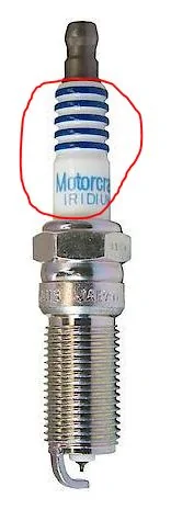

- I am going to apply dielectric grease to the tips. But I am not sure what tips mean, is it the entire section post the nut or just the very tip?

Dielectric grease goes on the ceramic section of the plug to keep the coil boot from sticking. Do not put it on the electrical contact on the tip. Dielectric = insulator.

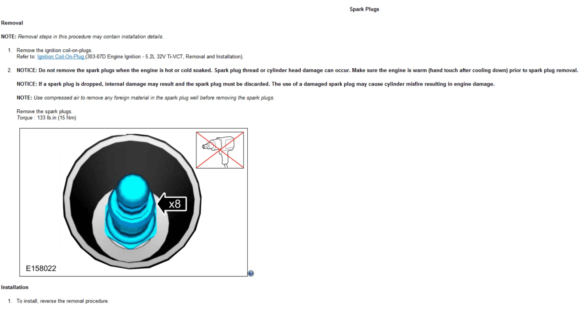

- These plugs have a torque rating of only 7-14 ft/lb. This is a very small amount already. So the way I would do this is I would take the middle of the values which is 10.5-11 and reduce 20% and go with 9 ft/lb if I used anti seize?

- The dielectric grease is to be applied on the entire surface area of the metal tip that is above the blue/white line area, correct?
No
Only the ceramic portion, and maybe the top of the main nut. Basically, you want a thin layer of grease on everything the rubber boot touches.
Dielectric grease is non-conductive. Coating the electrical contact on top just means your coils will have a harder time driving the plug.

I would definitely coat the electrical contact on top with dielectric grease. The grease keeps moisture and corrosion away from the electrical contacts. The contacts have built in interference and they scrub against each other to make a good connection when they are plugged together. This easily wipes through the grease, but the grease should still be there to protect from contamination.
I have a pickup with a Western plow and the directions say to coat all the contacts in dielectric grease prior to assembling them together. Those connections get more moisture, but really it's the same thing.

I have always always used anti seize on plugs. I was always taught nickel or aluminum anti seize is a matter of temp exposure in the application. You’ll be juuusssttt fine with the aluminum. I agree with @Hack ’s comments on the dielectric also. No fear in getting the tip coated.
