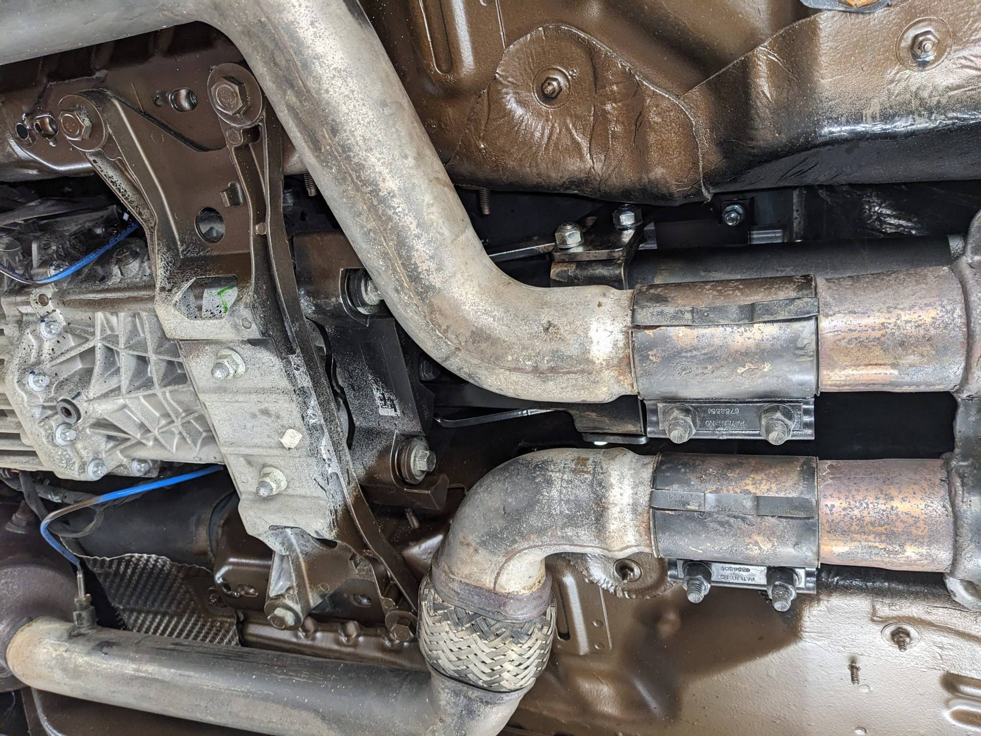

At the moment, I am experimenting with the new simplified black bracket from Blowfish (mustang-madness on eBay).
Currently, I have the problem that I can hear violent vibrations from the transmission tunnel when thrusting (at least) in 2nd and 3rd gear from ~5,000 to ~2,500 rpm.
If I'm unlucky, my MT82 is one of the approximately 10% (statement Blowfish) that have to deal with such NVH that you only can't hear with the factory mounting.
I am in the process of getting to the bottom of this.
My impression is that the bracket itself vibrates.
As a first step I will remove the NVH damper (short screws from pre 2018 already sourced).
Either that is part of the problem, or the 3 mm clearance was not enough.
If that doesn't change anything, I will weld in the stiffeners as it was on the old blue bracket for pre 2018 (still NVH damper removed).
After that, the only thing left to do is to change the top mount to something damped (was different on the blue bracket) or try the part from FTBR.
Last option is a gearbox mounted shifter with shorter throw (I do not really want that).
One thing is certain, I want the precision you get when the shifter is no longer attached to the transmission tunnel.
It's a night and day difference with the Blowfish bracket!
